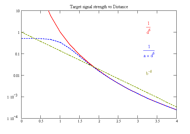

        Re: IB Receive signal level vs distance
        Harry
        The strength of a dipole field falls off as the cube of the distance. So for large distances the target current would fall off as the cube of the distance from the coil to the target. And the signal from the target would also fall off at the cube of the distance from the target. So the net effect is that the target signal received by the detector falls off as the sixth power of the distance between the coil and target. But this only holds when the distance to the target is large. It is not true when the target is near the coil.
        The graph above shows three curves. The distance axis is not in any particular units. This scale would depend on the sizes of the coil and the target. The signal strength is plotted on a log scale.
        The red curve is 1/d^6. This curve goes to infinity as the target approaches the coil. Since the coil does not vaporize when we touch it to a coin we can be pretty sure that this is not what the signal does as the target gets real close.
        The blue curve is 1/(a + d^6). I think this is probably the best description of what the signal does. "a" would depend on the size of the coils and the size of the target. I do not know how to calculate "a" but it would increase when the coil size increases and would decrease when the target size increases. At large distances this curve matches the red curve.
        The brown curve is b^-d. This is what I use for estimating signal strength. It is not very accurate but it is easier to calculate in your head. For a 9 to 10 inch coil and coin sized targets, "b" works out to be about 2 when "d" is measured in inches. So for each additional inch of distance the signal strength falls of by about a factor of 2. "b" would have a different value for different sized coils or targets.
        Robert

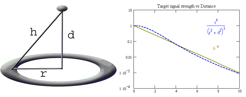

          I have a better function for signal vs distance. In the figure above "d" is the distance from the target to the center of the coil, "r" is the radius of the coil winding, and "h" is the distance from the target to the coil winding. If I assume that the signal is proportional to 1/(h^6) and then substitute (r^2 + d^2) for h^2 we get 1/(r^2 + d^2)^3.
          Of course real IB coils do not have a single r, there are separate transmit and receive r's and even those are not simple. But if I estimate my BM950 as having winding diameters of 4.5 and 8.5 inches and split the difference and call it an average of 6.5 which gives an r of 3.25, I get the blue curve above. The distance axis is now in inches. The r^6 in the numerator is just to normalize it so the value will be 1 at d=0. The other curve is the approximation I usually use, 2^-d.
          The nice thing about this formula is that it does not have any completely made up constants.
          To be more complete you would also have to take into account the radius of the target.
