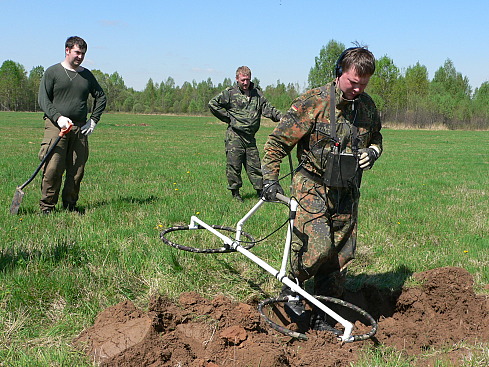

        low freq EMF goes deepper. I am not a physicist to tell you why&what is going on but probably ground influence is low in this case. this is why Dmitry deemon did choice 2kHz for his 2-box md. no 'you want' here. experiment.
          A 2-box can operate at any frequency you want.
          That means you can make a wideband (pulse induction) metal detector with orthogonal loop configuration. I tested this with Superscan - operates great!
            what topic killer did mean asking question? PI of VLF IB principle? we do not know this. pi 'velosiped' configuration was been many times discussed. velosiped is NOT ORTHOGONAL but PLANAR configuration.
