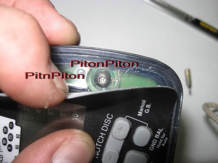

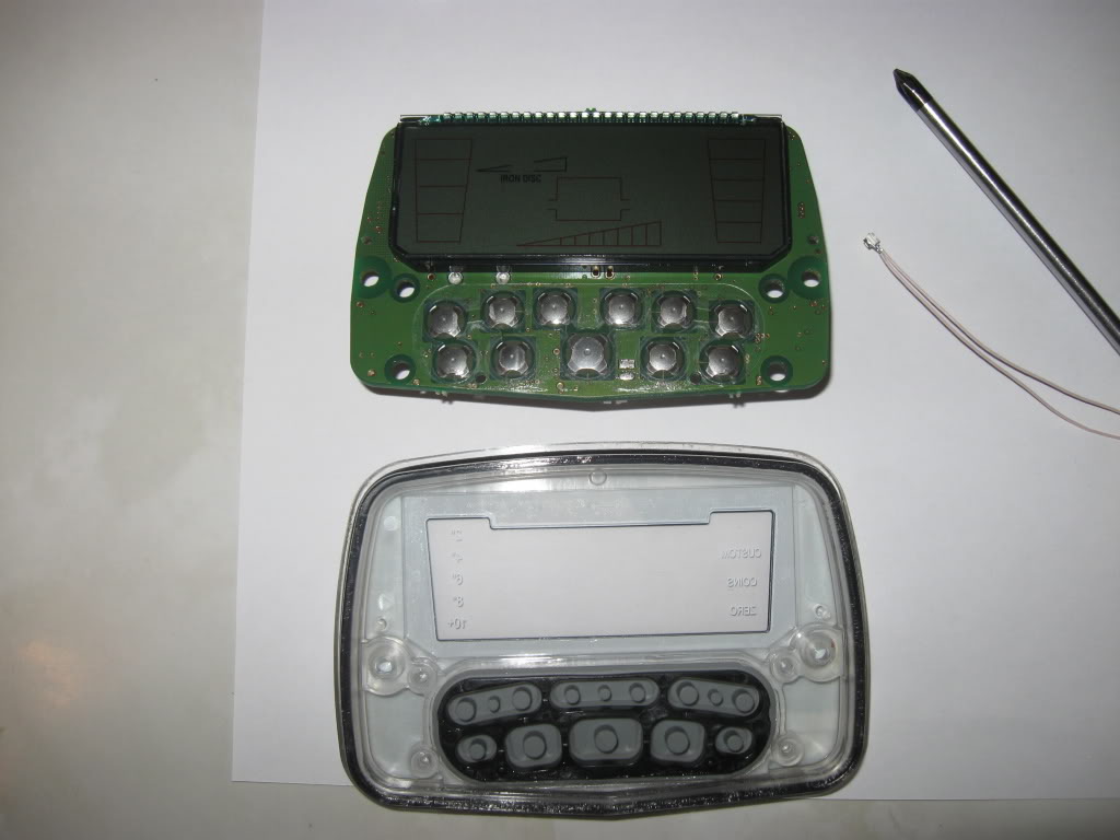

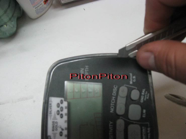

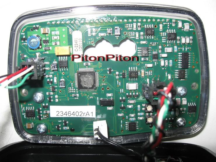

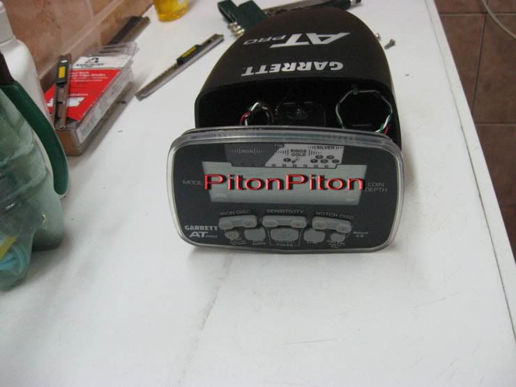

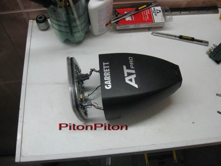

Garrett AT Gold .. anyone know how to disassemble it?

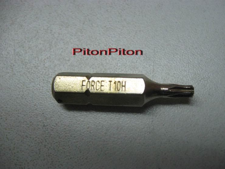

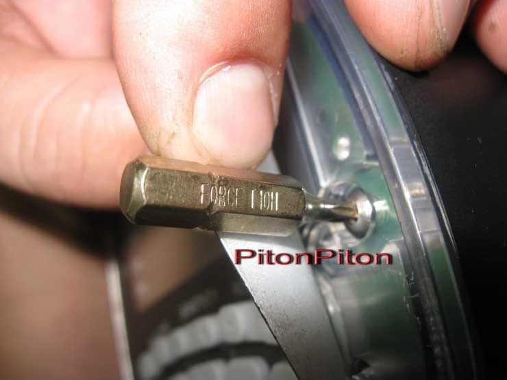

There are 2 screws through the faceplate. You can either peel off the face label to get to them and replace the label with a new one; or you can feel the location of the screws and cleanly cut holes through the face label.
