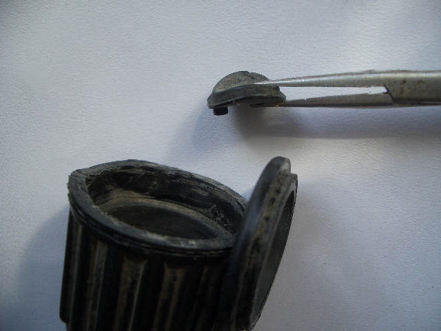

How do you remove the s-handle couplers?
  • How do you remove the s-handle couplers?
    I want to use this Garrett coupler on another s-handle.
    Just don't know how to remove it.
    Is there a simple way?
    Sven, it is of Minelab thinking is similar.

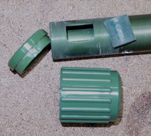

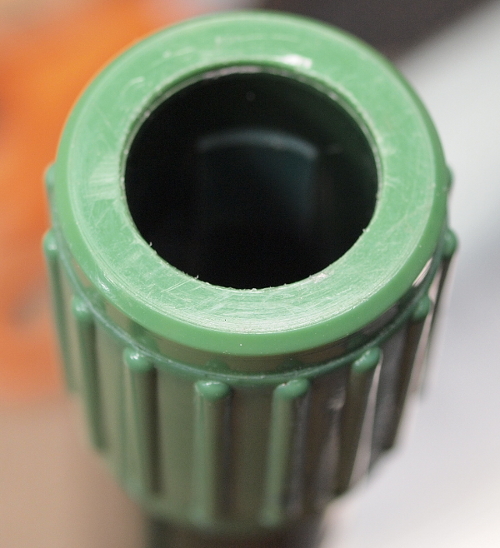

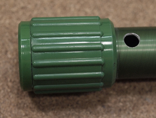

      That was easy.
      Just had to be a bit careful prying the cap off as there was some adhesive holding the cap snug.
        my problem was to glue a coupler cover back. material is specific plastic and not glued by a PVC glue and dichloroethan. finally I used an epoxy.
