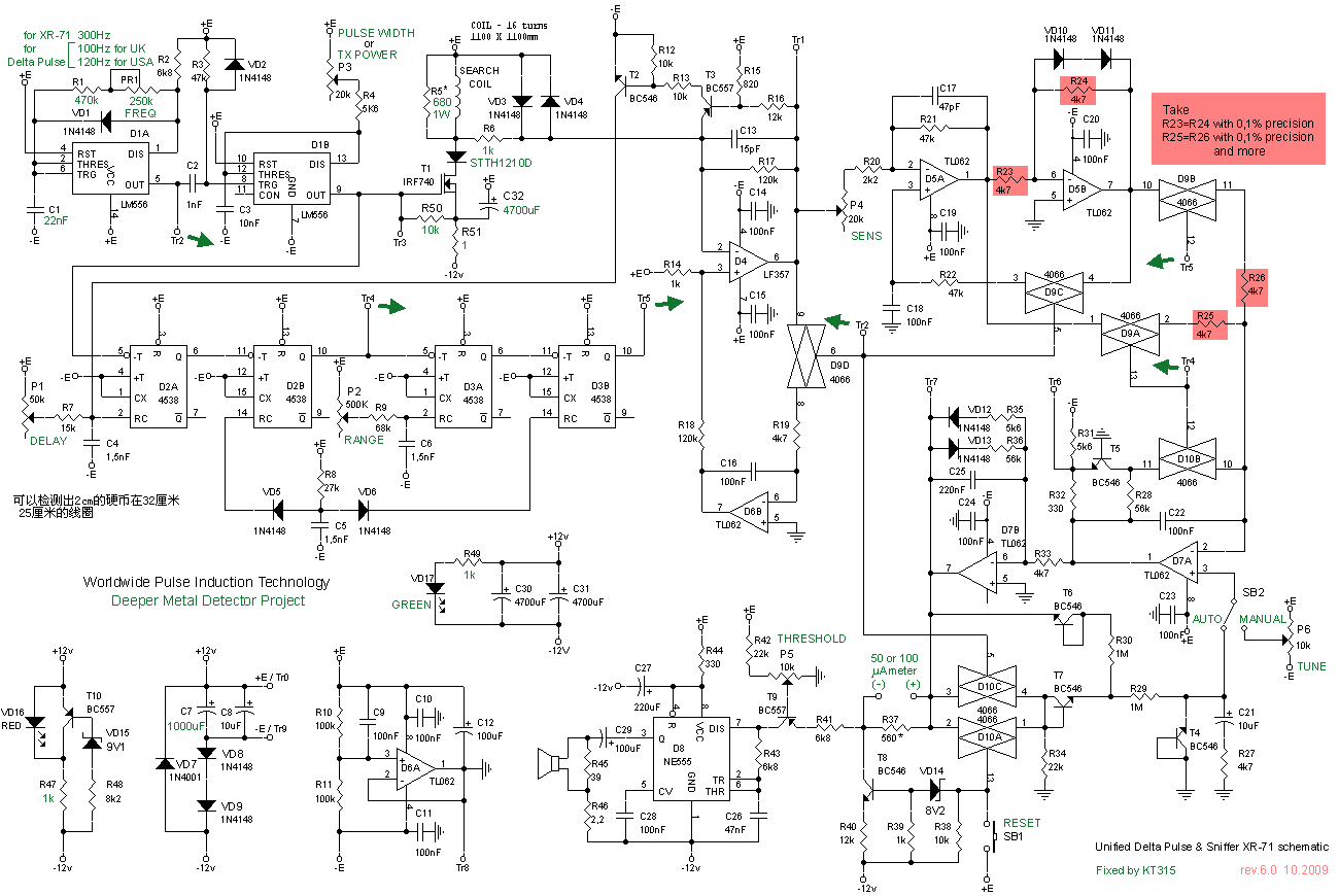

    Hello everyone, I made XR-71 circuit, but can not complete the probe, how to adjust it?
    Can someone explain this in detail the working principle of metal detectors do?
    Because the component is not enough, I use 9014 instead of BC546, Iuse 9015 instead of BC557,I use LM358 or NE5532 instead of TL062.:D
