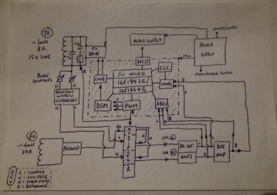

                    i have a block diagram image of the idea in full but cant seem to add it to the reply
                    does an image need to be below a certain file size?
                    • its worked as attachment.. i couldnt see it in preview mode
                      • Your attachment is only 400 pix wide, it's almost impossible to read. Maybe re-size it to an appropriate size ( eg 1024 pix wide) and see if you have any success.
                        [ it seems to be a common problem, maybe George/Carl can look into it... ]

                          • hi Skippy i took a photo with my phone then emailed to my ipad to post.. i choose full file size in order of MB when i emailed it thinking it would give the best resolution
                            • Yeah, that's the problem, I suspect, if you try and upload a picture 4 times wider than the forum page, it's not having it, and resizes it, rather drastically. The pics I've attached were all resized to about 900 pixels or less width beforehand, and they loaded OK, and at that size they can even be embedded directly into the post.
                              • ok thanks ill try emailing across to my ipad again at the lowest file size, im not sure if theres a resize option.. ill check
