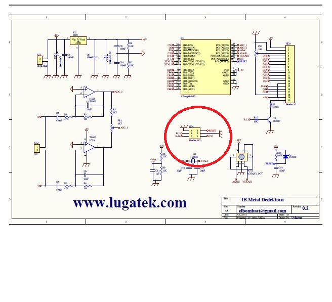

    Hi at all,
    i want to build the Lugatek-VDI...can somebody tell me something about the performence? is it better like the IDX-VDI? are there any problems which one must pay attention? and what i have to do with the jumper?
    regards, Marc

      This kit is only for VLF
      There is conection to few detectors, not all supported

        This is mine, can be programmed the atmega via a jumper.
        Good work, good sensitivity
          Many thanks Ropcsika! then know a bit more. your video I know of course already;-) great work!! can you explain a little more detail? it means I do not need the jumper when I program the atmega outside the board?
          best regards, marc
            best regards, marc
            When you programing the atmel outside the board do not need the jumper.
            1, pogramming the ic outside the board
            2, put into the atmel into the ic socket on vdi board
            3, and done..
              hello schatztaucher
              we had this project in detektorforum
              source code was hacked- no more on off switching limited
              also it is described how to connect to a vista metal detector (i think it was the smart)
              lugatek vdi wokrs good
              look for videos from firebox on yt
