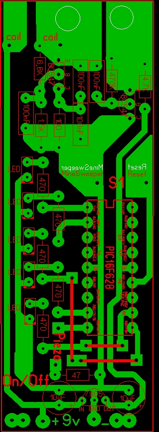

    what do you think about this metal detector ?
    perhaps for pin pointing, i ve done it but can t have any detection whit coil?
    some one have an idea
    http://www.madlab.org/schematics/index.html (select mine sweeper)
    thanks

    beware my project don't work (perhaps my routing???)

          can you confirm me that the pcb is well routed please.

              i ve done it again on another board but it don t works again .i m sure it is my coil.
              if you want to try , perhaps you will have better chance than me.

                coil with 10microH cant be right? the origianl use a pcb coil from what i see maybe only some couples of windings with very thin copper tracks
                  hi berntfind my micro at conrad or selectronic in france (best price selectronic) perhaps reichelt for you (saw good prices).
                  for coil haven t done it with pcb (haven t got any more), done it with ferrite rod and air core .
                  if you do it tell me if its good or not.

                        just finished
                        https://youtu.be/GX0zNFqwAUA

                            if i look into code it seems like bfo or so
                            if think anothe coil and better caps at tx can make some changes
                            but not the big hit
                            this unit isn´t a pi detector
                            at moment i dont make thoughts about the working principle
                            just happy it works
