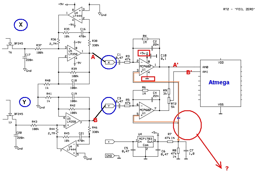

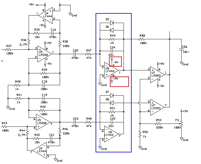

    I would like to start topic Discrimination and calculation of the potential target.
    I will use the scheme Tesoro Eldorado
    (part of the channel bandpass filters X, Y)

    and scheme connection electronic module VDI.

    The induced signal from the receiver coil (the findings) is separated into two components X=R, Y [magnetic, electric - conductive]
    The amplitude of the signal (X and Y) indicates the distance from the object to the coil, or the size a finding (coin),
    and phase of the material object (ferrus, non ferrus etc.).

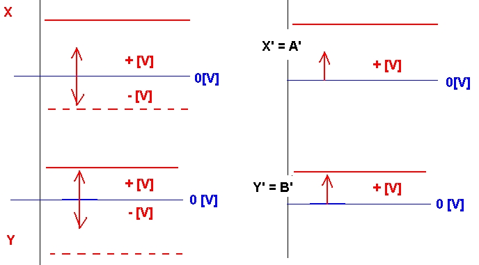

    The signal going into the first mode band filter (low-pass) 5-20Hz changes in short <-x [V] ... 0 ... x + [V]
    by the way there is noise at mV level.

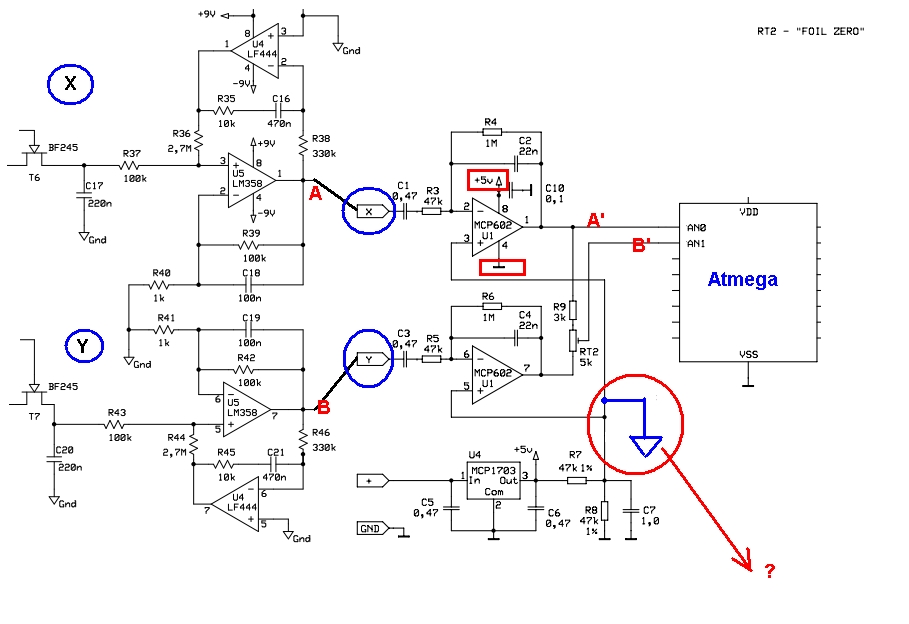

    Going into the second block filtration (X ', Y') + gain (in module VDI) signal inverting amplifier configuration varies in the range < 0 .. X+ [V] >.
    At the same time I saw two options for reversing input connections in the system MCP602
    pin 3, 5 to gnd or pin 3, 5 to 2.5V stabilizer.
    I would like to develop for educational purposes VDI module similar to those presented by colleagues from the forum.
    I would ask the person familiar topic of precision engineering explain the rules operation and interpretation of thise DC signals to the value VDI diagrams.
    From what I can see from the configuration shown in Figure A' B' signal can only be read on a scale 0 ... 90 ° C
    (unless something else I do not understand).
    The standard converted and converts the scale -90 0 90 +.

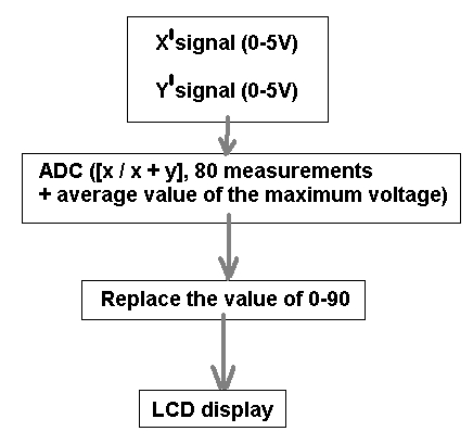

    Im read patent tesoro discrimination US 4486713, if You know any mor patents abaud VDI I would appreciate any leads where I can read the particulars
    my simply idea
    please guide me the right way

        The A/D interface could be bipolar or +and- by holding a ref level at 1/2 rail. So you get the additial information from a negative going signal like iron rather than just going to 0v.

            You can achieve a reasonably good target indication with a PIC by implementing arctan(y/x), where y is the DISC channel, and x is the GB channel. Read each channel 50 times and take the average. The ADC can have a reading between 0 and 1023. Scale the averaged reading for each channel so that this value is centered around 511. i.e. 511=0, 1023=+512 and 0=-511. Then use the arctan function to calculate the phase angle. You can also calculate the amplitude using the square root of the sum of the squares.

              Yes agrees Atmega ADC = 0-1023 except that, for example, by measuring the voltage -5 0 5 [v] is losing resolution.
              there's another problem in the configuration of the diagram (module VDI , schema) A' and B' take only dodt voltage <0 x+> [V]
              (In my module mcp602/ LM358 THE pin 3 , 5 is conect to gnd)
              (I guess, although I do not know which pins are connected to 2.5 V - orange lines in schema)
              so would only be a positive measure on a scale 0 - 90 of this I understand.
