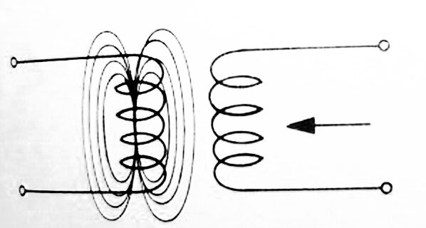

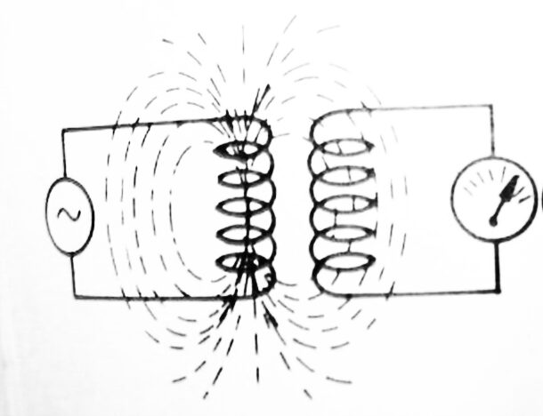

    The next very basic one is the trafo-detector (transformation).
    AC energy A gets transformed by trafo coil A over coil B to AC energy B but if there is a metal nearby the result is different.
    (principally this is already IB or in other words - ID - induction difference)

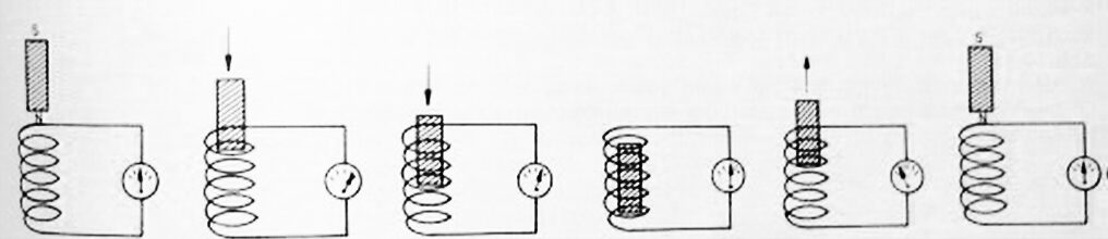

    extremly simple also is the Volt-Meter detector - moving some piece of iron next to a coil will move the milli- or micro-Volt-Meter
    because of the electromagnetical force and interference.

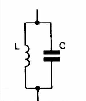

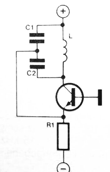

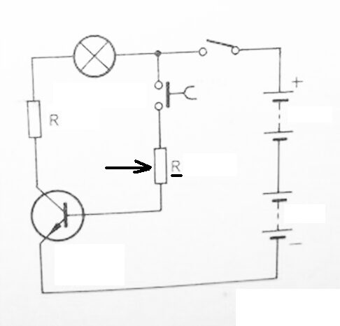

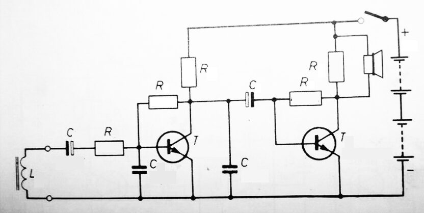

    So we must start with some simple LC-oscillators - also called "tank", circuits who keep them on a certain level, followed by output stages.
    Here is the begining, if you need any explanation - just ask.
    The next step will be the "real" start of metal-detector schematics - I hope some profis here also can provide them and explain how they work.
    but lets start with some very basic circuits:
