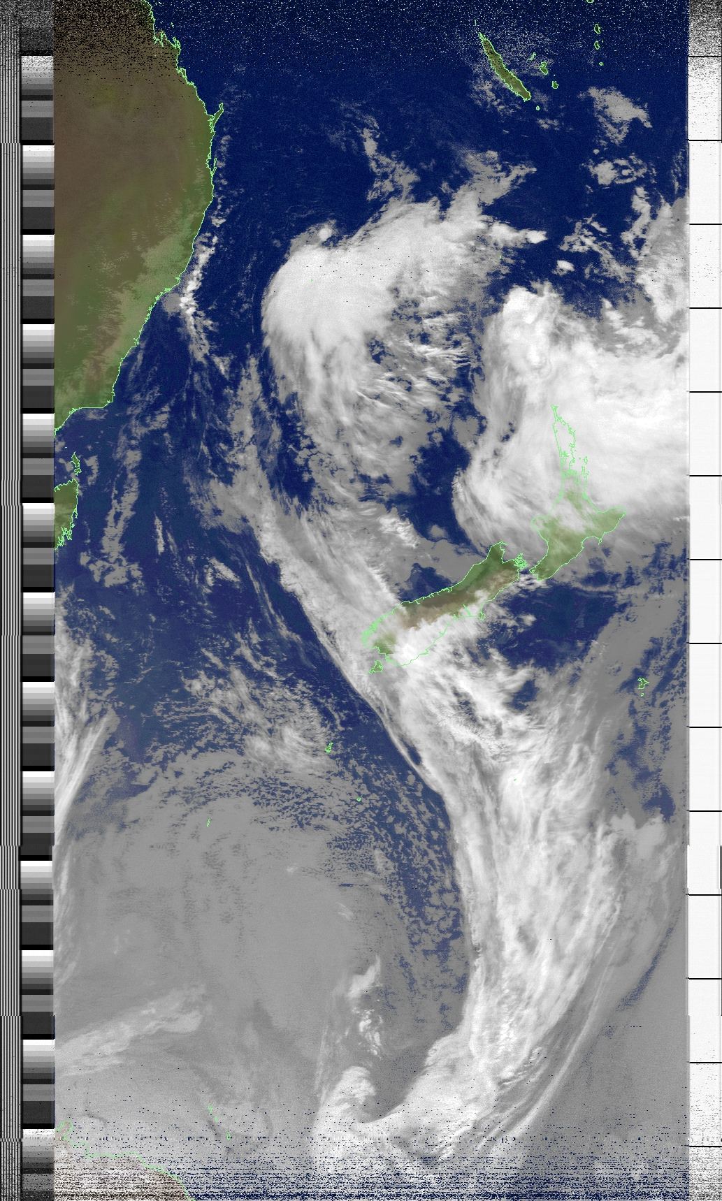

I've been playing with APT transmissions from the NOAA polar orbiters.
Here's an image from last night. I've got a dual gate FET amp/BPF just before the dongle and will be adding another at the antenna, a simple quadrifilar helix, to see if I can get a clear image of Antarctica.
I'll post back if I find it of any use with MD construction.
