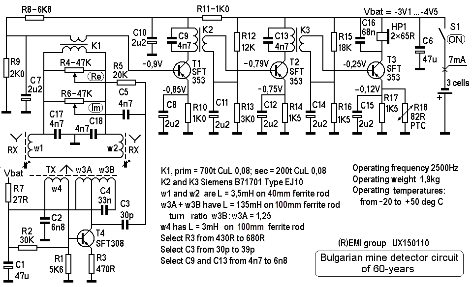

    This is a good the circuit for metal detection in high-depth
    Metal detecting depth = 25 * 25 1m
    But I would like like to strengthen this circuit
    Please help me
    do not waste your time on the digging in oldest schematics' mount. buy a fabric made PCB from silverdog and begin to solder.
      Our country is sanctioned, and I am not able to buy an external site
      So we started from zero
      Please help build this circuit
      I made ​​two box sascho circuit but very big and dangerous.
      I want to focus is the use of technology such as two box tr
      I want to depths of 4-5 m.

          There is a more new design made 10 years later by the same woman (Leslie Huggard)

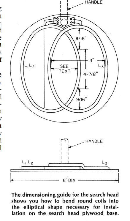

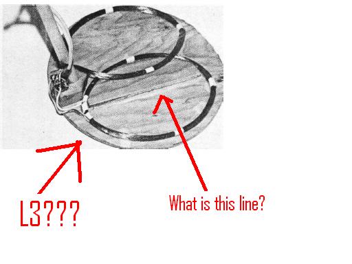

          What is this line?
          I want by this project to make a TR detector
            It looks like a join or grain in the plywood.
              re

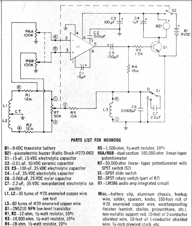

              It was said in the article, 3 pcs but is shown in Figure 2 loops?
                The loop on the left, marked L1 / L2, is a center-tapped coil. The line you can see in the picture is the wire going to the center tap.
                  So total of we have 2 loops,it is right?
                    Look at the schematic. There are two loops, but one is center-tapped.
                      re
                      Thank you so much for the help you
                      Schematic of loops 1 and 2 are connected togetherSo I'm going to connect?
                      What is the capacity of each coil?
