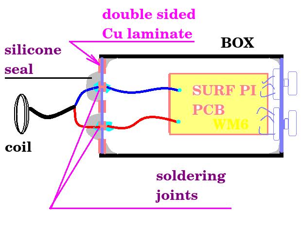

                        Hi Geo, instead of using waterproof connectors, you can try this:
                        A little more soldering on coil change, but waterproof safe.
                              [ATTACH]25979[/ATTACH]
                              WM6, seems good solution but i can't understand what you mean with laminate. Google translate don't help me
