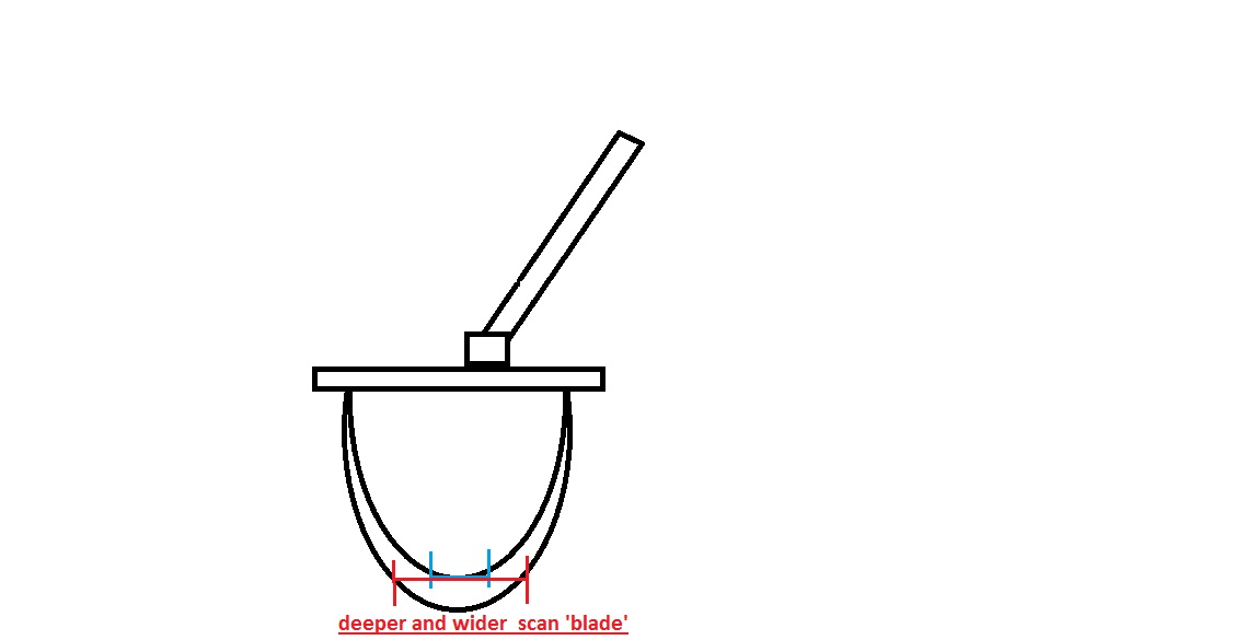

        I put a momentary action flip switch on my idx on the disc pot to tggle quickly between all metal and a previously set disc setting.
        I hover over a large target high up sometimes a foot or more and when it starts to dissaper in all metal - so its detectable but weak - then flip to disc and 60% of the time it fades to a snap or a click and then recheck by letting go of the switch to a full tone - that way its deep rusty iron and you move on.
        The mod is just a switch and 3 wires tacked on.
        You get the advantage of about 1 1/2" extra depth and a correspondingly larger foot print / sweet spot. Less likely to miss stuff.

          I already have a PP/All metal mode toggle switch. Nice tip for rejecting large iron.
          Don't understand the last statement larger sweet spot is that in all metal or disc. "I will have to try a few targets at home"
            In all metal you dont loose any of the Non Fe signal as you would if the Disc gating is wound out to not gate early iron signals.
            If you reject all traces of the early iron signals you loose some of the non Fe signal energy also, as the signals partially overlap.
            If you get more signal through you get more depth, and the edges of the coil get a little more signal too - like the drawing.

              Thanks for the explanation now I understand
