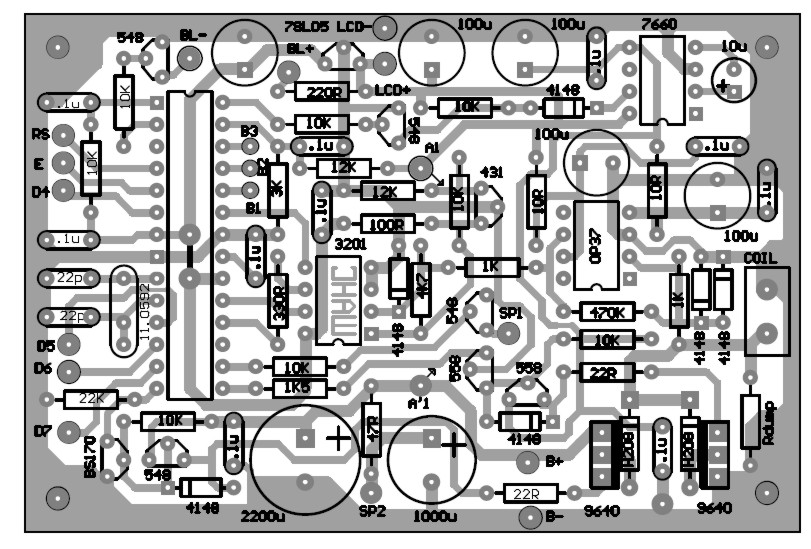

                        In meantime, this may help. Single layer PCB, 100% tested, easy to DIY made using toner transfer or photo etching. Not my design, something from, presumably Russian forum, I just entered it into CAD. Only two jumpers and A to A' connection for 220uH inductor (or just short it). Just in case, check if everything is printable, this is improvised post from netbook, not having all software needed to make pro files. PCB is in old Protel format.
                        Somewhere in backup I have all this, also waveform measurements, explanations etc, long time ago posted on some foreign forum, will re-post here, if I ever manage to find files. Few detectors made using this PCB, it is different from Silverdog version, in turn different from original, using ground plane on top layer, never compared all them, but no obvious layout issues with this, (not errors, layout can be critical for circuit operation), works just fine. This is originally for older software version, later author introduced some small changes, newer version SW will work on this one too, can be easily modified, I never actually compared effect of small hardware changes to performance. I don't have working detector anymore, it was long time ago, so don’t ask...

                        Last edited by Tepco; 09-09-2013, 10:51 PM. Reason: Actually only one jumper, i modified it
