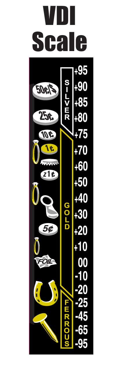

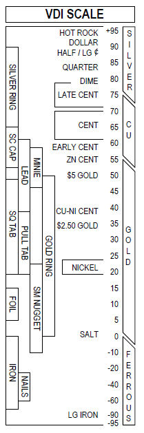

                  • #84
                    Looks like you got best results from Chance I ever heard. Good Job!!!
                    Many others blaming on numerous errors in target identification.
                    Probably you have assembled it correctly, with quality parts and coil is most tricky part of it.
                    Good coil is required to get precise results. Also knowledge how to setup and use that detector is essential.
                    So far, so good. I can see that your Chance acting just like a good VLF machine but with PI advantages.
                    So it serves its purpose of creation.
                    I am collecting components to build it already.
                    Regarding results, they fits classic VDI scale you can find in most VLF detectors.
                    That beer bottle crown caps got that designers from Whites and Fisher scratching their heads too
                    You can find that shameless piece of rust just at the center of color metals sector, near penny and gold rings in official VDI scales:

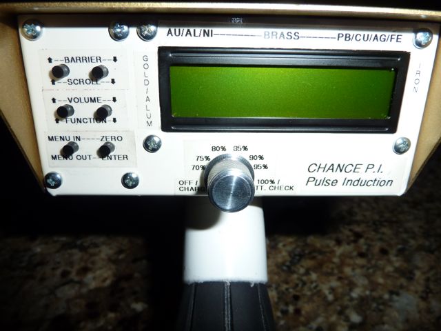

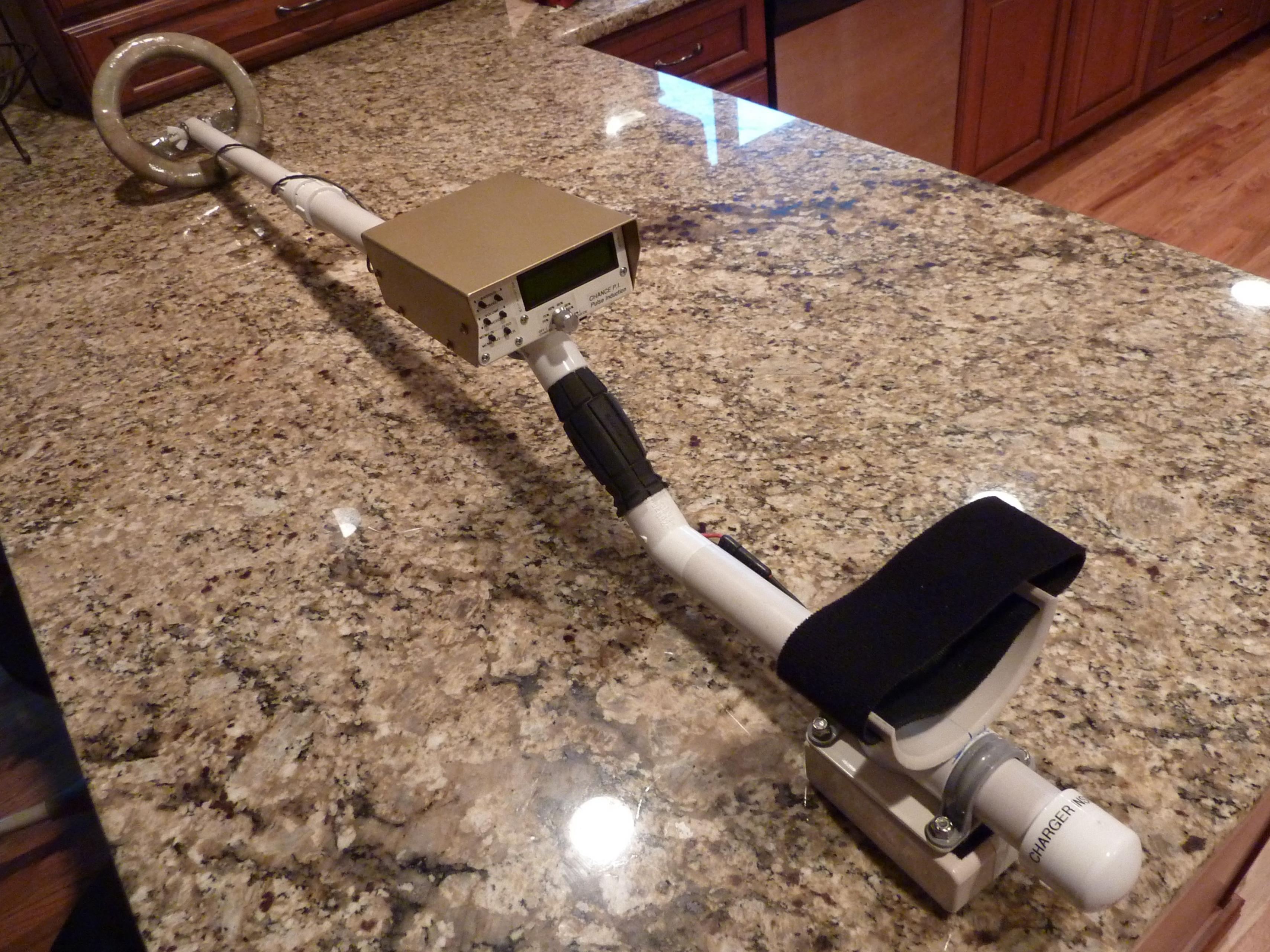

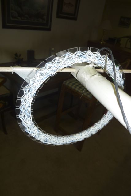

                              • #90
                                Pictures of my CHANCE PI
