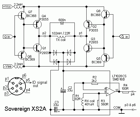

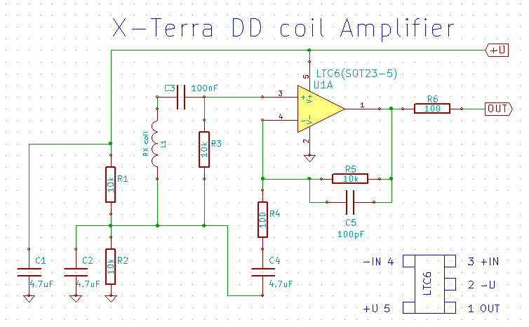

I want to experiment with the bifilar center taped coil. I need to purchase some in-amps but I dont know what I'm looking for. I dont really know how to choose an amp for a PI machine. Any recomendations would be welcome.

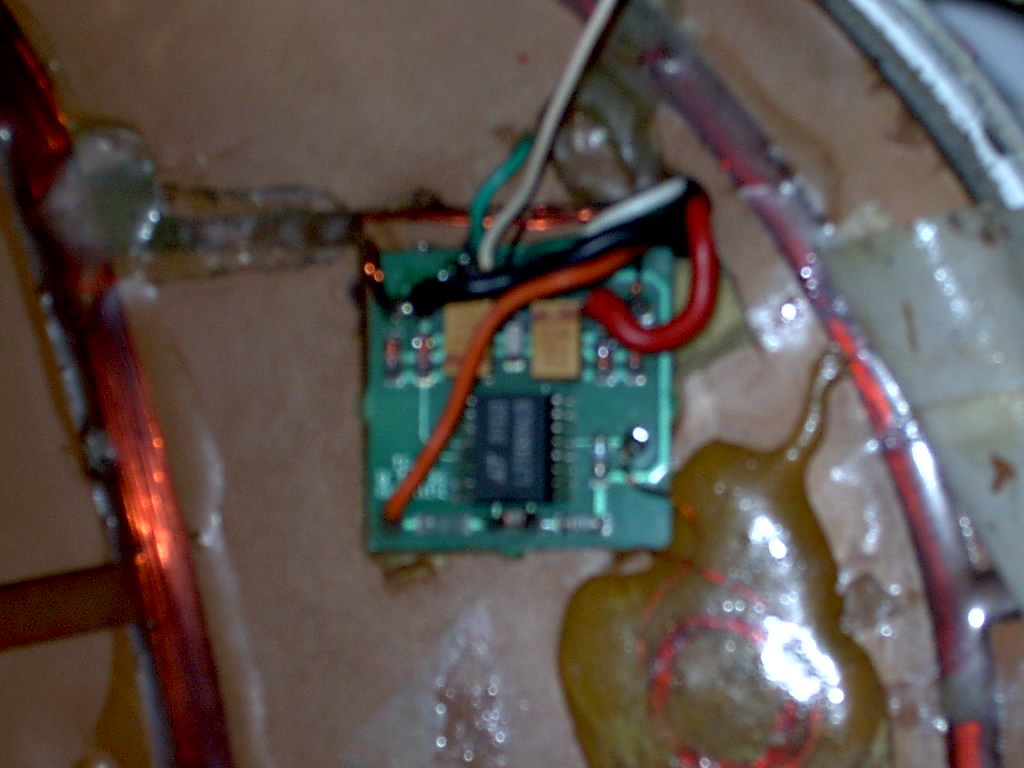

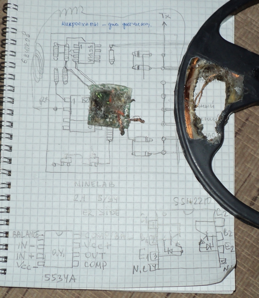

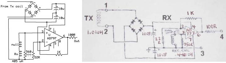

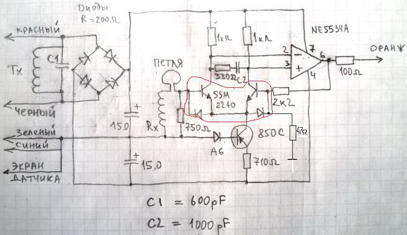

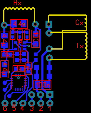

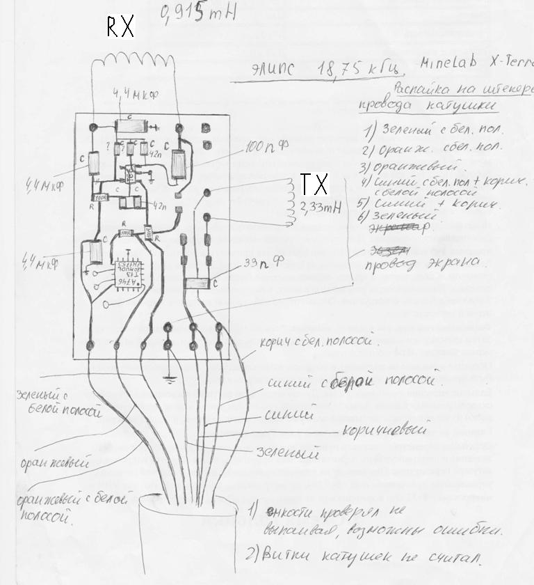

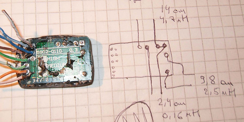

There are 2 good approaches to instrumentation front end, THAT ( http://www.thatcorp.com/index.html ), and discrete.
There are several THAT models to pick from, and all of them are very low noise, and perfectly balanced.
A discrete approach can be achieved either as a full-blown Cohen solution, or something a bit less ambitious, but still a discrete in the front-end. All these choices are nicely explained here: http://www.thatcorp.com/datashts/AES...ic_Preamps.pdf
You can skip the phantom power part as it deals with microphones, but the rest of it beginning at pg. 25 is very applicable.

Check out the (eight pins) SSM2019 from Analog Devices, it is categorized as an audio preamp but has balanced inputs, and gain is set with a single resistor.
Some other possibilities would be AD8429, INA103 and INA163 (the latter two from TI).
Make sure you look for low e-noise, and stay away from those ia which have FET inputs.
Hint: divide the e-noise spec by the i-noise spec and if the quotient is in the hundreds of ohms the device in question likely has bipolar inputs. (Any FET input device will probably have a double-digit e-noise spec.)

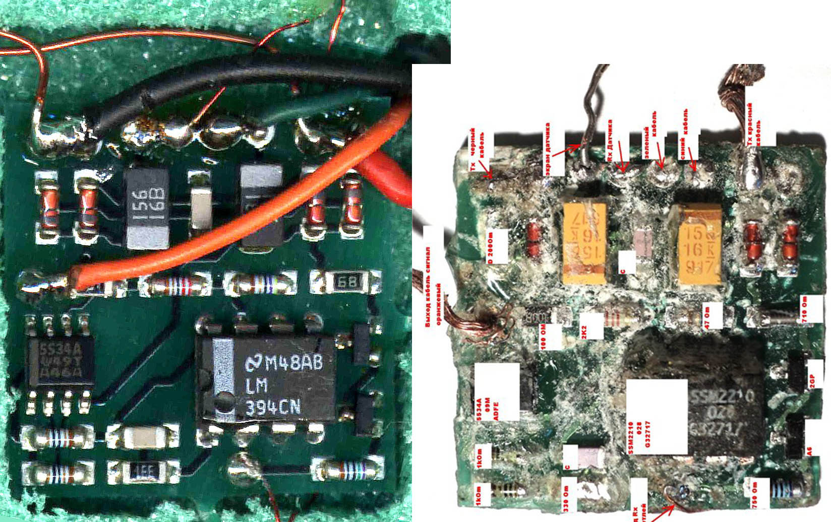

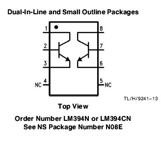

True. You obtain much better noise with garden variety transistors, such as BC337. That's why I mentioned the discrete solution as comparable to THAT. Besides, THAT devices are difficult to come by, and prices are not attractive at all. We might use this topic as a stub for discrete designs of instrumentation amps, as the common denominator of all good truly balanced front ends is a low noise transistor pair, so why not discrete?!

Have some descrete circuits in mind...but matching the frontend bias transistors is a challenge with current component offerings.

Close matching of components is fine if you need to maintain amplification down to DC, but point is that you do not have to. There are a few solutions in that document that actually work. If you put large enough capacitor in between the transistors' emitters, you are relieved of the transistor matching, and the rest of the story becomes easy.
