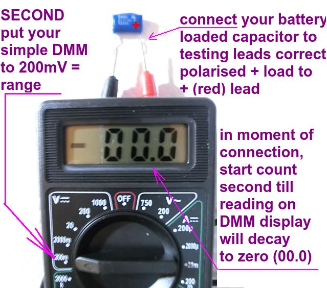

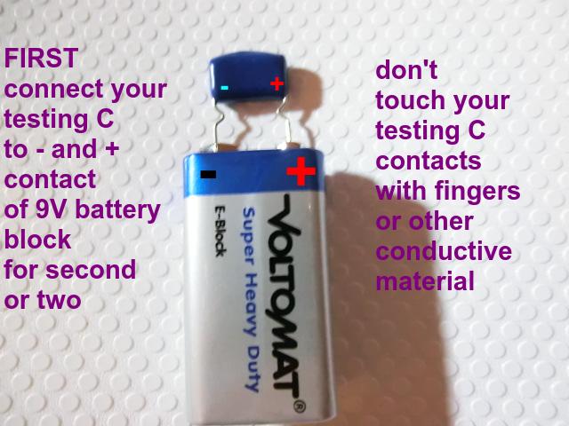

        Bainsey, what sort of instruments do you have?
        Even with simple multimeter you can still check value of your Cx.
        You need to load your Cx with battery or power supply (in your case you can use battery from say 9v till 50V).
        Capacitor with different capacitance have different decay to zero from fully charged.
        This different time constant we can use for simple check of capacitors value.
        As comparison ethalon we need some capacitors with known value (you can use known capacitors of 0.1uF, 0.01uF and say 0.47uF or so).
        I am using for test 9V battery (look at picture), and capacitors of 0.1uF, 0.01uF and0.47uF.
        Measured time constant at my simple DMM was:
        for 0.01uF (10nF) - about 2 seconds
        for 0.1uF (100nF) - about 4 seconds and
        for 0.47uF (470nF) - about 6 seconds
        More precise you measure time of testing ethalons, more precise results you get in your C measurement:
