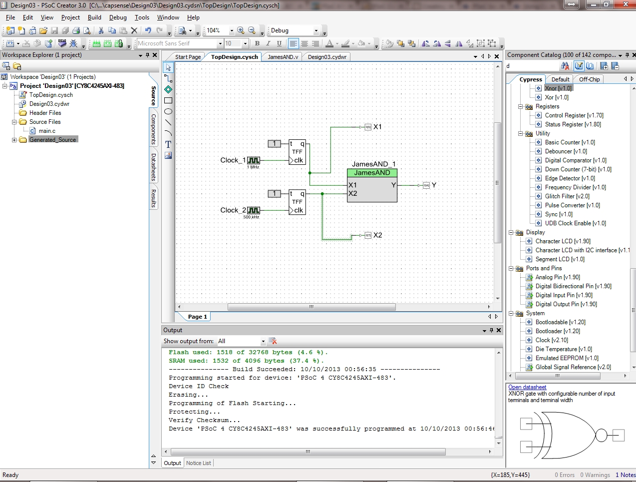

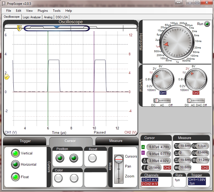

                    Heres the kind of thing thats really nifty to me. I created a simple AND gate in verilog in the PSOC creator, dropped it into a schematic and tied a 500khz clock and a 250khz clock into the two inputs and tied the output to a pin. I also tied the two inputs to pins so that I could view them with my scope. This required 0 lines of code (except for the verilog info). Iv'e attached a couple screenshots of the waveforms and the schematic in PSOC creator...
                    I actually had to drop the clock speed way down so that I could use my little oscope. Only thing I dont like is the system clock cant be tied to a pin on the PSOC 4 like it can on a PSOC 3 or 5. Have to use a clk input.
