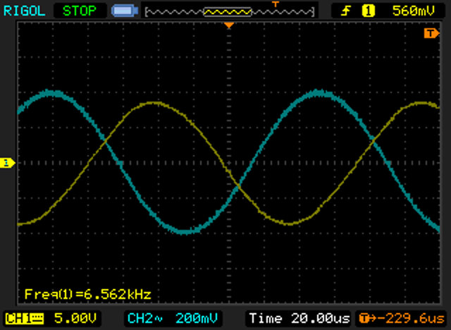

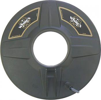

    I can't get my IDX-PRO to discriminate iron. In order to find the cause I have first looked into the coil configuration. I am using a white's coil, see picture. When connecting the coil to a tone generator (through a 1k resistor) and looking up the maximum amplitude while changing the frequency the TX coil resonates at about 6.57 kHz, the RX coil is at 4.90 kHz.
    I have hooked up the TX oscillator to my RIGOL scope (yellow line), the scope measures 6.562 kHz which looks okay to me. The blue line shows the output of U1 (NE5534) the RX amplifier. I am measuring a phase difference of about 200 degrees.
    Do these figures look okay? 200 degrees seems a bit to high, I remember the TGSL having much smaller numbers...
    200=180+20 ... it is OK
      Aaaah, of course... actually, it is a bit more: about 220 degrees, 180+40. Okay looking good, need to go into the rest of the electronics.
      Thanks Davor!

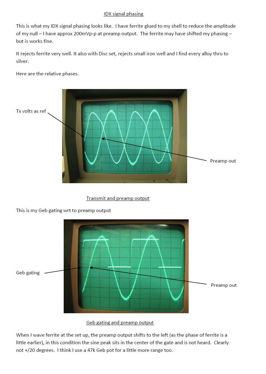

        Hi Joop, My IDX is ok. It rejects Iron and ferrite well. Here is an image of my Tx volts and preamp out..
        Can yours phase out ferrite by adjusting the GEB pot?
        Im trying to see if one or both channels are playing up..
        If you can get rid of ferrite, then the initial phasing is ok and you may have a build error on the Disc gating phase shifter?
        Are you certain your PP switch is the correct way - your not having a senior moment with the PP on ??
        S

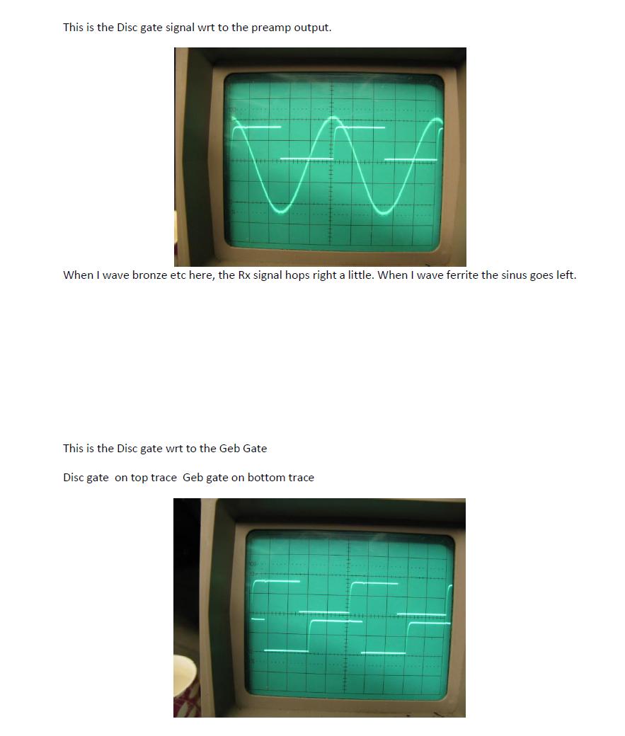

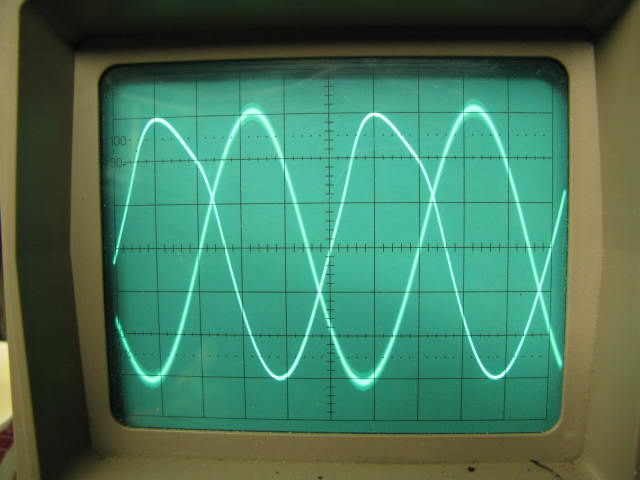

                            Here is my phases while its working good.
ID:	337955Click image for larger version
                            S
