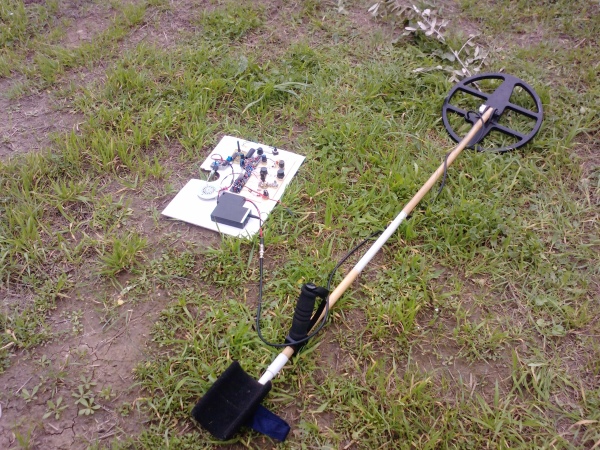

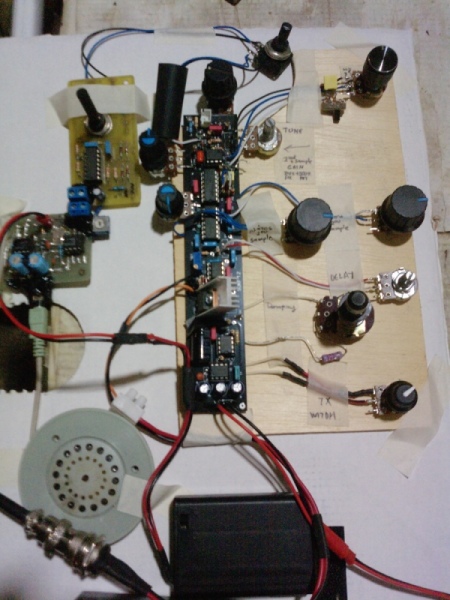

                      Now about Surf Pi, you can try to add ground balance using the second sample.
                      the trade-off? you lose 20-40% of the normal "depth".
                      Of Course, also you lose the benefits of the normal use of the second sample, but my goal was to learn about Ground Balance.
                      As Mick said, finally you must use 3 samples (minelab) or 4 (TDI).
