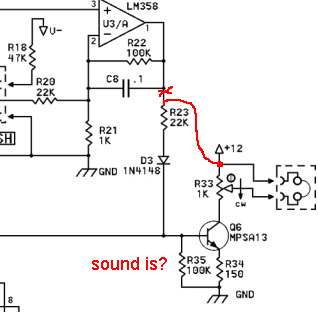

    I just finished putting together a surf PI 1.2 kit from silverdog. I have assembled everything with no issues.
    When I apply power and turn it on, I get 5.8v and -4.8v and I can also set o.ov offset. The only issue is that I have no audio. No sound whatsoever. I even checked voltage at the speaker pins and nothing there.
    any pointers or help in the right direction...?
      Is this the bridge that gets soldered in? Or is it an addition I need to add?
        It is temporary, testing circuit you have to use to check sound block only. After that change to schematic you have to hear permanent sound signal, if not, there is something wrong with transistor Q6, speaker or components around it.
          after looking at my board and the parts list, there is no R33...
            P4?
            http://www.silverdog.co.uk/shop/image/data/schematic1_2A.JPG
            from part list:::: P4 = 1k [Volume: Trimmer on PCB or Potentiometer]
              good news... the piezzo buzzer that came with the kit was bad. after buying a new one, I have audio and I will be able to set delay and offset now. thanks for the help guys
