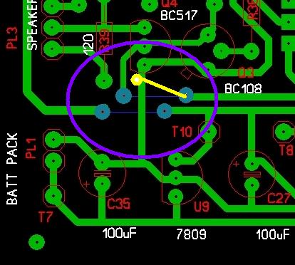

Solved the following problem: the square wave on TP3 (opamp output) was wrong.

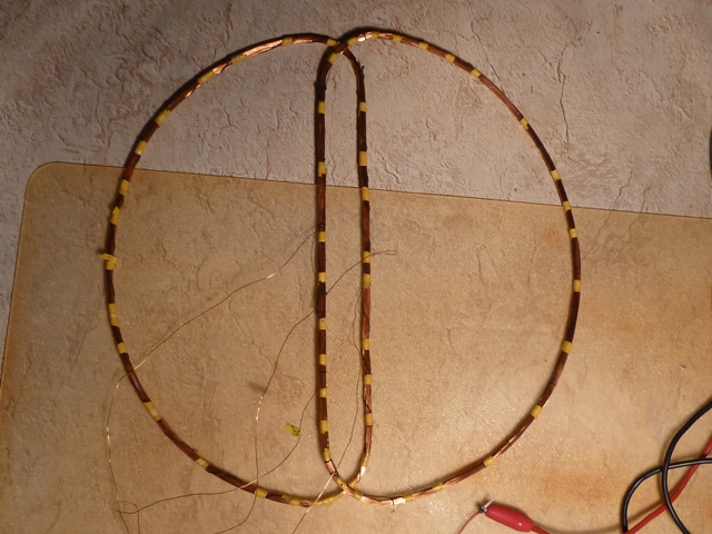

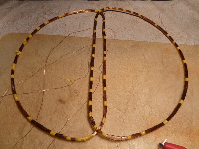

I have taken the 2 D coils from the housing and placed over one another.
first
Then I slid it (very little)
result:
TP1 & TP3

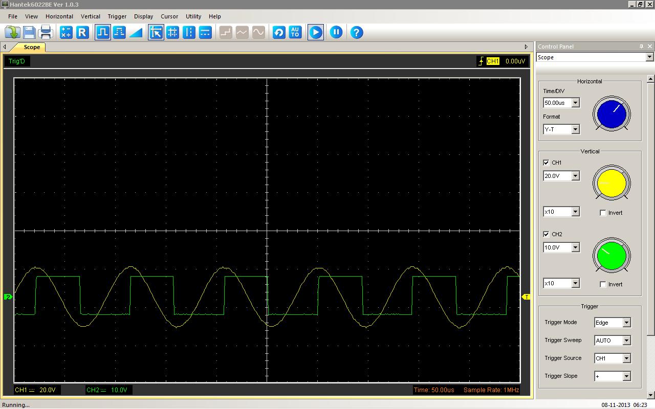

Originally posted by Dixix View PostHere is the step 11

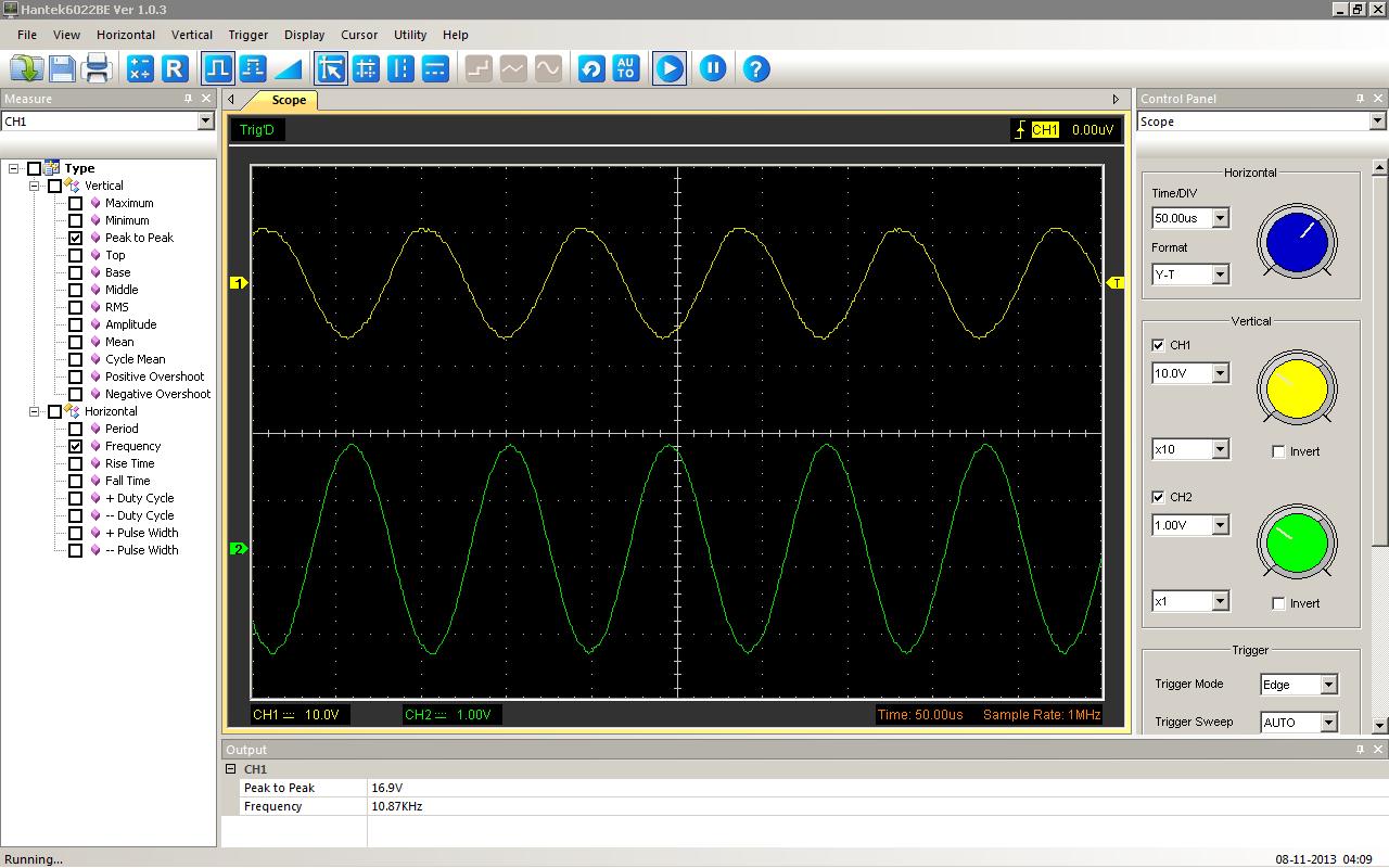

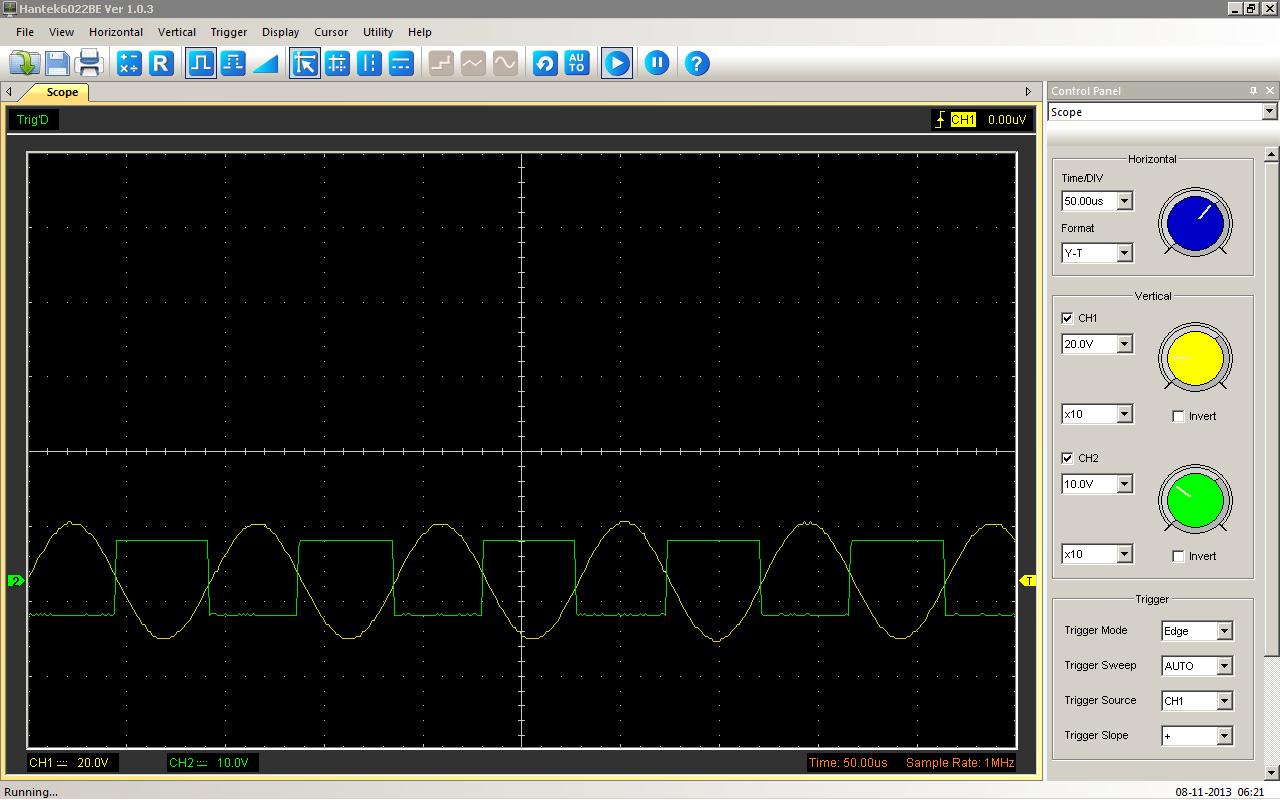

My Oscilloscope - monitoring for OFFSET DISC:
TP2 = Ch.2 (green)
TP3 = Ch.1 (yellow)
[ATTACH]27157[/ATTACH]
Is that right?
(Incidentally the little compadre-coil does not work with the Raptor)Yes, perfect!Originally posted by Dixix View PostAnd here is the step 12

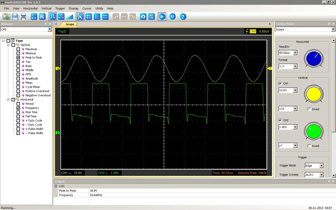

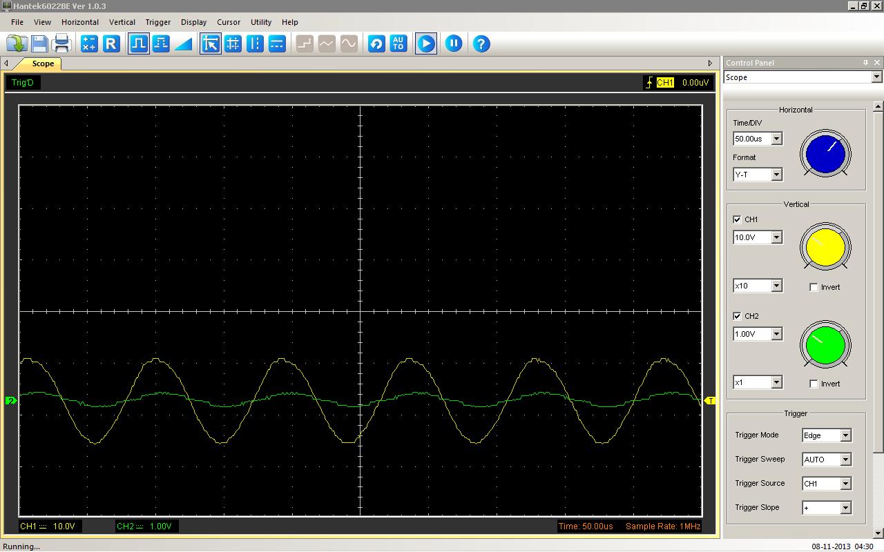

My Oscilloscope - monitoring for GROUND BALANCE
TP5 = Ch.2 (green)
TP3 = Ch.1 (yellow)
[ATTACH]27158[/ATTACH]
Is that also right?

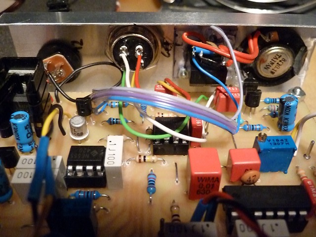

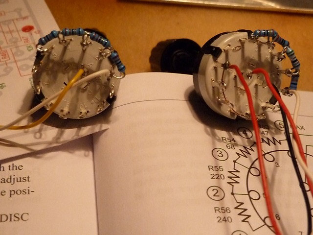

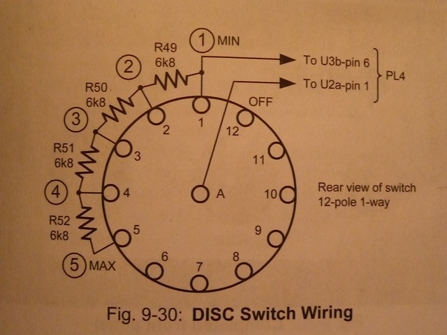

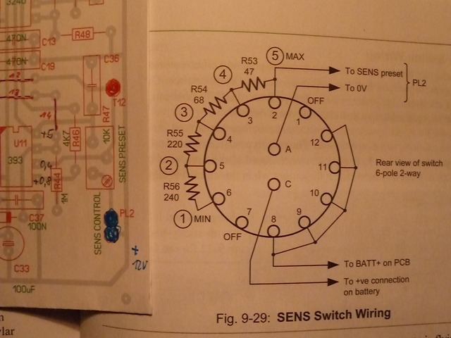

I have now soldered the two switches. (DISC and SENS)
Here is a small misprint in the Book? The pictuere on page 119 "DISC Switch Wiring" shows PL4. First connection (U3b to - pin 6) and the second connection (U2a to - pin 1) is different from the PCB.
first connection of PL4 going the rail on pin2 of U2 and the second connection of PL4 going the rail on pin 6 of the U2?
The Picture "SENS Switch Wiring" shows the second connection on PL2 on 0V. but it is not 12V rail?
So it shows the plan of PCB ....
I'm confused....

Have you read the Updates/Errata section? ->Originally posted by Dixix View PostI have now soldered the two switches. (DISC and SENS)
[ATTACH]27168[/ATTACH]
[ATTACH]27169[/ATTACH]
[ATTACH]27170[/ATTACH]
I'm confused....

Originally posted by Qiaozhi View PostHave you read the Updates/Errata section? ->
http://www.geotech1.com/forums/content.php?143-updates
Yes, I printed it out and put in my book. I first looked into the errata list. I've no read about any error on the page of 119.
Sorry.
It seems to have nobody notices.
That's why I also made pictures.(see above)
Please help me
Thanks for your efforts! I know to appreciate this!
On page 119 (DISC Switch Wiring) the connections should be U2b-pin6 and U2a-pin2. The SENS Switch Wiring appears to be correct. We did introduce a few errors when the original schematics were manually transferred to Microsoft Visio. If you find anything that looks wrong, then compare it to the PCB layout which is 100% correct.Originally posted by Dixix View PostI have now soldered the two switches. (DISC and SENS)
I'm confused....

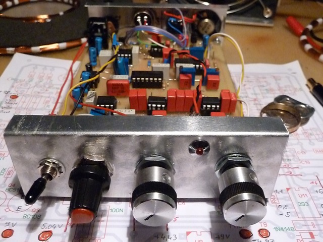

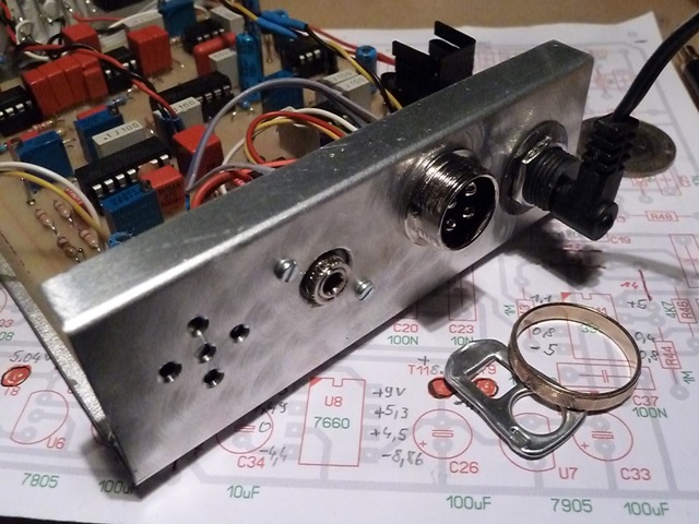

Finally! My Raptor is ready.
I have now found out why the coil (4 "Coil Tesoro) functioned poorly. No. I thought it is because of settings. The old wooden table has a few iron parts at the bottom ...
That was the distortion factor. I now put the coil to another place and it works. Especially the DISC. Incidentally, It’s an interesting idea with the step switches!
Now I am looking forward to experimenting with the circuit and various homemade coils ....
One more question: Is it better to connect the aluminum housing with 0V?
Dixix
