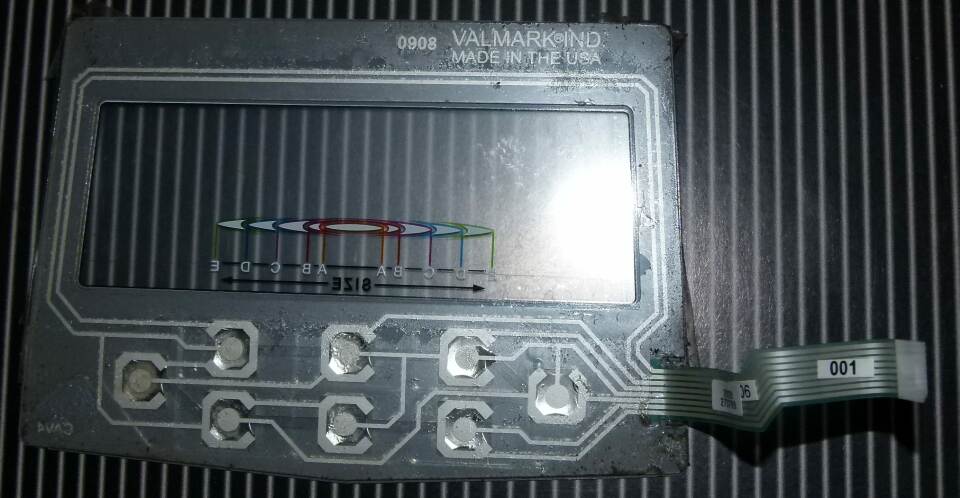

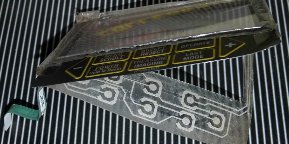

Repairing such a bended, sticked or shifted and whatever broken touchpad button is really no fun:
You have to open the housing, next you must remove the touchpads flatribbon-cable and only after this procedure its possible to tear away the "softglued" Touchpad plastic-foil from the outer part of the housing.
Now this foil contains two parts, see: touchpad2.jpg

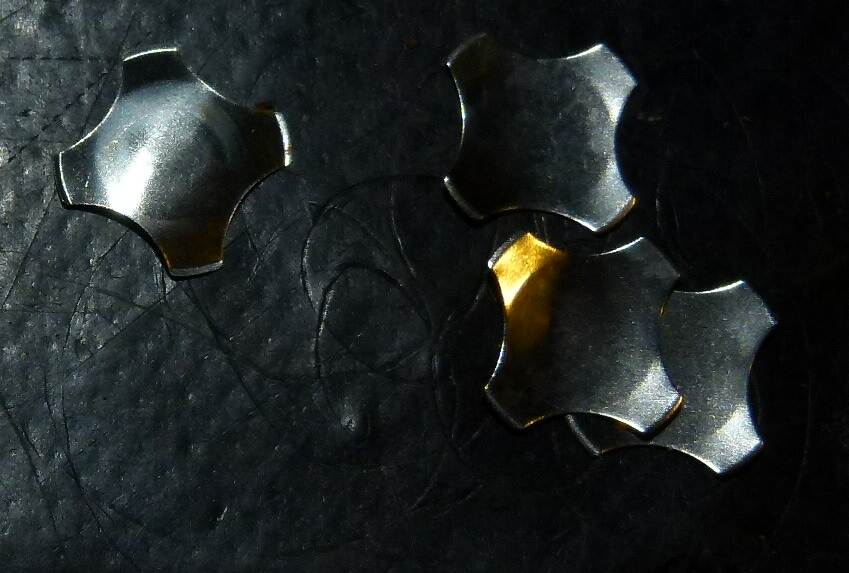

With caution remove the very sticky second foil and be careful not to lose the little metallic buttons (they are free movable after you have lifted the foil)
After this gently bend the faulty buttons back to its original shape, but not with too much force.
When reinserting be careful to put them with the correct side ahead back on its formerly place.
The little hills have to show into direction "outside" of the detector, into direction touchpad describtion.
Use clean fingers otherwise the sticky glue inbetween the layers can't hold the buttons on their correct places.
Be extremly carefully not ripping or tearing the foils itself apart.
You also should polish the small contact areas carefully because I found out those starts to oxidate after some time!
btw. I was successful to repair the Touchpad and my Garrett GTI 1500 now works as before - all buttons are functioning.
