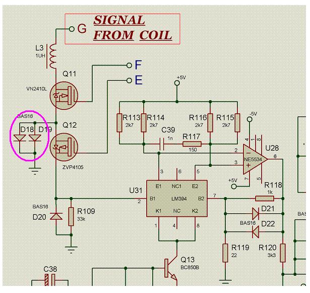

      This "parallel diodes war" lasts too long and looks like old joke that everybody knows but I don't ... So can anybody show the initial circuit with these diodes - I want to understand what is funny here
        You didn't miss much. It's just troll/marketing science (how to shove a ridiculous amount of unsuspecting parts in a single box and not causing them to give up smoke). There is no reasonable explanation to the whole notion, just a few resident trolls making silly excuses. No hobbyist in his right mind would ever look at this twice, unless for a joke or two, yet Carl threaten us all not to do that.
              Her you are:
                As for me , I can see only one purpose of these parallel diodes ( used as a voltage limiter here ) - to decrease their forward drop in order not to open the body diode of the Q12 mosfet . It's the only reason here for 2 diodes to be better than one
