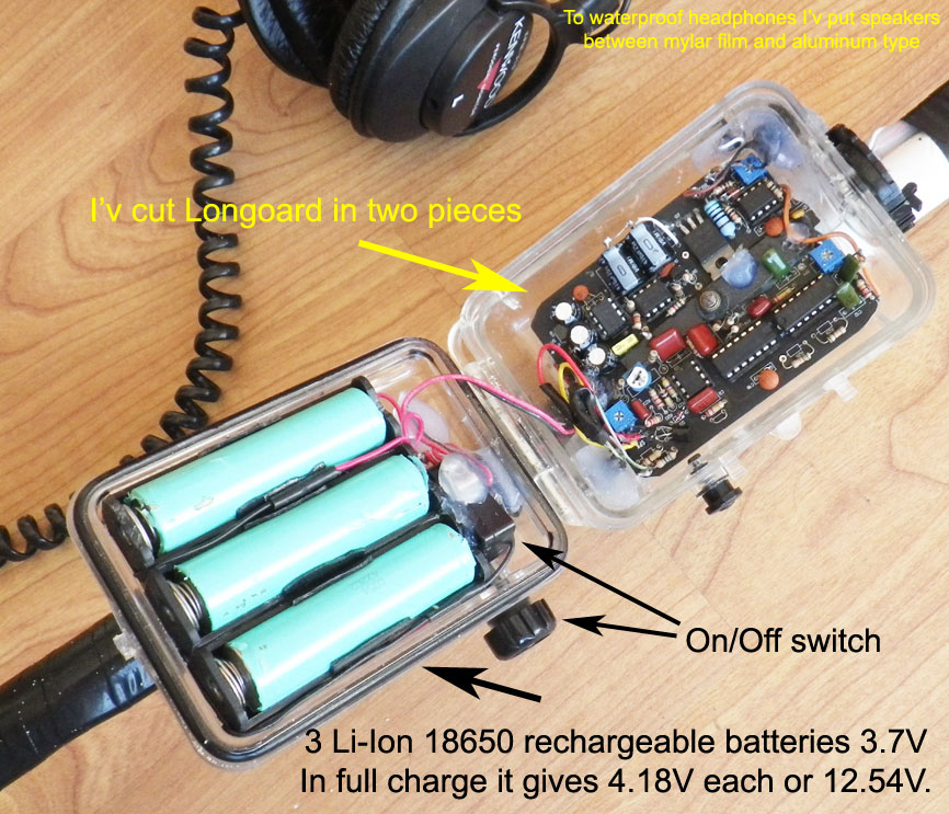

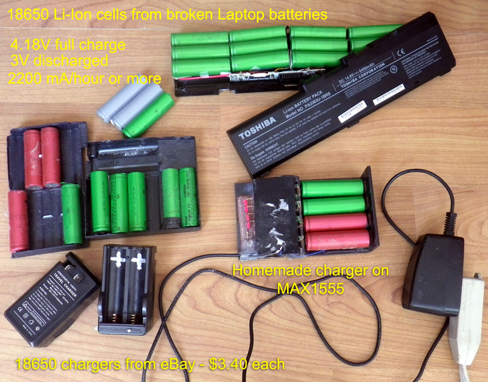

              I can recommend to use three 18650 Li-Ion 3.7V rechargeable batteries.
              They will give you 2000 mA/hour or more at full load.
              At full charge it gives 4.2 Volts each or 3 X 4.2 = 12.6 V
              They contains much more energy and significantly lighter in weight then any other rechargeable batteries. Otherwise why every electronic device in the world using Li-Ion or Li-Poly batteries now.

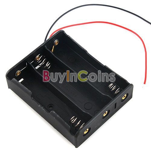

              You can buy 18650 cells for $1-2 each on eBay, you need $2-3 for holders for 5 cells. Charger for 2 cells costs near $3. Holder for 3 cells $1.29 Click image for larger version

              Also there are very good 18650 cells you will find if disassemble any broken battery from notebook, laptop, netbook computer.
              Than you will have free and literally unlimited source of power for your PI detector. 500 charges for every cell.
                Thanks for the tip Waikiki. I will certainly have a look into that. I have a couple of scrapper laptops kicking around work, so will attack the batteries there first.
                Regards, Magnette

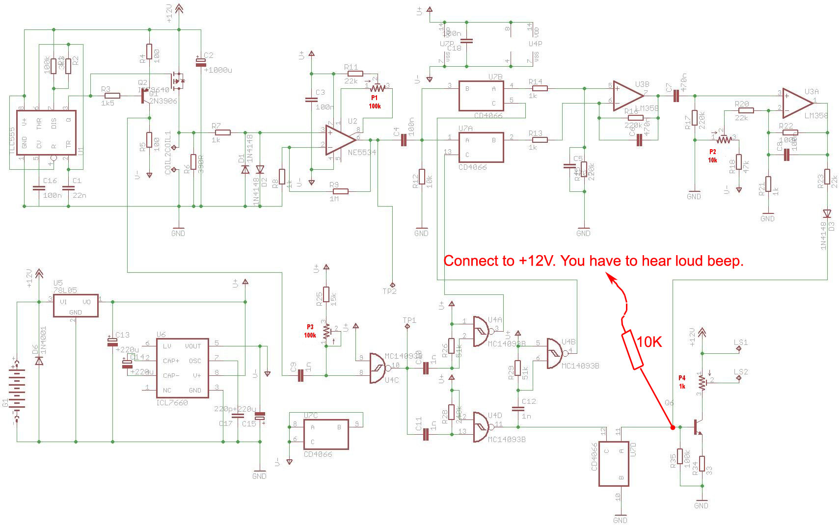

                  Hiya chaps, I wonder if I may call upon your knowledge a little further. As a temporary power supply, I connected the surf up to a power supply from a car battery charger, which gives a constant supply of 11.7v. On turning the surf on, I got an extremely quiet constant tone from the piezo sounder. This was not affected by moving either of the control knobs. The only ways of getting any tone any louder from the piezo were to move the coil virtually on top of the piezo sounder, or swap the sounder and coil connections around on the board. This gave a full loudness tone to the piezo sounder, but still could not be controlled or detect anything. Any ideas of what may be wrong (apart from a rookie like me building it!) would be appreciated.
                  Many thanks, Magnette
                    Good news that coil and TX probably works. Bad news that you have assembled something wrong or some parts are broken.
                    Check presence of supply voltage + 5V and - 5V on the board with multimeter first.
                    Check it on LM358 -5V ( leg 4 ) and +5V ( leg 8 ) to the ground of the board ( contact "-" of power supply ).

                        Also you have to set zero volts to ground on leg "6" of preamplifier NE5534 with using "Offset" trimpot. Preamplifier will not work without correct offset adjustment.

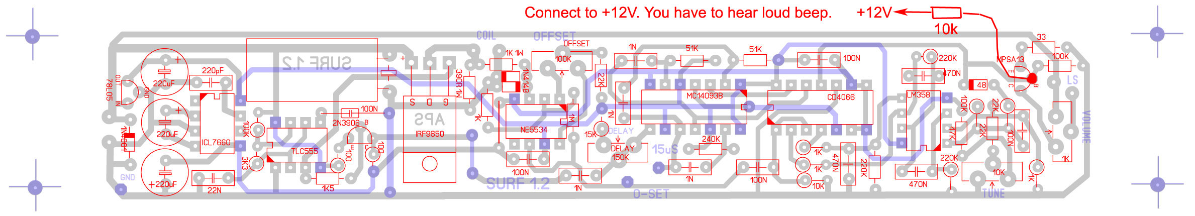

                              Check if you have inserted ICs correctly. For example CD4066 and CD4093 (MC14093) stay face to face.
                              Bad soldering is a sickness of any DIY kits. Get a big magnifying glass and try to find places where unexpected contacts on PCB may occurs. Clean PCB between IC legs. Look for bad contacts where solder was cold. Re-solder such places. Use flux when soldering. Remove flux remainings with isopropil.
                              First, use 10k resistor to check if you have a sound and oscillator working:

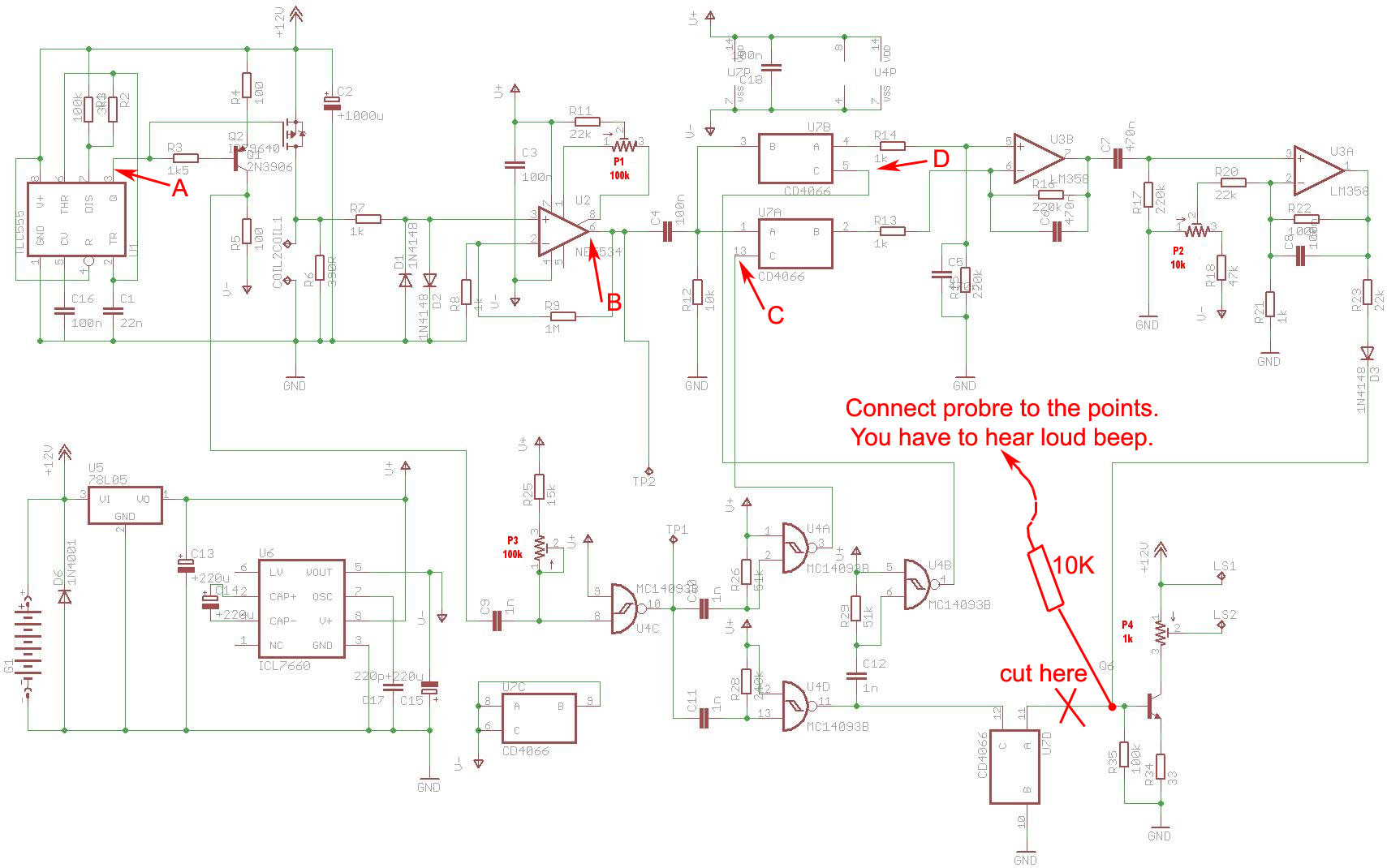

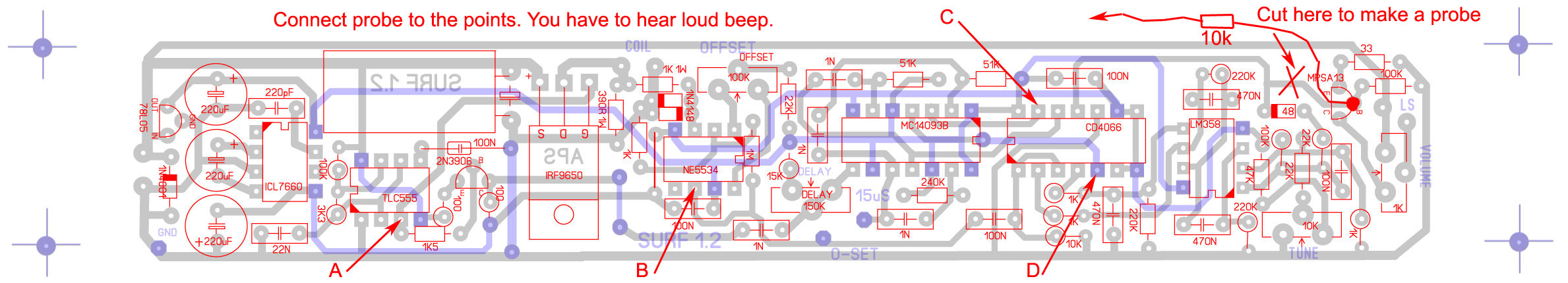

                              Also you can check impulses in some key points:
