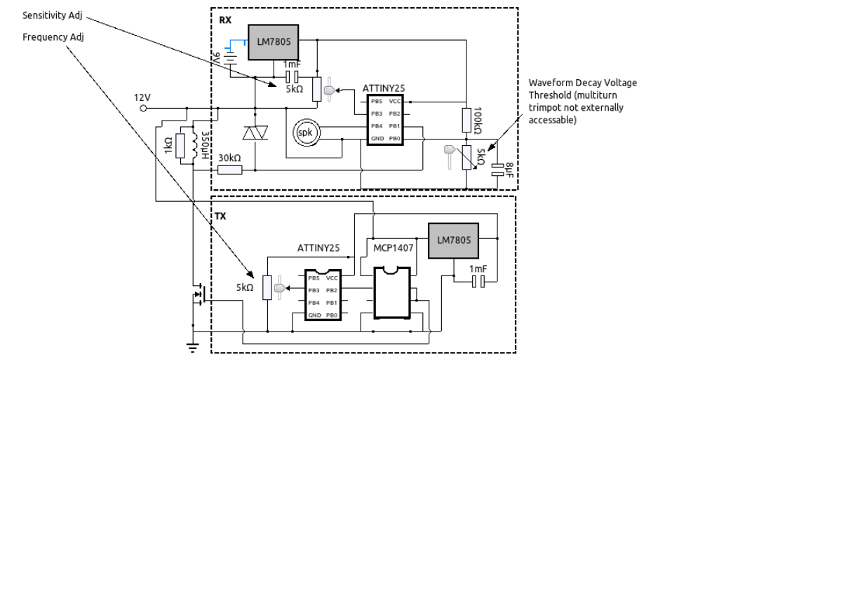

    hello everyone I have in the trouble with my PI metal detector which made by myself. My circuit board related information and my problems are described in a picture and you can get is in the attachment. My problem is that when i supply the power to my board, i found that the falling signal transforms to MOSFET drive chip(TC4420) by the micro-controller disturbed by unknown signal form my board and the flyback signal generated by the board is not right.
    I am very looking forward to your help,thank you!

              Hi Lou,
              You will need to amplify the signal before you will see anything on the oscilloscope. Try with a gain of about 50. You might get a signal that has a peak of about 1v.

                Thank you for your reply, I will test it with an amplifier to amplify the signal. but i still confused that the signal produced by my circuit board whether ii right or not.
                I have refer to the circuit diagram, in his diagram there is no amplifier come consequently after the signal produced by the coil. And I found the video the signal is very good generate by his circuit board. This is a link to the paper described how to make a PI metal detector http://www.miymd.com/index.php/projects/tpimd/ , and video link is http://www.miymd.com/files/3113/0305...1_0820_776.mp4. The circuit diagram is Click image for larger version
