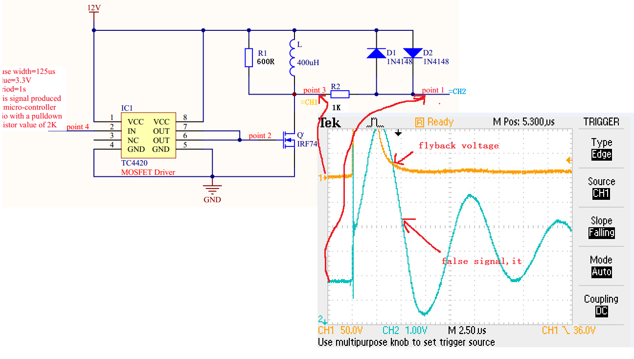

    i have encountered some problem with my pi metal detector, my goal is to use a micro-controller to control a MOSFET driver which in association with a N-MOS so that the MCU can control the N-MOS indirectly.
    the waveform I have captured is shown in the attachment Click image for larger version
ID:	368639 , form my point of view, the two Diodes will clip the flyback voltage between -+0.7 v , unfortunately, the result is differ far from my excepted (in the picture the channel 2 of the oscilloscope is connected to the point 1), I have checked the Diodes and resistances, they are all in good state.Have somebody have encountered this problem I mentioned above yet. I need your help and technical assistance.
    Thank you very much.Regards.

    Try a lower value resistor for R1, around 400 ohms and see what happens. Also reduce the TX to under 100us.

      I add a capacitance whose value of 470uF between 12v and GND, and there is a little improve to this problem.
      I thank that the power source cannot supply enough circuit to my test board upon the micro-controller switch on the MOSFET. Am I right?

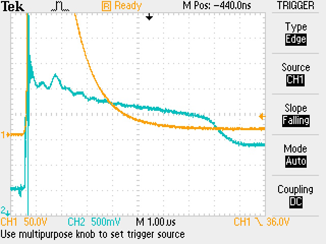

      This is a waveform picture I have captured from oscilloscope. I wounder whether it is right or wrong?

        use 2200uf or higher and like I suggested reduce the TX to less than 100us.
          how can I calculate the value of the dumping resistance? what is relationship between the dumping resistance with the coil? And what width the pulse can I use to get high performance? Have it an accurate formula which is used to calculate these related parameter mentioned above ?
          thank you!
            R_damp_eq = VDSmax_Mos / IL_peak
            R_damp_eq = 1/(1/R1)+(1/R2):
            in your case
            VDSmax_Mos(IRF740) = 400V
            IL_peak = 3A
            R2 = 1Kohm
            suggested R1(effective damping resistor) = 150 To 160 ohm

                The damping resistor is found by trial-and-error as it depends heavily on parasitic capacitances. Your first pic made no sense at all, I don't see any way you got the waveform on 'point 1'. The second pic looks normal.
