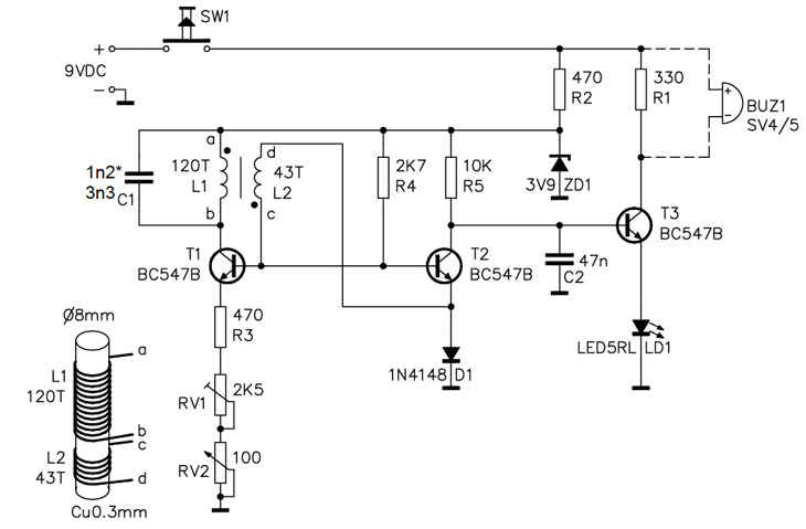

I need Help Correction My Layout
I Make Pin pointer Layout Can Some One Check Error On This Layout
