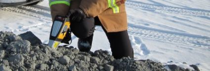

            Now exist equipment (based at XRF) for detecting gold (small size) in ores. I saw image with this equipment for quick analyze in work. And without lead boots. Click image for larger version

                    Main issue with portable XRF is relatively low energy X-ray used with very limited penetrating power. With even higher energy portable units, millimeters at best in any dense medium, otherwise almost just surface. Some sources use beryllium oxide exit windows, rays are unable to penetrate even thin glass wall. Isotopes are not better either, except if you use something really not recommended, like Co60.
                      From 3 types of radiation (alpha, beta and gamma) gamma radiation have largest penetration ability. Layer of concrete with thickness 16 cm can decrease gamma radiation in 10 times. And water with thickness 33 cm decrease in 10 times . Therefore this type XRF spectroscope can detect gold in large distance (<= 20 cm) .
                        Not that simple at all. In XRF there is big difference between penetrating power of incident beam and detection depth. Penetrating power also varies slightly with beam energy (that is, wavelength, not intensity) and material type, so not all gamma will decrease equally. For example, Co60 decay (I mentioned, highly not recommended to be anywhere near it) produce gamma of around 1.2-1.3 MeV, (this is HUGE!), compared to XRF energies of ten's of KeV at best (small dental X-ray produce more). At this energy, HVL (half value layer, thickness to reduce radiation by half) in concrete is around 5cm, so after 10cm it will be 1\4, after 15cm 1\8 etc (so, at this energy 16cm concrete will attenuate radiation 10 times). Ra226 decay produce, for example, around 186KeV gamma, HVL is around 2cm, co 16cm concrete will attenuate it some 250x. At around 50KeV, HVL is around 4mm, so attenuation in 16cm concrete is around 1000 billion times. You can find exact numerical data and how to calculate, for different energies, materials etc. Concrete density is around 2.35, for soil typically 1.7.
                        Now, even worst part: XRF characteristic emission lines for gold are centered around 10KeV for L, and 70KeV for K transitions. At these wavelengths gold will “fluoresce” in X-ray light, and spectra emitted is used for identification. Even with K lines excited with high enough incident energy, HVL is some 5mm. Usually, L lines are used. I'm lazy to search and calculate values now, but not millimeters, more like less than millimeter is what you can expect. Keep in mind, no use of too high energy and large penetration power of incident radiation, this may be good to X-ray something, inspect welds, or asses health of some three, by measuring it's density etc. Even if you can excite fluorescence at larger depth, you wont be able to detect it, no use of that, actually large amount of secondary photons scattered around will jam your detector so you probably won't able to see anything.
