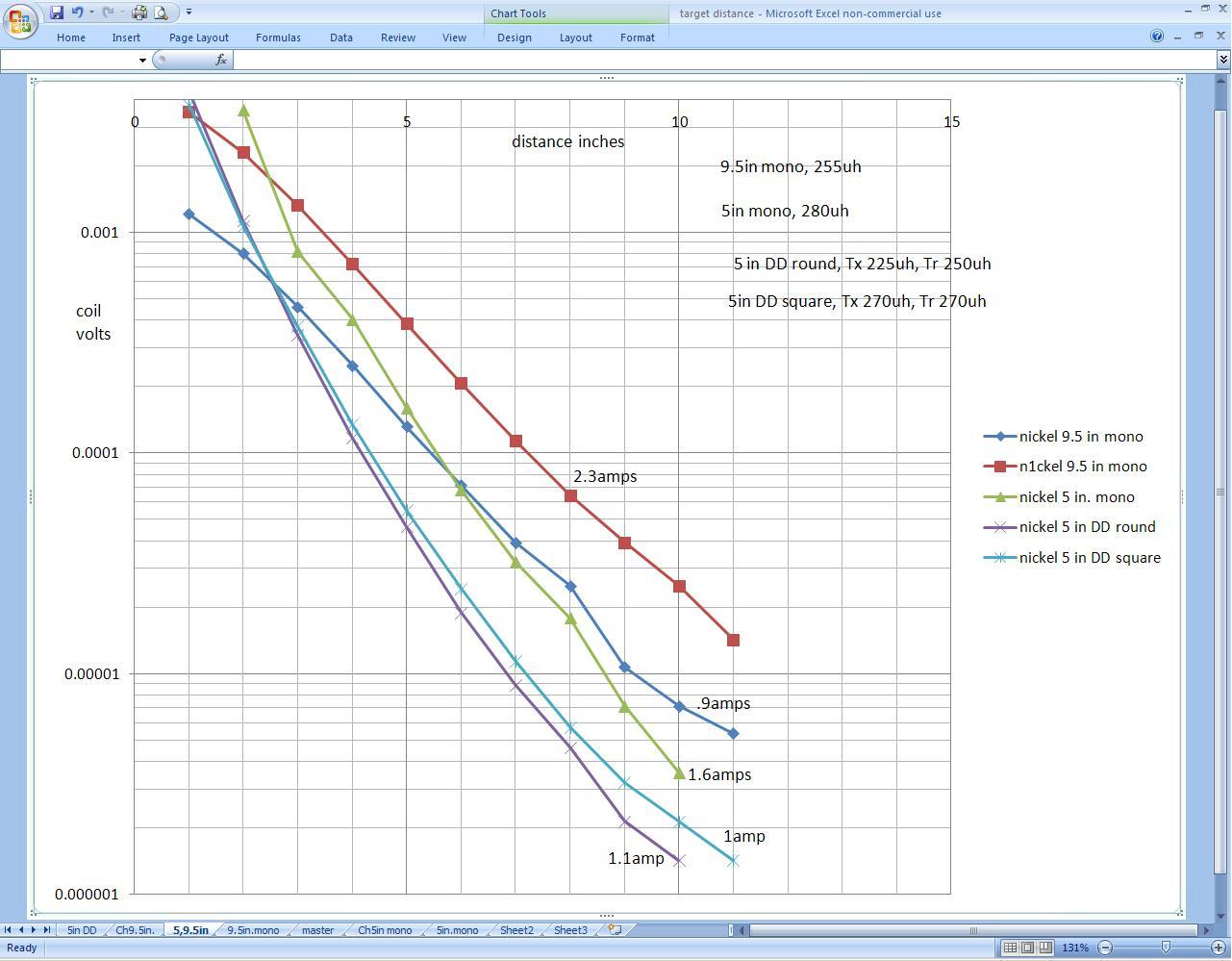

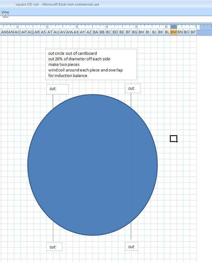

    I added two more coils to the comparison chart. I've wondered if the effective diameter of a DD coil was the larger diameter or the narrower width. I used some coils that I wound in the past so they don't match as close as I would like, but I think the trend might be correct. The DD coils had less noise when I made the measurements. The square coil isn't really square. A picture is included. Except for noise I don't see a lot of difference between any of the 5 inch coils measuring on the bench. There might be a difference in use, cancelling ground, etc. Curios if the plot make sense.

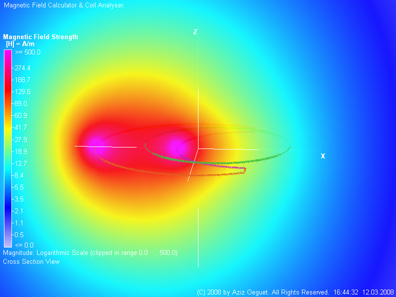

          • #80
            "WM6-coin1.jpg" must be lost here. Anyway.
            I have the picture:
            Aziz
