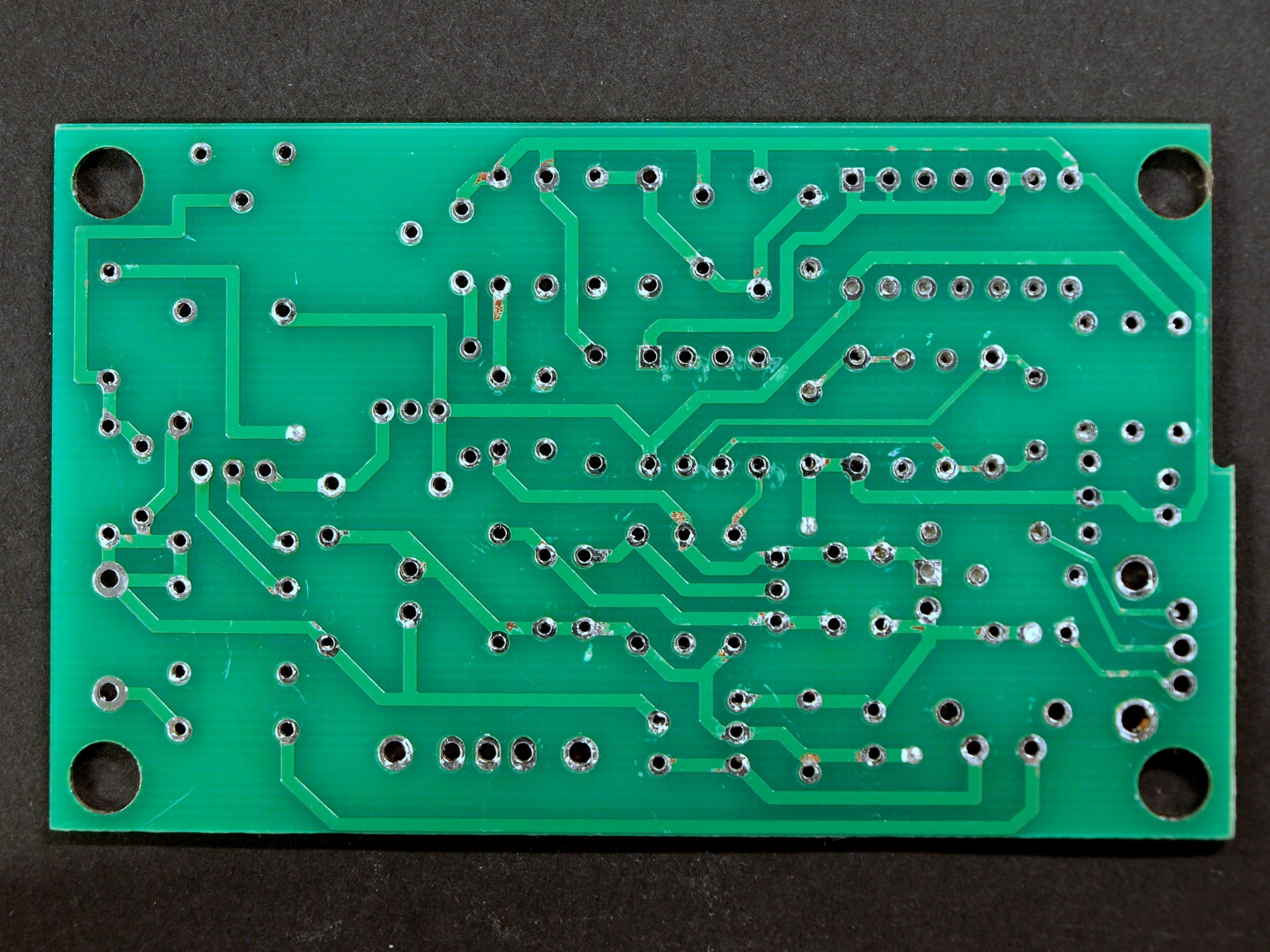

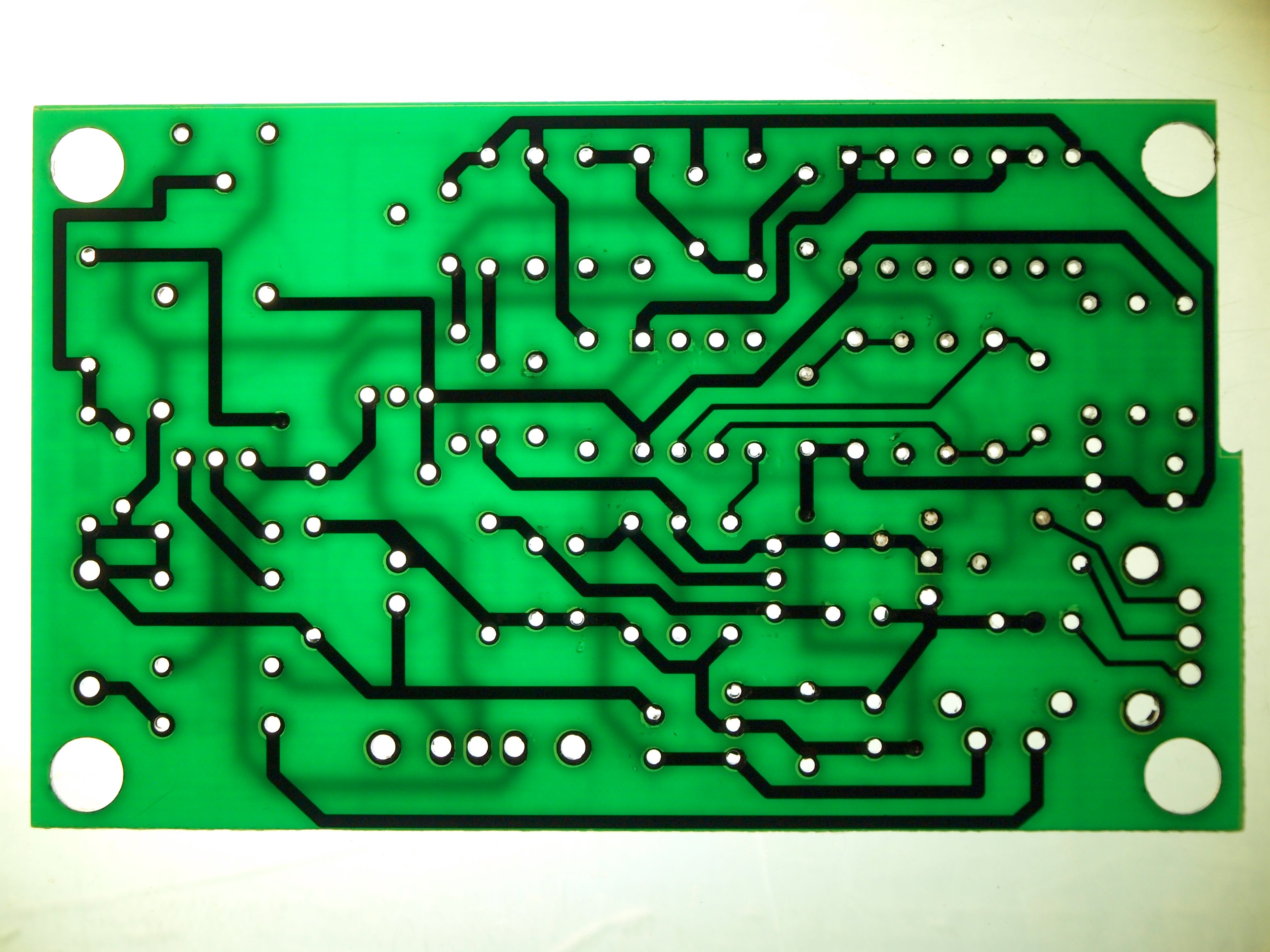

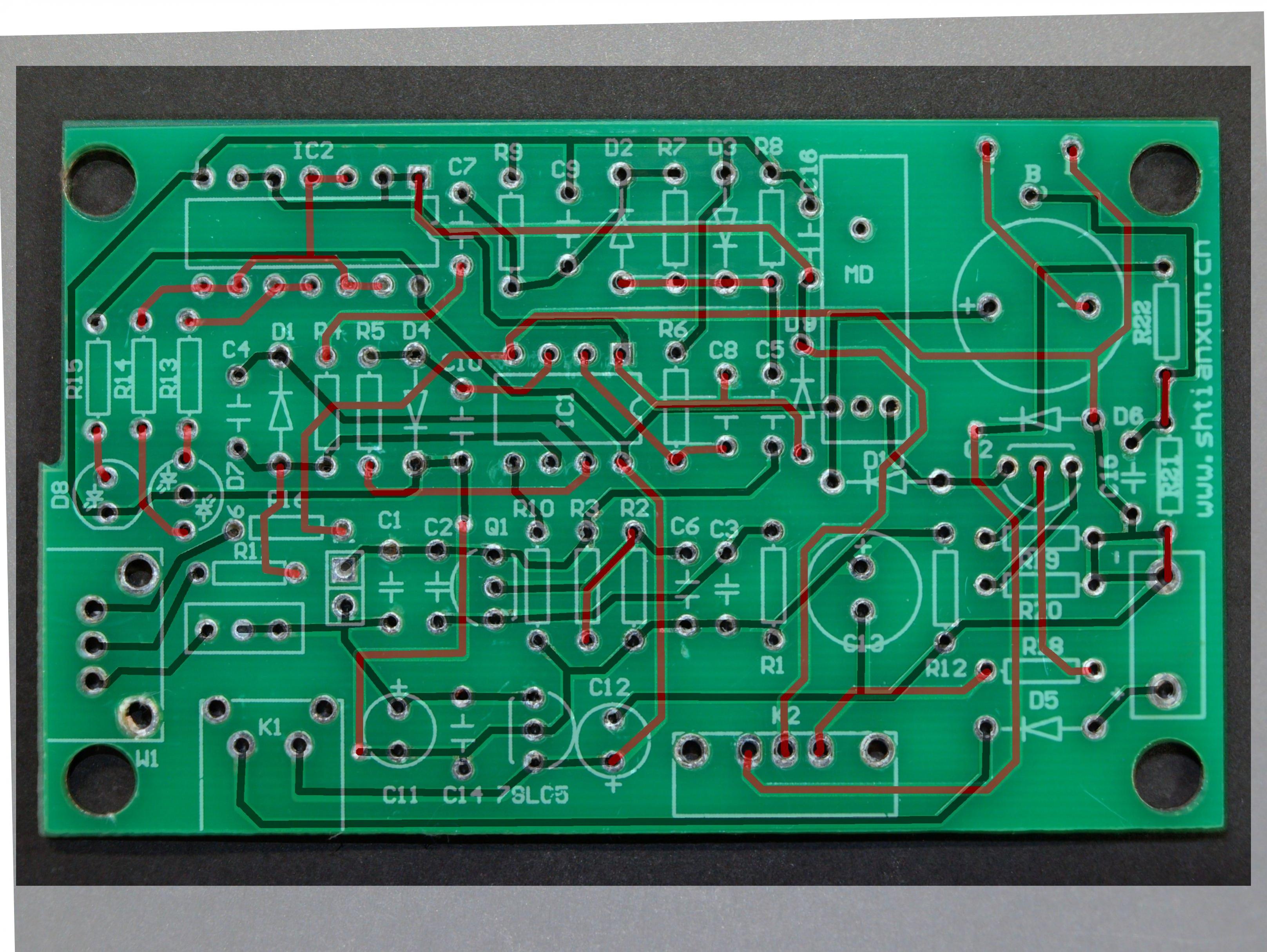

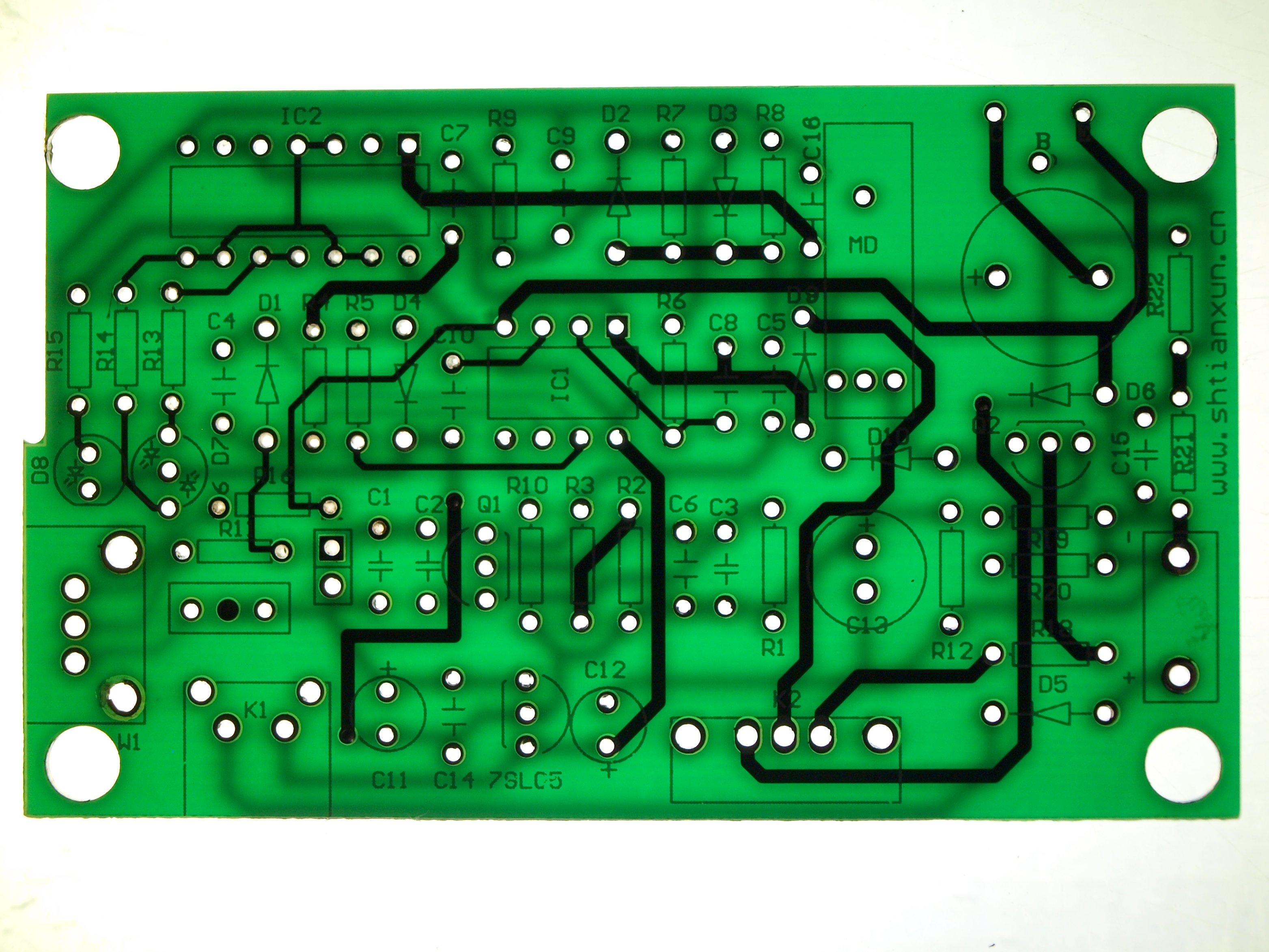

    Backlighting really shows up thin tracks well.
    There is no need to backlight the board. As long as you have a clear image of both sides, you can use GIMP to flip the rear view, place it on a second layer, and allow it to show through by changing the opacity of the top layer.

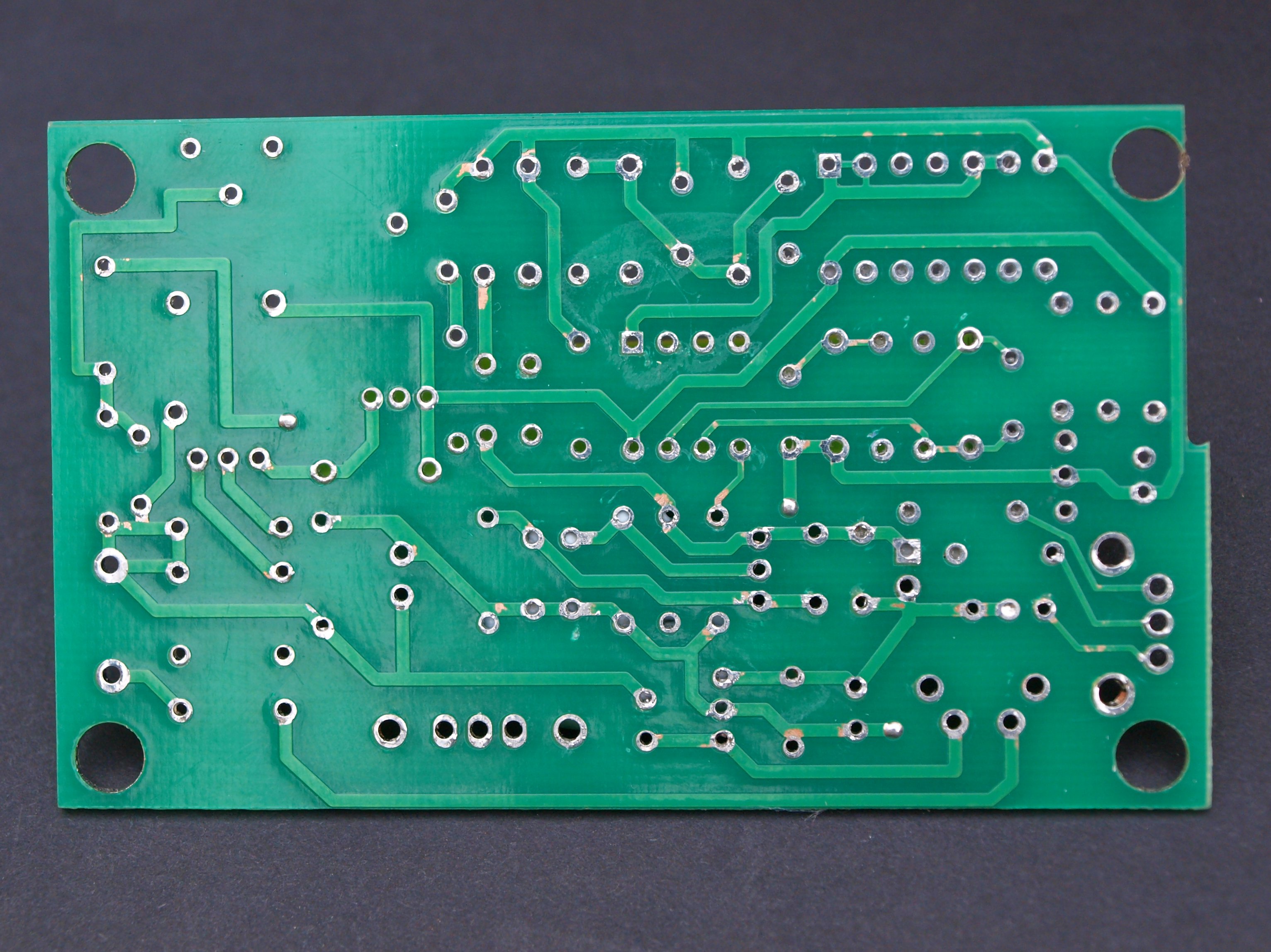

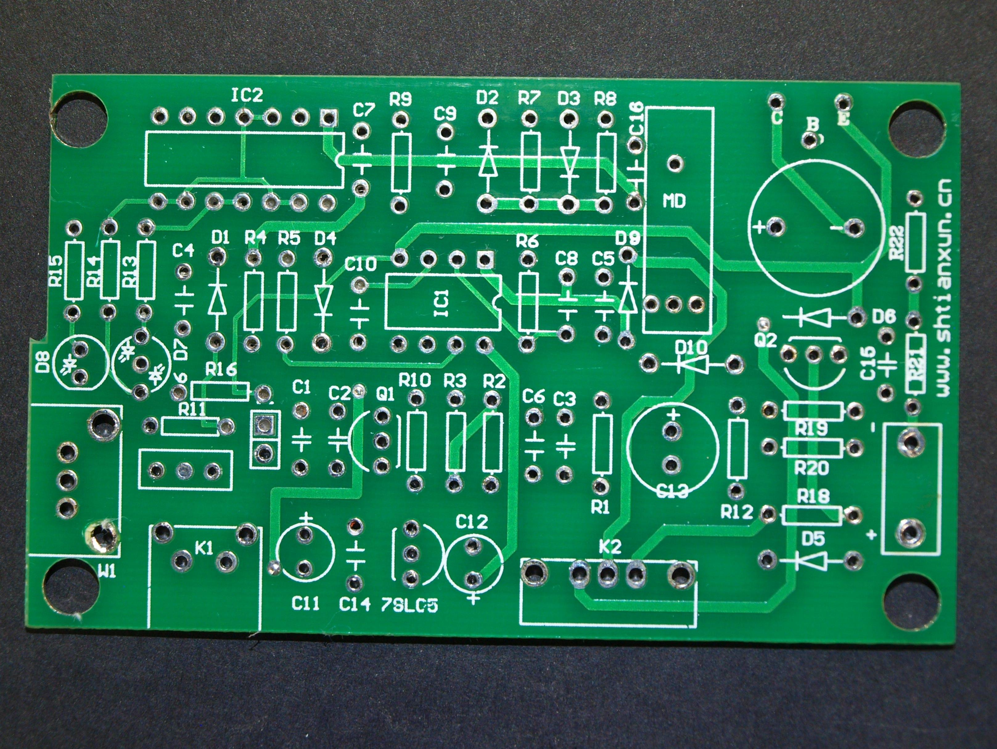

      Bare board images.
      Here are three sets of images. The first pair is done as you wanted (outdoors under open sky), the second pair is under studio lighting (controlled lighting with minimal glare) and the last pair is back lit. Use whichever your suits you.
      I think that now covers the four steps below the project needs from me.
      "1. board with components pics in hi resolution at sunny day at open air.
      2. desoldered board. pics in hi resolution, of both sides, at sunny day.
      3. full part list. every components must be measured individually, not via color code only looking.
      4. all transistors must be researched by haracteriograph, or tested on matter they are PNP or NPN structure of."
      Let me know if not, as I'll put the board back together otherwise.

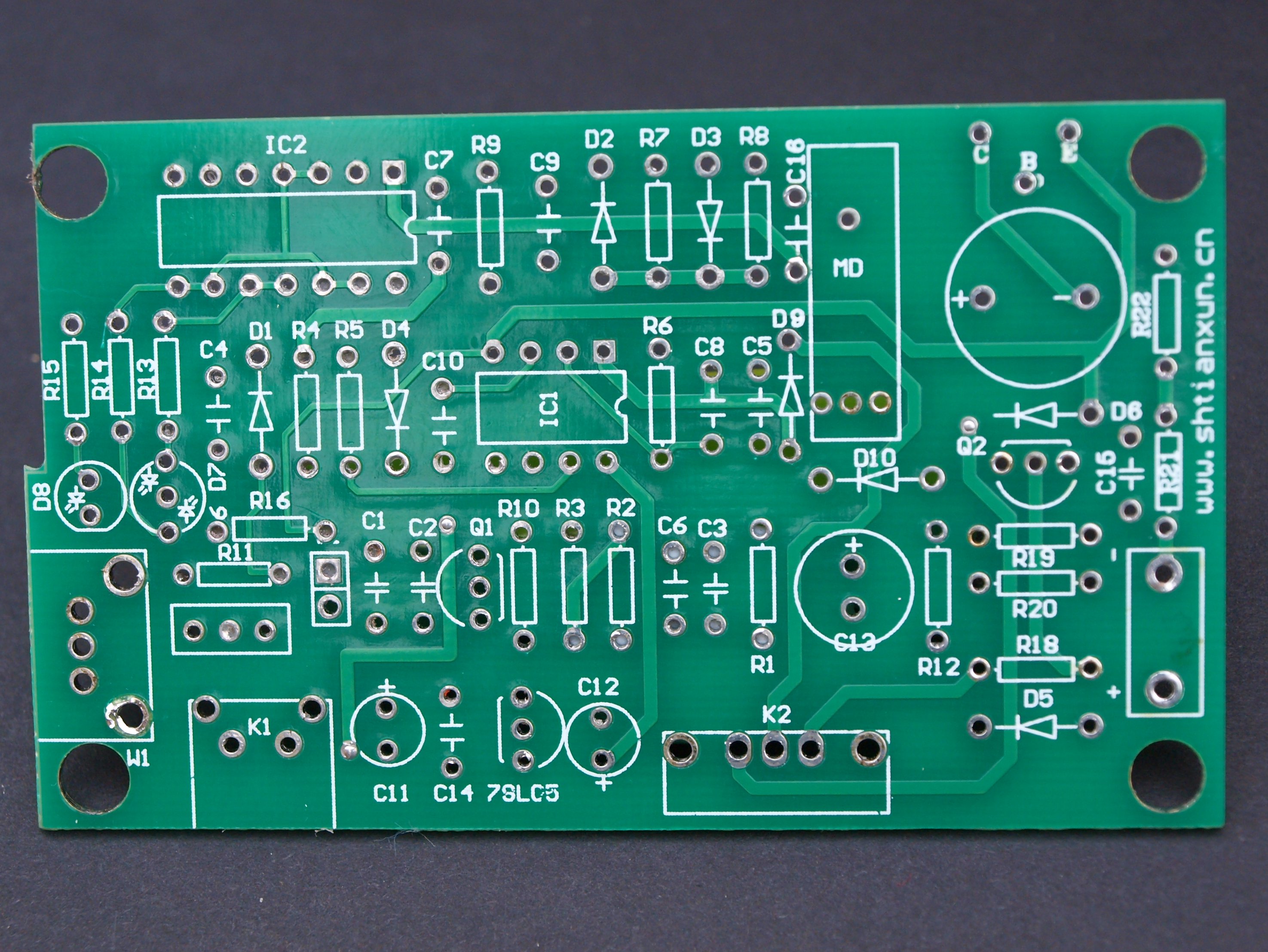

      I'm very curious to see the schematic and see what the heck is supposed to be going on...
      Cheers,
      Martin
      PS. The tracks from D9 back to itself via pin1 of both IC's are interesting
      (unless I'm wrong).

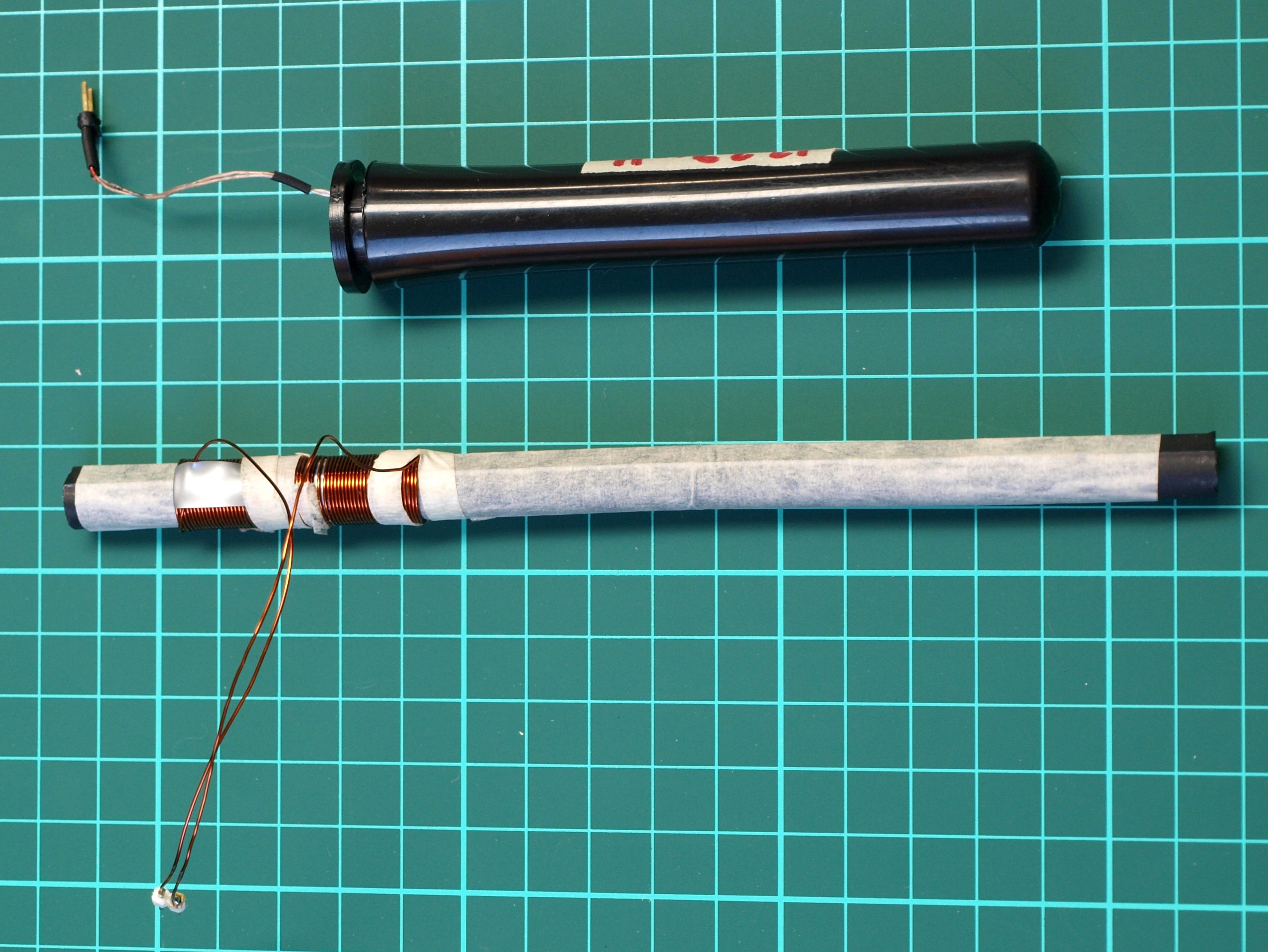

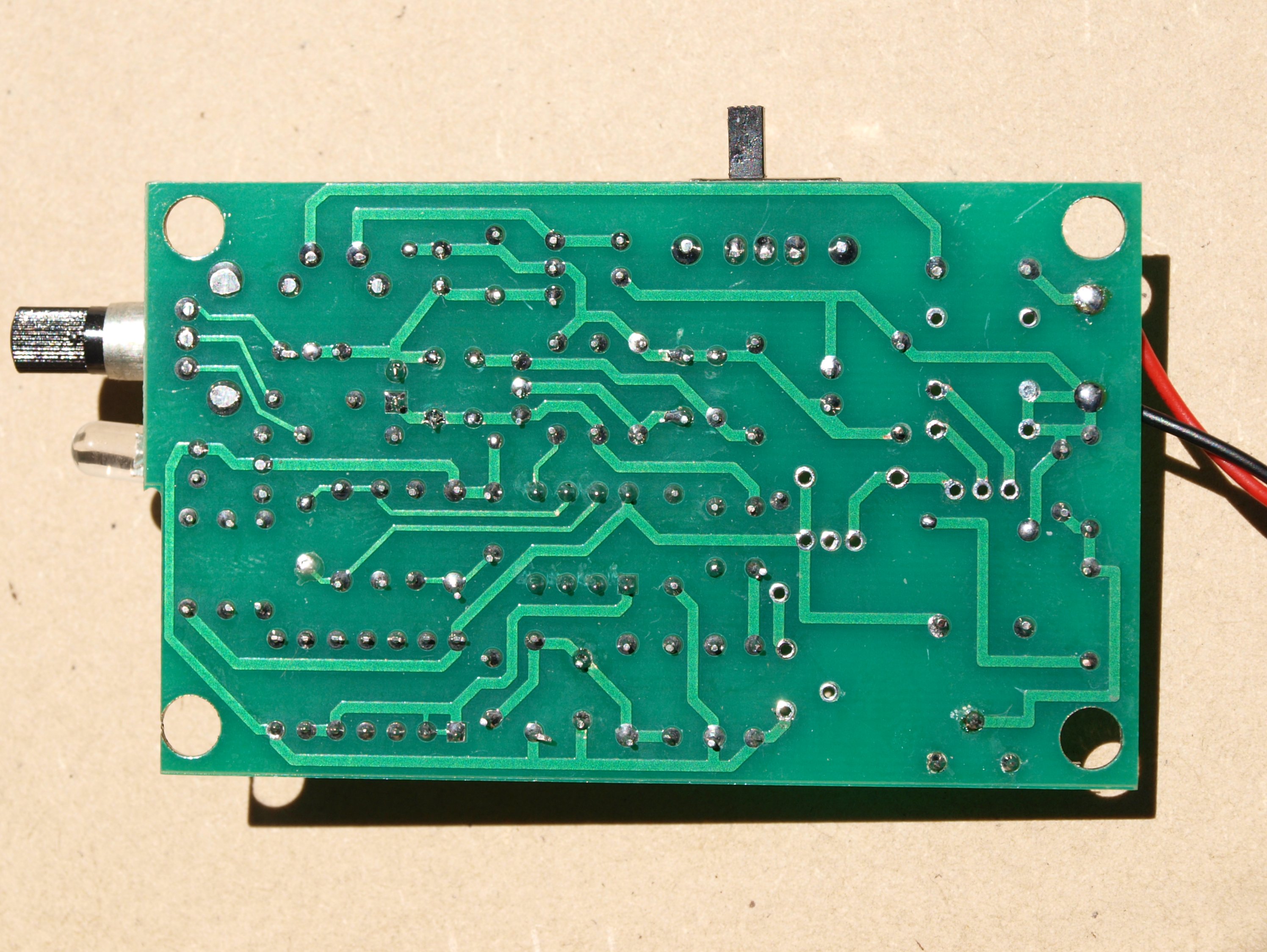

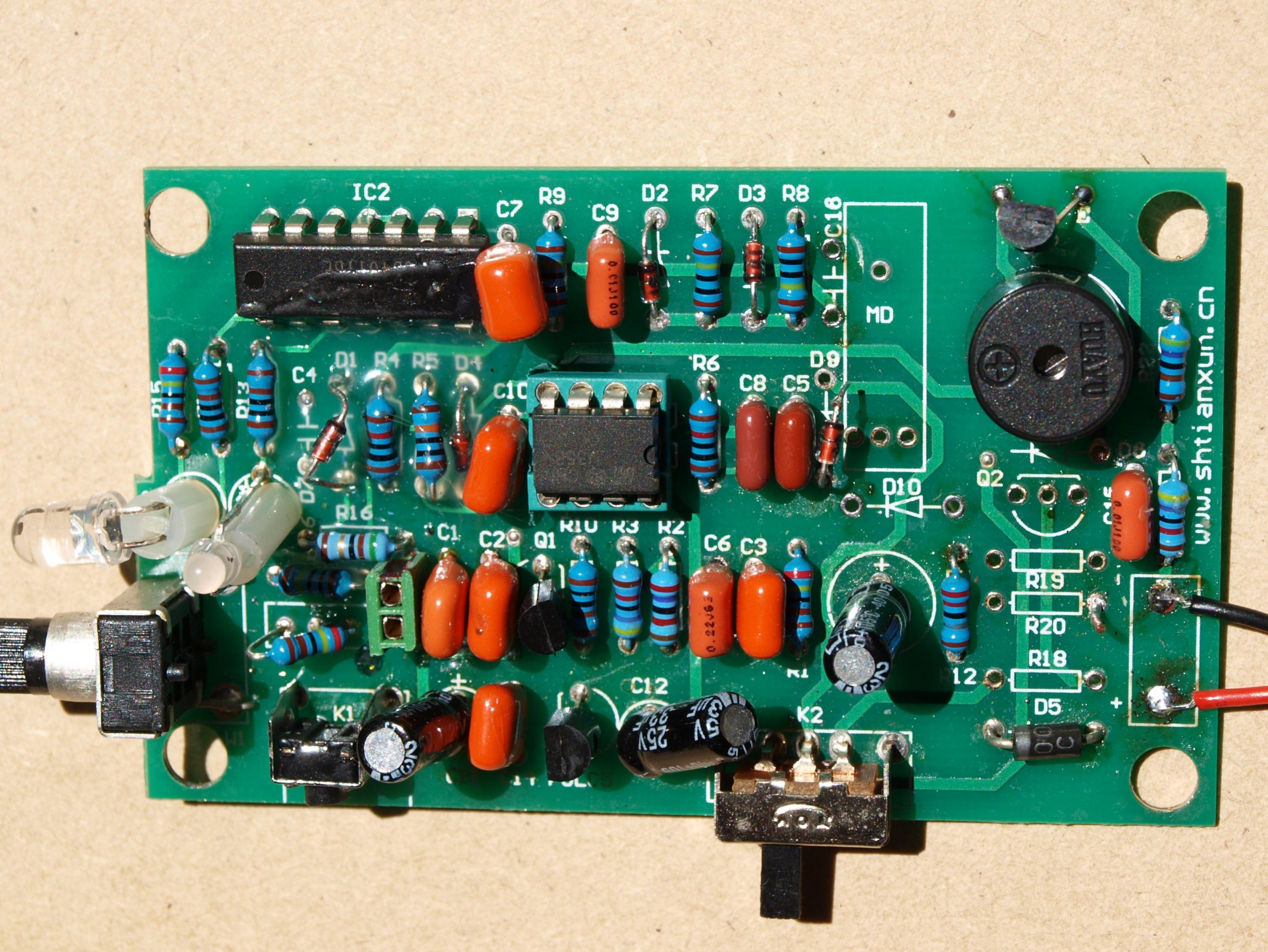

        Oh yes, I nearly forgot. I took additional populated board shots in case the ones I posted on day one were not good enough. Plus there is a shot of my last testing ferrite coil winding (that worked best).
        Martin
          Can you post up a saved GIMP image of this technique when you do it, be nice to see what a pro can do with GIMP.

                    Originally posted by mr.sneezy View Post
                    Wow, impressive given the short amount of time. Yes, you have some missing tracks, but tomorrow (late) you will have HiRes images of the top and bottom faces of the bare board.
                    I have a plan to use a light table to backlight the bare board as well as do a regular image of each side. Backlighting really shows up thin tracks well.
                    Please see the final draft of the Parts List, as there are a few corrections in it now, plus 'as measured' values as all parts were removed tonight.
                        Martin
                        OK - here it is.
                        • #42
                          OK - here it is.
                          Very nice work, that make following the tracks very easy.

                            PS. I intend to see if I can melt the glue around the OEM coil in boiling water and see if I can slip it out, but that will be middle of next week.

                              Be aware that on Qiaozhi's merged picture that the unmarked rectangular component above K1 was fitted with a normal axial resistor (2k4). It might have been for a trim pot originally me thinks.
