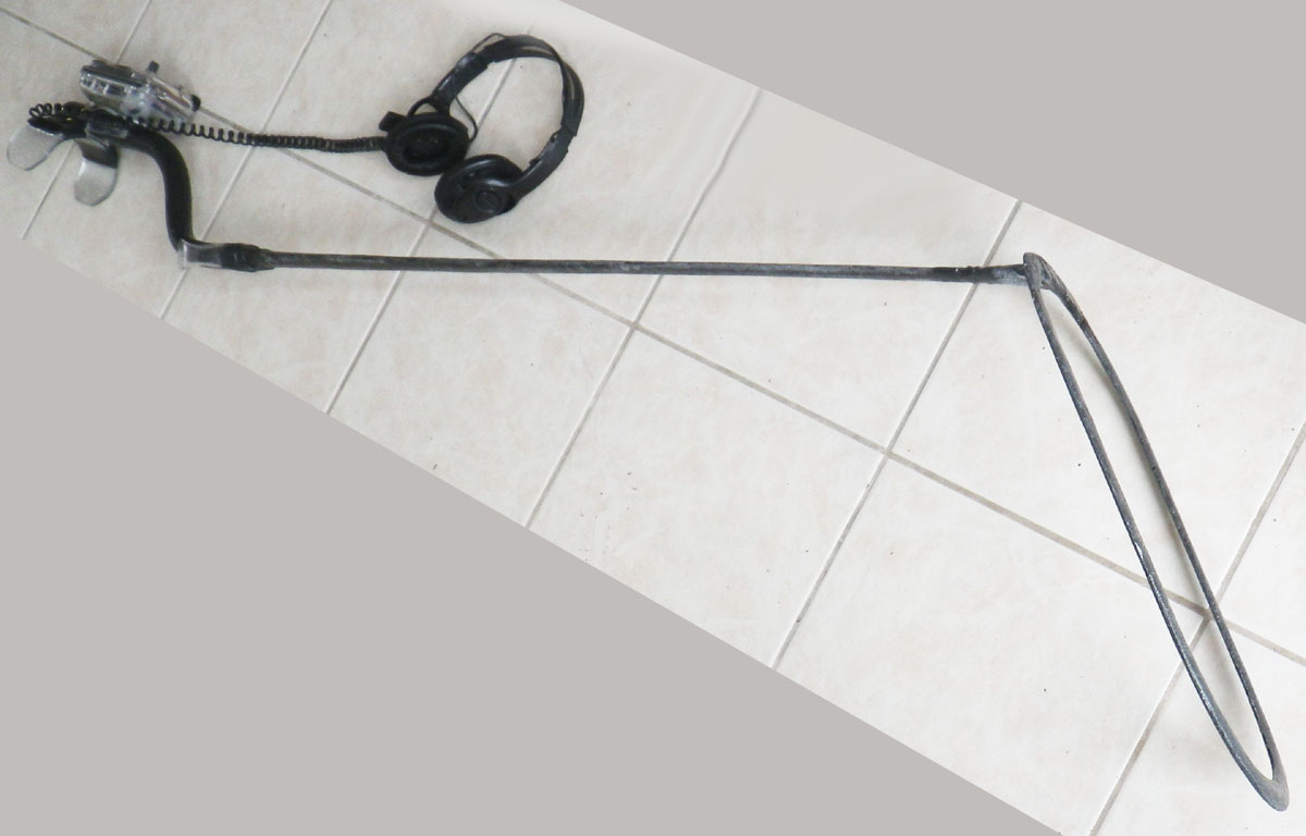

                Hi WS
                What shape do you make your 17" coils for your PI ?
                  Hi WS
                  17" x 9.5" rectangular with round ends.
                  Good for pinpointing and covering 100% area because my steps approx. 17"
                  Also hydrodynamic shape hepls me to move it in water without drag.
                  18 turns gives 300uH
                    Thanks WS, it it covered in fibreglass ?
                      [ATTACH]28209[/ATTACH]
                      thats probably the most impressive home made coil i have ever seen,
                        Molded in fiberglass, all edges are sharp to cut water like fish.
                          Thanks!

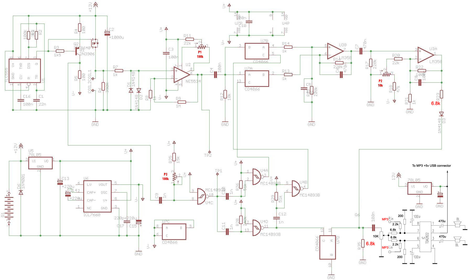

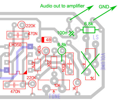

                          Total weight of my detector 1450 gram without headphones.
                          Also it has MP3 music player inside mixing sound with detector signals. So I am listening to the music in the background when detecting. Sure target signal several times louder than music.
                          And I have installed waterproof LED light into headphones for night hunt. It turns on by magnet (Reed switch on handle).
                          Detector, player and light powered from same set of rechargeable Li-Ion batteries.

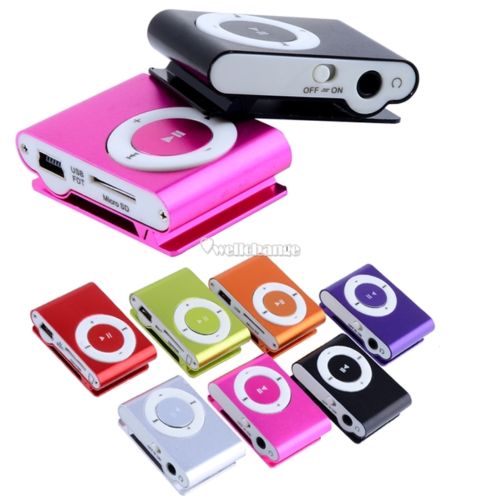

Name:	$2.33 MP3 PLAYER FROM EBAY Supports 8GB Micro SD card.JPG

                          Disassemble player and remove Li-Ion battery. Player will work from +5V to his USB connector from same source as audio amplifier TDA2822.
                          That simple, $2.33, microscopic size player needs no adjustments or pressing any buttons to start playing so it will turn on when you turning on your detector. Just that simple!
                          Also changing music by changing Micro SD (TF) card is very convenient.
                          Enjoy!!!
                            Thats a very novel idea, that should be included in all MD's
                              It was idea of my wife. She always listening music when detecting. But after she sunken couple of MP3 player in ocean I have started to embedding them into detectors waterproofed cases.
