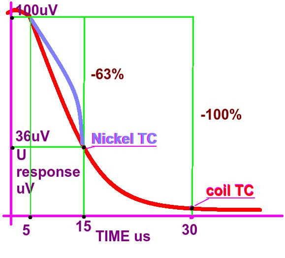

    Time constant of targets, TCDifferent metals have different TC’s. Even different alloys of metals have different TC’s. Jewelry gold comes in hundreds of different alloys, each with a different TC.The shape of the targets, even of similar alloy, also generates a response of different TC’s. Yet, it is our desire to get some kind of information of the kind of target under the coil, before we start digging. With VLF detectors, the TC translates into a phase shift used to give some information about the target identity. Can we obtain something similar from a PI detector?Can we measure the TC of a target with a PI?The time constant (TC) of a Nickel is about 15us. This means that having a response signal of 100uV at a time, say 5us after the switch Off of the TX pulse, the signal will be 63.2uV less, at a time 15us later. (Actually there are ways to stretch the time we can measure short TC’s or shorten the time of long TC’s, but we leave that for later)However, the signal that we look at, is composed of the coil decay and the target decay, so to get some sense of our measurement, we must first measure the coil decay only, without target, and then subtract this number from our total signal. This TC is made up of several TC’s. The largest partial TC is from the skin eddy currents. Then there are eddy currents from a deeper level within the coin. The amplitude of the skin eddy currents is much affected by the surface area presented to the magnetic field lines of the coil. With the coin at an angle, the surface is less so the response amplitude is less. Taking only a single measurement of the target response amplitude gives us no information about the quality of the target.As we can see from the above,we need to take at least 3 measurements at different times to define the TC of a target.There are several different ways to obtain a lot more information about the targets under a PI coil. It would be time well spent discussing these possibilities.

    Please check at my Nickel TC drawing, if I understand your Nickel TC example correct.
    If yes, is it not more correct to say that Nickel TC is 10us (15-5) than 15us?

      Thank you for the nice graph. It helps explaining better than my words.
      Now measure the target signal response at time 30us again. You will find that it is again 63.2% less than at time 15us. This is what TC means.
      On your graph, you start measuring as soon as the opamp comes out of saturation. This is not a good spot, as the signal is still distorted by the saturation of the opamp.
      In real life PI circuit there are other limitations. We measure by sampling. Our sample may be anywhere from 1us to 40us wide. This means that we are averaging the voltage during this time. The shorter the sample time, the more sensitivity we get for short TC targets, but we also get more susceptibility to HF noise. We counteract this by stacking or averaging many samples.

          Sorry about the discrepancy and thank you for correcting. It has been many years since I measured the TC Nickel, I just used a random number to explain what the TC of a target is.
