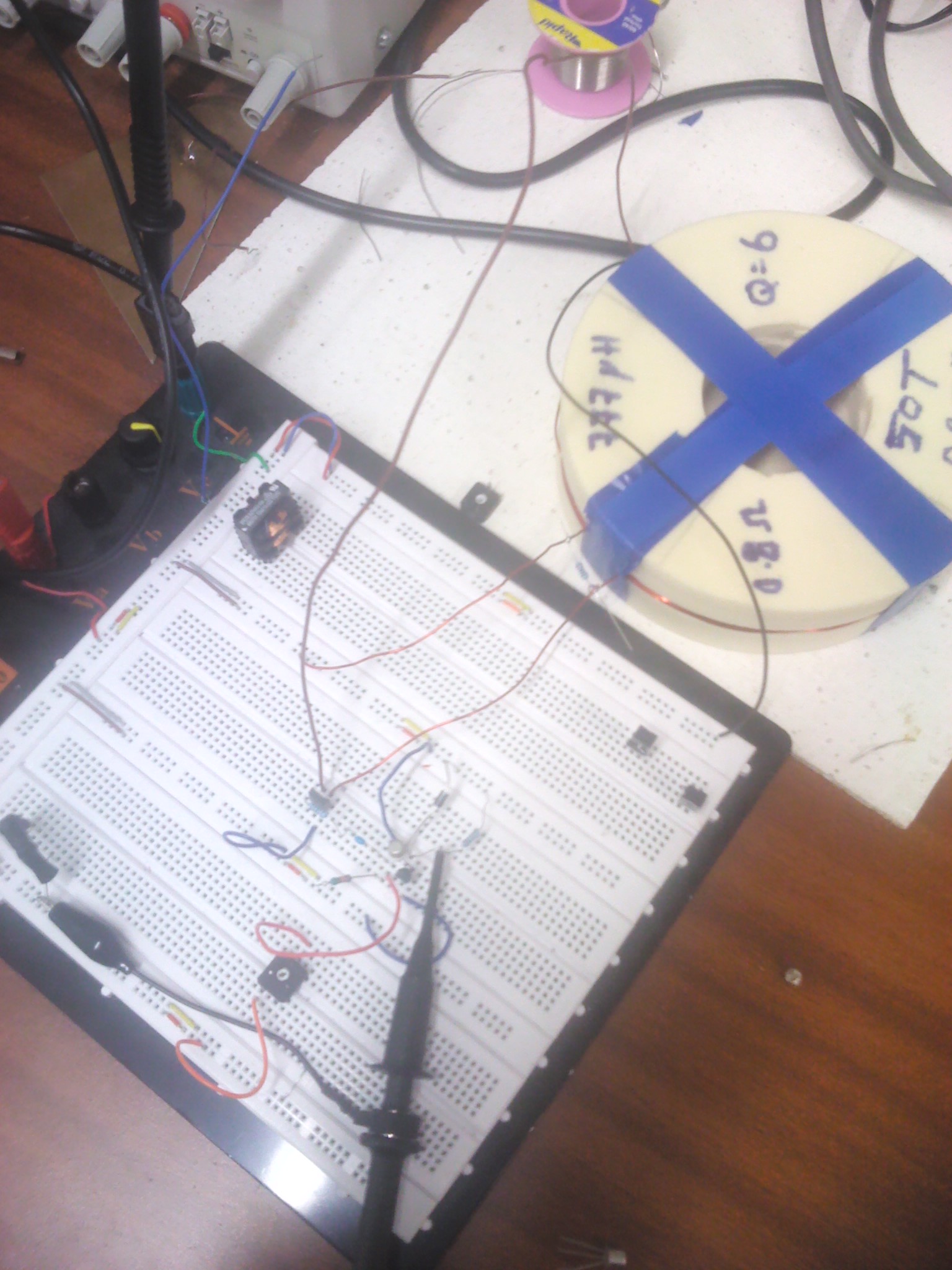

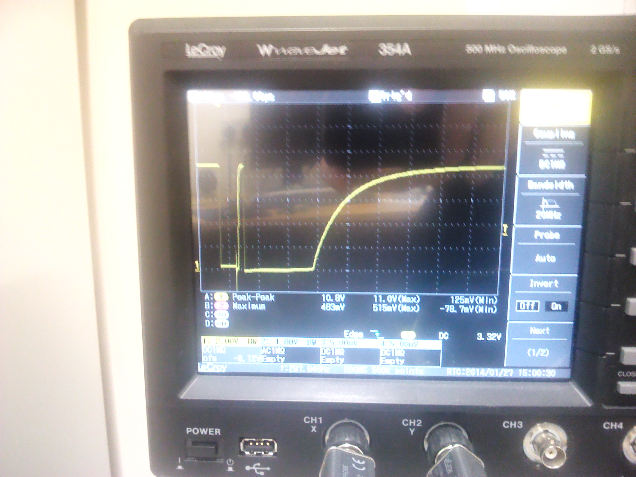

    Well, the front end works, just like SPICE said it would...
    The version I've built uses the coil I made, which is larger than the one used in the Russian Simple Pi posts so the biasing resistors needed tweaking, a 5k pot in place of the 3.3K resistor did the job in seconds.

      Good to see it working!
      Scope shows coil is ringing. Looks like internal capacitance of coil is too high as well as dumping resistor.
      To lower that interwire capacitance you can make better coil from stranded wire (solid wire acts like target) with thick insulation (Teflon) or use spacers (polyethylene) or flat spiral shape of coil or basket shape.
      Usually coils for such setups has 200-300uH. I see 777uH and 50 turns. I think 20-22 turns probably will be OK. Also dumping resistor may needs adjustment (lowering) to stop that oscillation.
        Yes, the coil creates problems for the transistors too because it is loaded too easy and the input impedance of the first stage is not that high.
        I will make myself another smaller coil soon, just need to make another foam disc to roll it on. It would be nice to find some way of winding a decent spiral pancake.

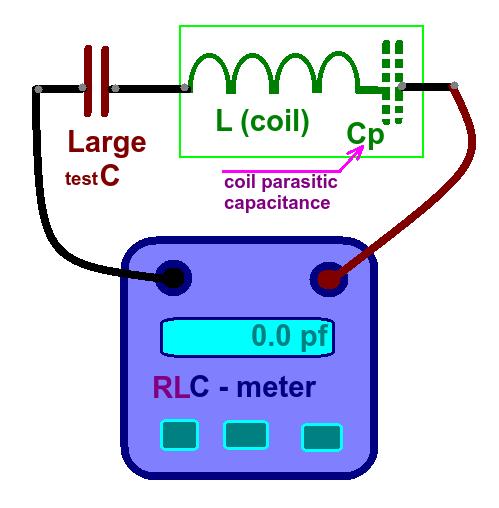

                                If I understand you correctly, your (L) coil parasitic C measurement proposal is as this on drawing:
                                Going to practically speaking:
                                I done some test. In this test mono coil of 2mH (27cm dia) is used in series with large test capacitor of 390nF(according factory marking).
                                I tested in mentioned LC configuration accordance with the scheme of drawings and use a variety of measuring instruments from simple c meters to high precise RLC instruments.
                                Results:
                                A. Precise LC meter (f=630kHz) - 167pF
                                B. Precize RLC meter (f=120Hz) - 373nF
                                B. Precize RLC meter (f=1kHz) - 383nF
                                B. Precize RLC meter (f=10kHz) - 194nF
                                C. Couple other multimeters wit C range: results from 371nF to 432nF
                                Can you say from this what is parasitic capacitance of tested 2mH (27cm dia) coil?
