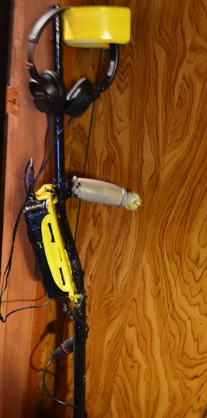

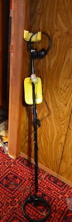

    After many moons, finally have a completed Surf PI. I need an external microphone for my camera, so cannot post video at this time. See still images below.
    Thanks to all those who helped me along, and to Andy of Silverdog for his assistance.

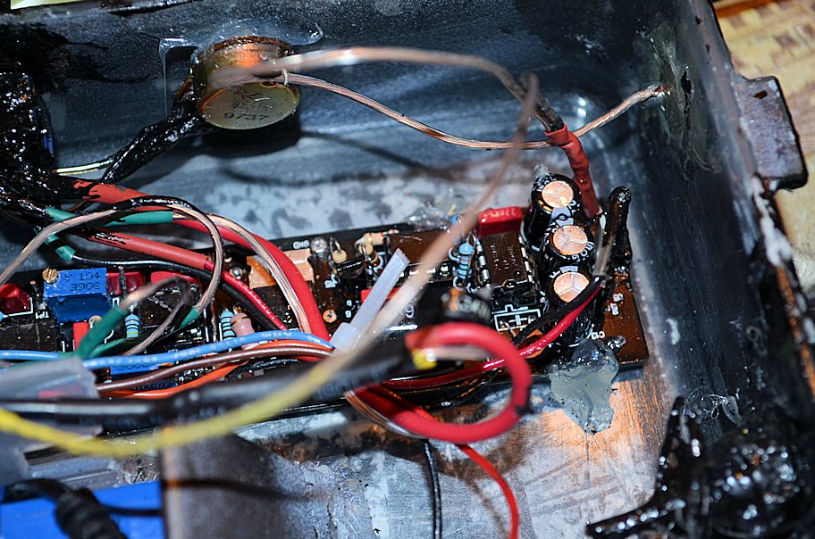

        I am on with building one of these, I have soldered all the components onto the board, I still have to fit the IC's (Was waiting until the very last thing before testing).

        I was/am going to mount the board using a hot glue gun and stick it to the box I waiting for, will this do?
        If I use an expoxy resin to seal the coil, will the heat from this as it is hardening ruin the coil?
          Hi Jason,
          No!
          You need to have the opportunity to dismantle the pcb out of the box.
          Imagine you need to change some capacitor, pcb glued ...
          Problems ...
          It depends on the insulator. Enamelled wire should survive...
            Oh Yes about the PCB, never thought of that, I need to come with another idea then as the PCB has no mounting holes and little room to create some, I might have to try and make "something" that is glued to the box that the PCB clips into it.
            Oh yeah I have another question, I used a flux and this is still visible, even after washing the PCB and drying it out, will that "Isoprobal alchohol" I think its called that, clean the flux off and where can I buy it from?
              Isopropil alchohol... Perhaps the pharmacy, diy store ...
              I use nitro thinner, and the first all good rub with a short brush, especially around the IC-s, then clean up with "ear stick"...
              Find a large package of cheap Chinese rough brushes and with scissors shorten hairs.
              When everything is clean and dry - layer "plasitc spray" to protect pcb.
              All this after the adjustment!
              Be sure to work on ventilated area without a lot of "sniffing" ...
                With the pcb, hot glue some wooden posts to the pcb, then glue the posts to the box.

                  its best to pack out the inside of the coil with polystyrene so you dont use too much resin otherwise the coil could be heavy !!! also use a slow cure epoxy resin taking about 24 hours to cure other wise if you use a fast cure then much heat is generated which can warp the coil shell badly !!!!
