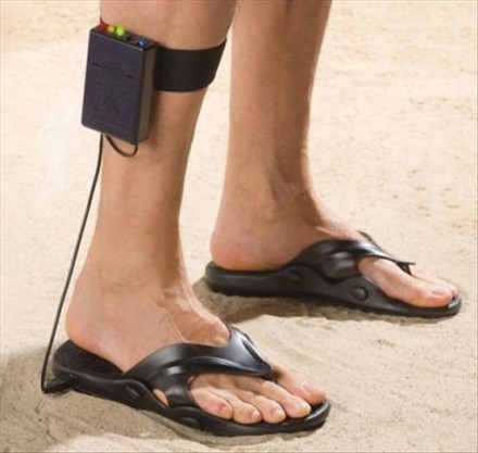

    hi davor, why not have something like a mono loop built into the heel of a shoe use a non motion design, then as you walk it detects, or maybe a small dd built into the sole, the detector could be the size of a ciggarete packet you could strap this to your ankle, if you ran the headphone lead up your leg you would not need wireless phones.
    a bit 1960's james bond but what the hell, i certainly think non motion is the way to go, the constant movements may look daft with motion mode.

ID:	339501 - it was in news few years ago.
      I guess box starts vibrating when slipper hits the target.
      Probably it is easy to hide monocoil, power supply and vibrator from cellphone into slipper. So nothing will show that it is MD inside.
      MD boots have to be patented and sold to military. Why not to warn and prevent army personnel from stepping on land mines by sound, vibration or electric discharge.
      Monocoil may works too. Also if RX and TX separated they have to be fixed mechanically or moving TX against RX will trigger false signals.

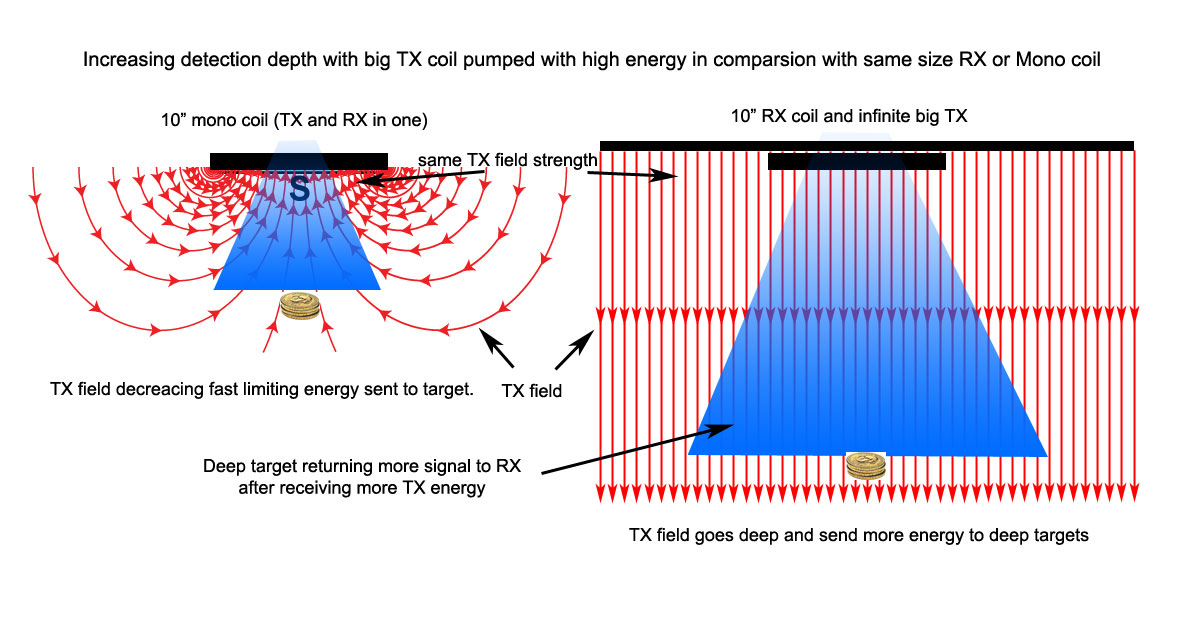

                      As a sidenote, this arrangement will make possible a huge single turn Tx loop of many meters in diameter to encompass an area I wish to examine in depth, and I mean real depth, so not only a concealed carry is on my mind

                          Significant Click image for larger version
ID:	339526 is expected with such configuration. Also you will need a powerful batteries or generator to power the TX.
                            Maybe not. I could go for an energy saving solution with Tx, and because I have a completely separated Rx coil, I can also sample earlier and recover some losses.
                              Lets roughly compare 20 turns coil with square 25 x 25 cm area with square 5 x 5 meter one loop TX.
                              Using "Tx loop of many meters in diameter" with same current and only one loop you will decrease magnetic field strength in
                              20 x 5 x 4 x 5 x 4 = 8000 times.
                              If you can better to hook it to your car battery to rise current and keep magnetic field up.
