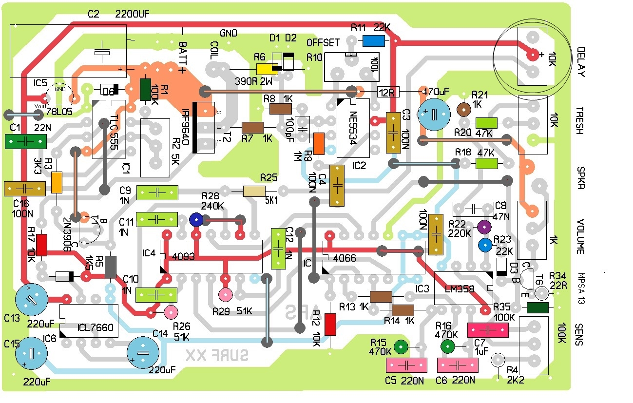

    r11 and r23 in my photo is not 22K resistors?it is wrong resistors?i find this resistors inside bag kit.
    r22 in silverdog partslist write 100K. http://www.silverdog.co.uk/shop/imag.../partslist.txt
    hi kalaka,
    no it are the correct resistors. I made a mistake. I received other 22K resistors with different color code.
      friends the problem solved!!i stuck again all parts and now work!!!
        Hi Silver Dollar. They are correct but are not needed. Silverdog has a lan between these two points on the PCB. Since the color of the whole PCB is the same the lan is hard to see but they are there. I also read in another post in this forum that those two jumpers are not needed.

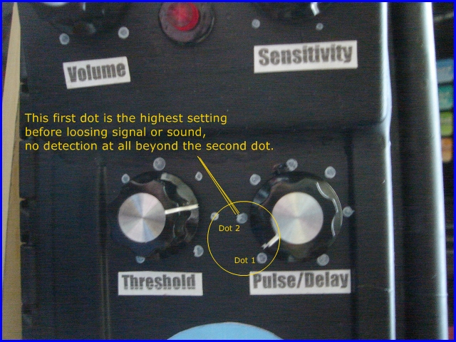

                        Hey kalaka, thanks for the useful info in this thread. Not trying to hijack your thread but I thought this was pertinent.
                        I have had similar issues with the pulse delay and wondered which was shortest and longest settings, thanks to porkluvr with his reply now I know for sure which direction is shortest (counterclockwise).
                        my issues are that trying to use any setting other than 100% counterclockwise, I get nothing, no detection whatsoever, down to less than 1 inch with a very very slow response and weaker signal if any.
                        What I'd like to know is how should the pulse delay actually be working, should it work full range or basically discriminate everything beyond 20% on the dial (moving clockwise) ?
                        Attached an image so you can see my setting, anything other than where it is set (100% counterclockwise) it is basically useless for anything including metal/iron.
                        Is there a fix or something I can change to make it more useful....?
                        Thanks for all the great advice here..
                          Have you ascertained that P3 is wired correctly?? CCW is less delay and CW is more delay??
                          edit: that statement was directed a kalaka and was made before I read geoscash1's post
                          IF you have no oscilloscope then you should carefully make sure that you have wired the pot correctly. I will not and can not hold your hand through that process. Naw, wait a minute.... IF you post pictures showing P3's wiring from the PCB somebody could probably figure it out.
                          Seriously, correct wiring of P3 needs to be a known fact if you are to diagnose this problem. Guesswork is not good enough.
                            Porkluvr, I'll have to assume you are replying to me, I went by what you mentioned in the previous page,
                            Quote: "I don't have Surf PI but I assume that it is normally for P3 would be wired so that clockwise) is shortest delay and CW is longest. If you must turn P3 CW to detect gold, I think maybe P3 is wired backwards because gold should be detected with the shortest delay selected"
                            My delay is wired correctly from what I see here in the forum, attached an image, pretty straight forward, but I can switch the wires and see what happens...
                            Thanks for the reply..
                              I see where kalaka (and you too) already posted some pictures. I'll have a look (but for crying out loud I am not paid enough for this aggravation.) ha ha
                                Sorry man for the frustration, I am frustrated too with a couple things on this particular board but at least it works when fully counter clockwise.... I just switched the wires and it made no difference
                                which way they were attached.. only 2 wires for delay on sm pro J Owens pcb..
