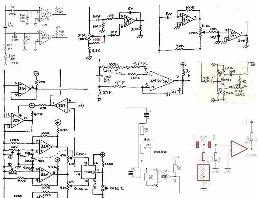

    There are 90, 120, 180 degree disc circuits. I want to make a switchable disc circuit
    so in trashy areas you can reduce the range.

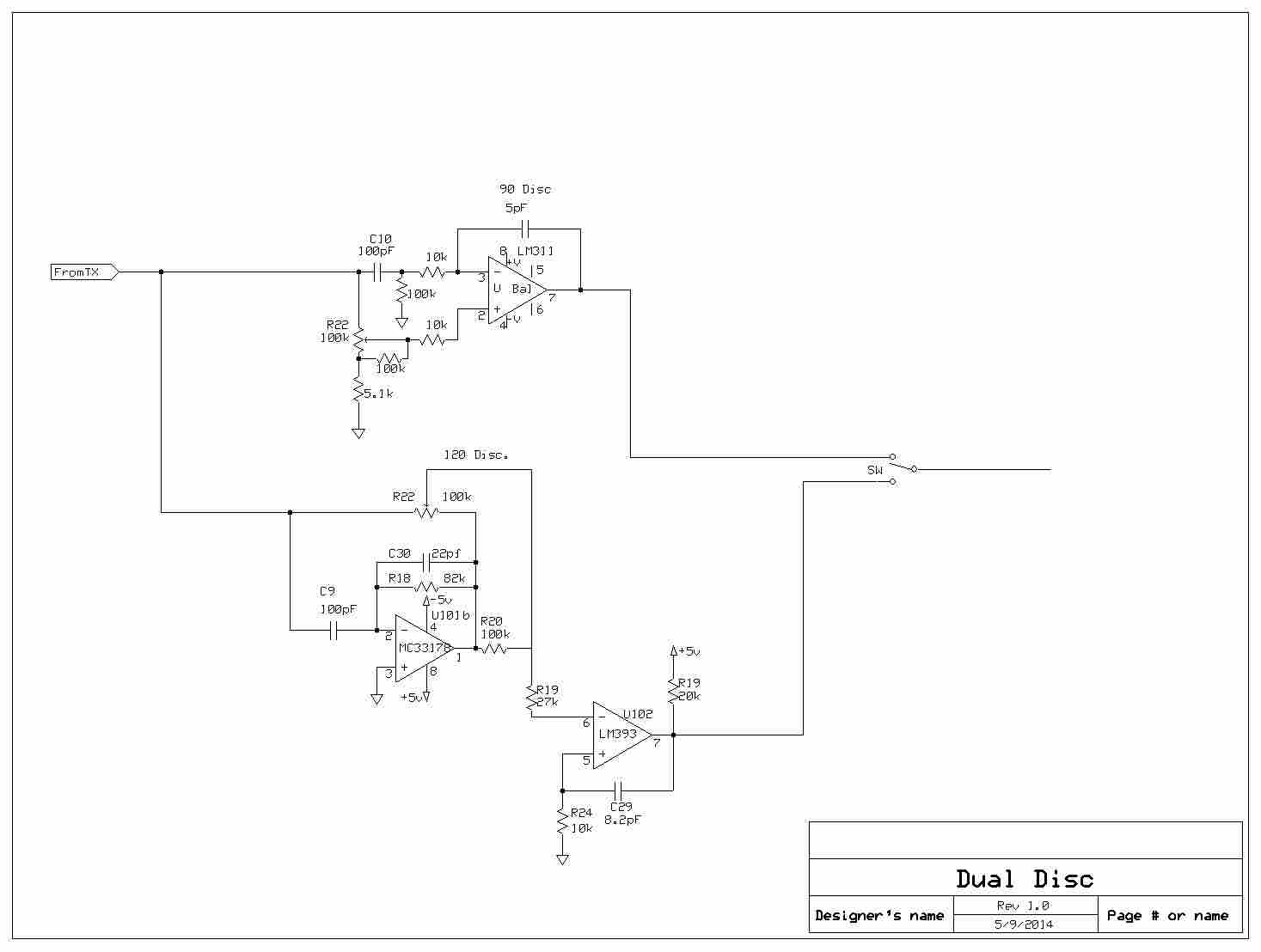

    I've collected a few different circuits but wonder if one could be designed to be easy
    to switch instead of using a whole circuit and switching the output;
    Disc's

    Circuit
    You could get a dual pot with pull switch and switch between ranges by pulling on the knob!
