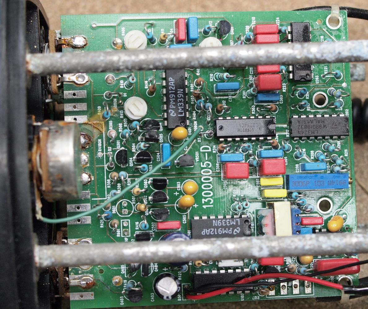

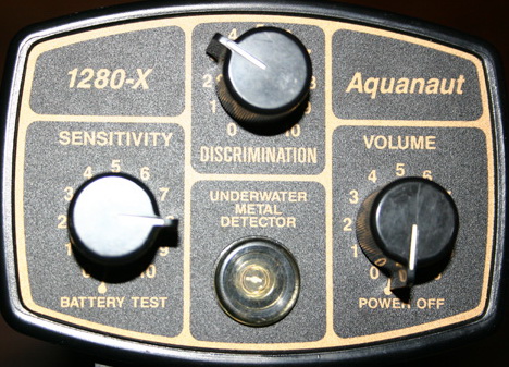

    Hi everybody !
    This my first message here.

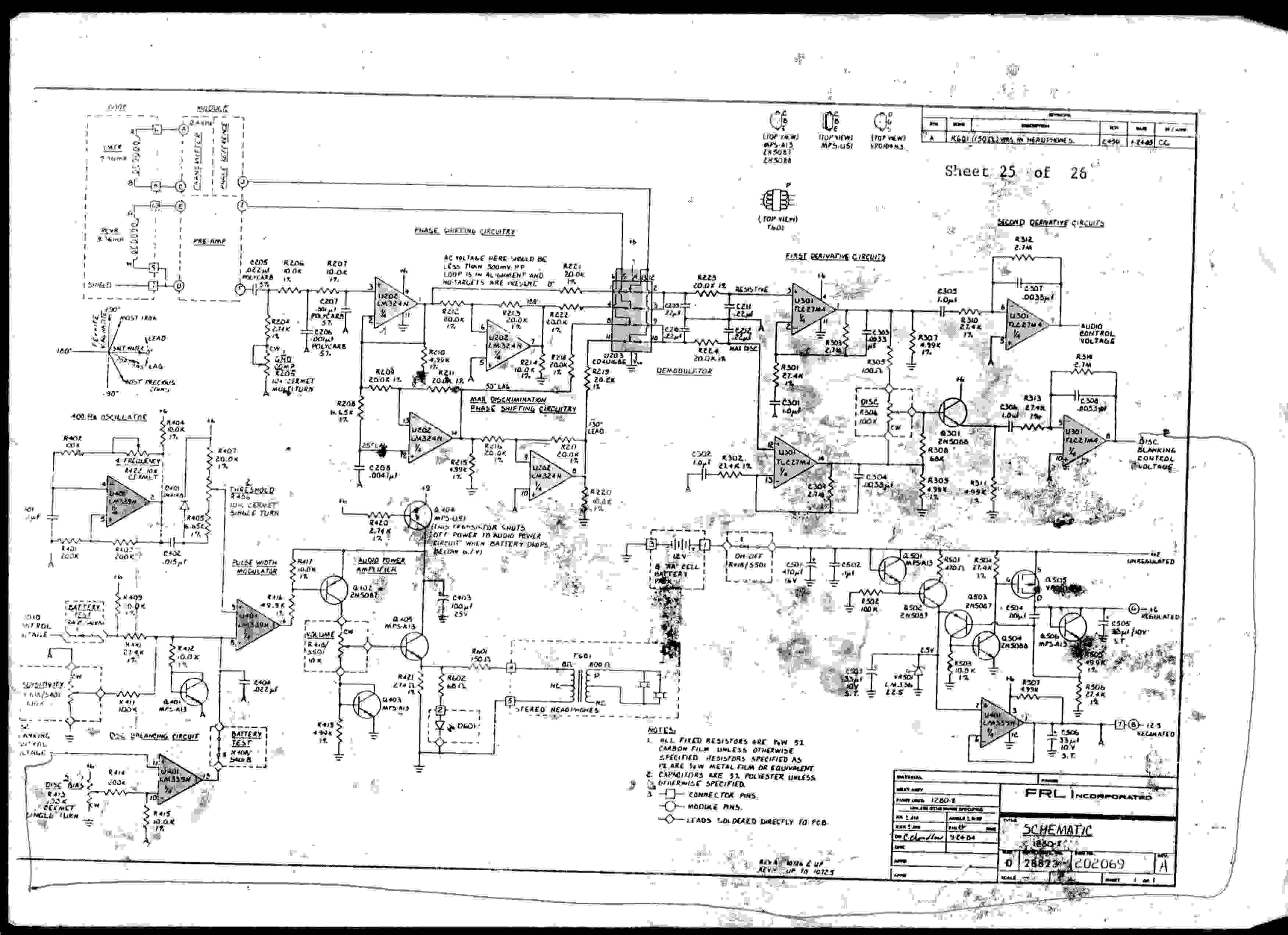

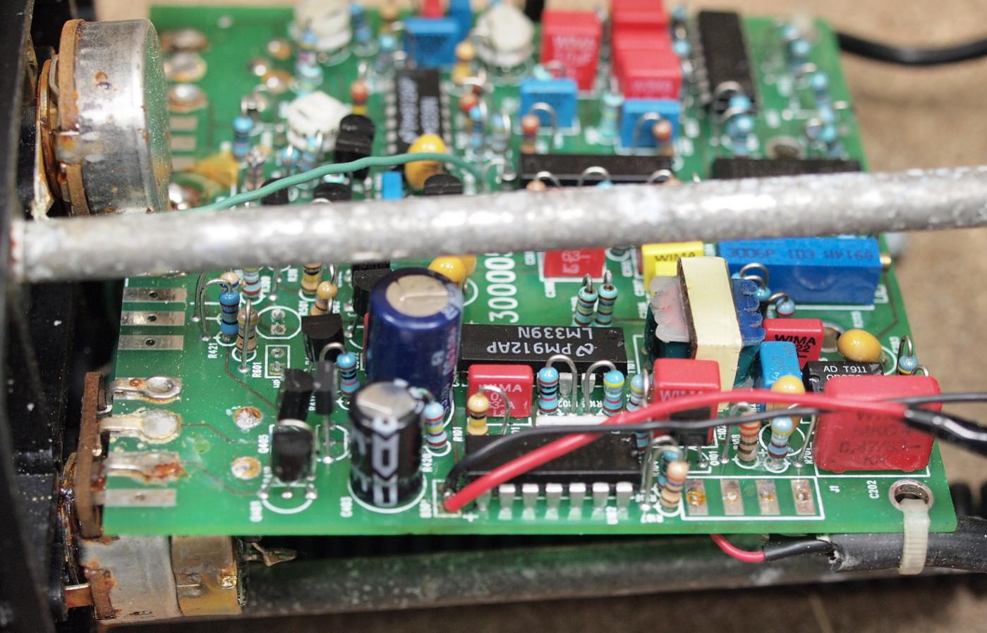

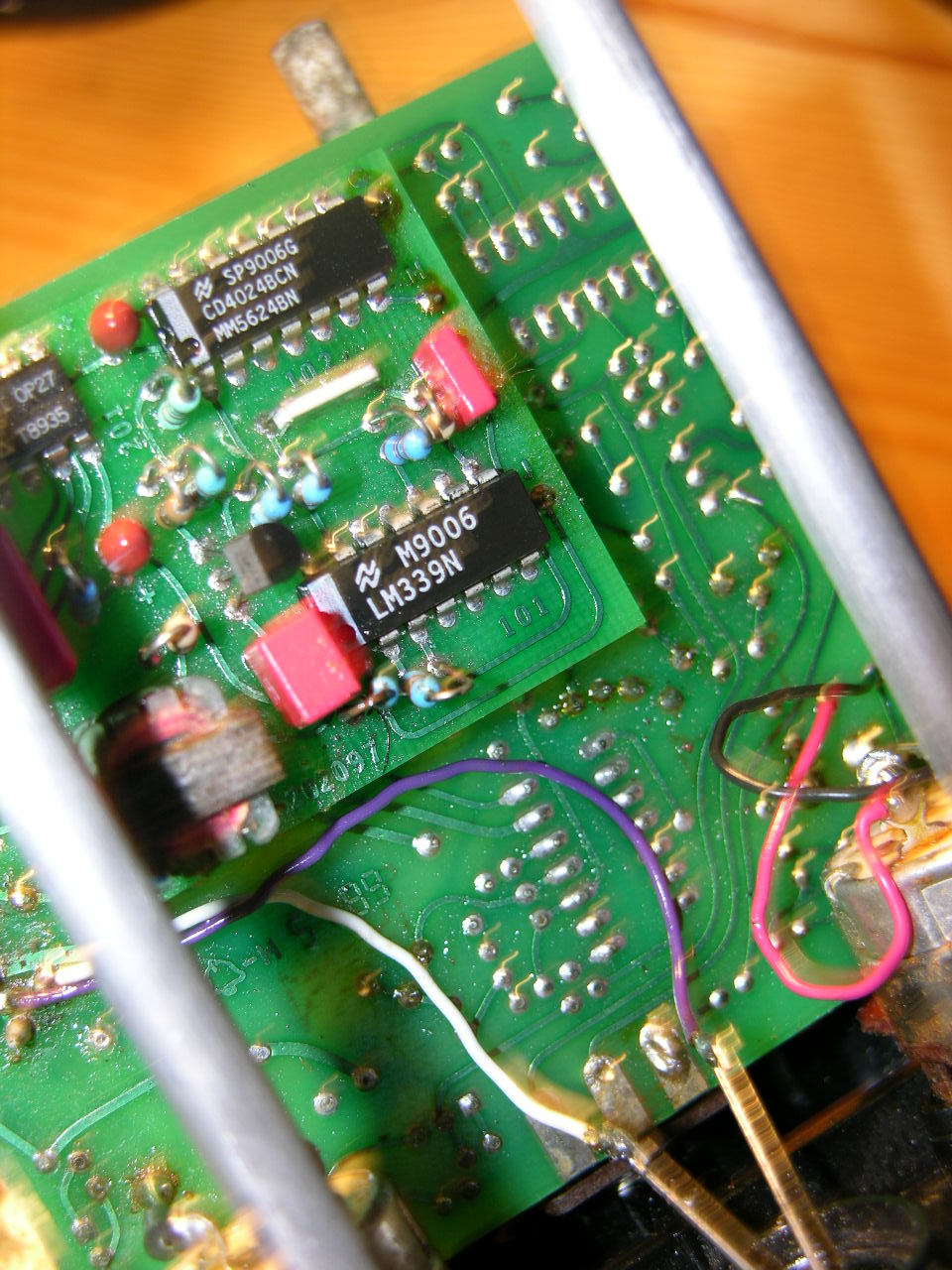

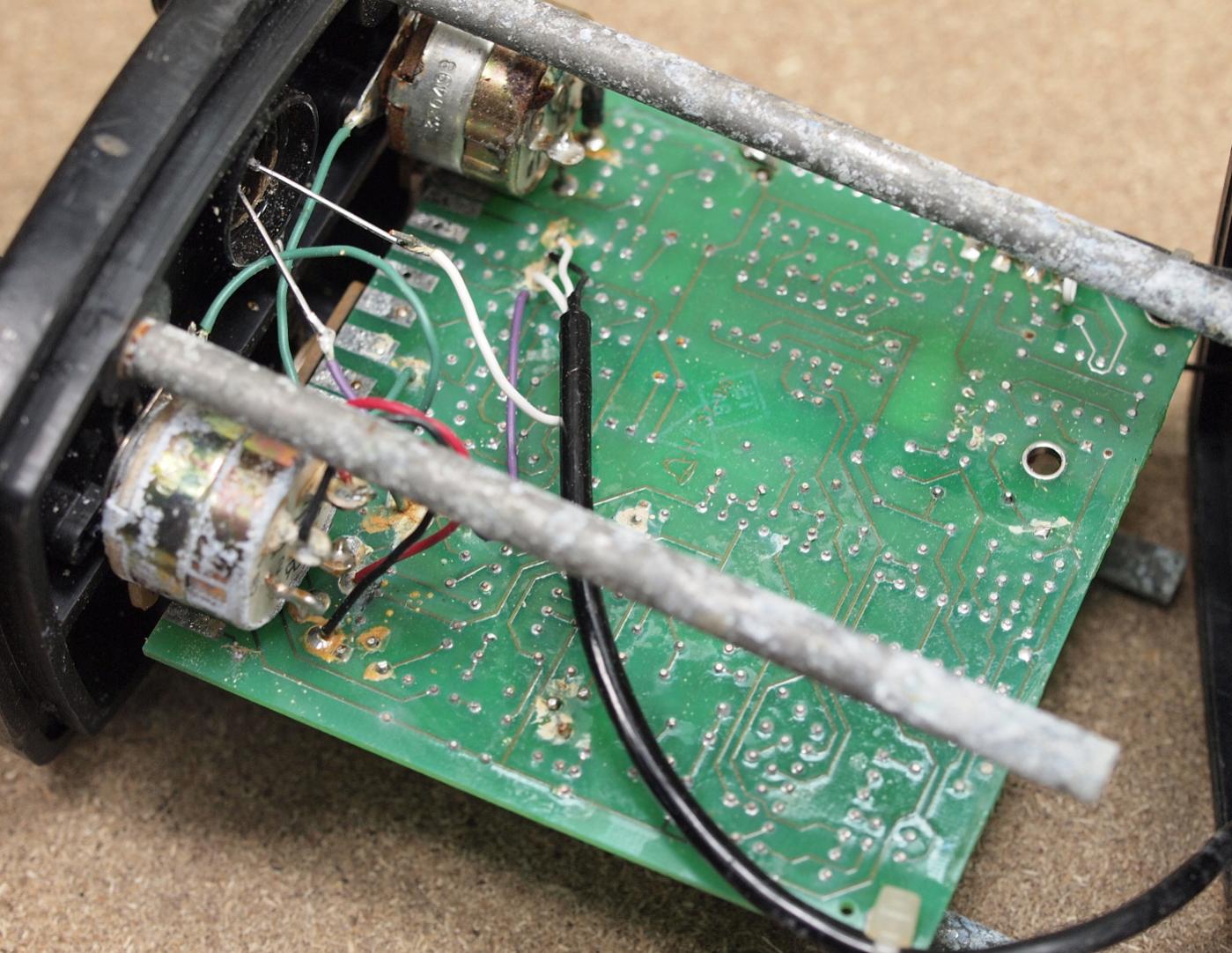

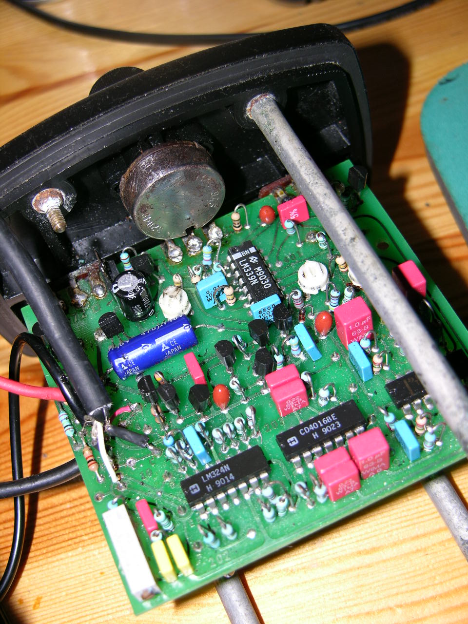

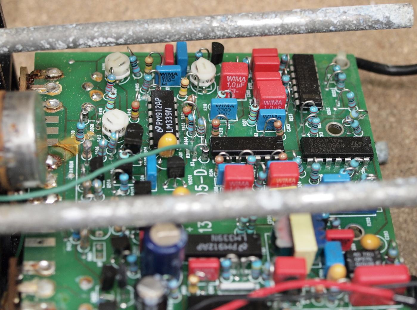

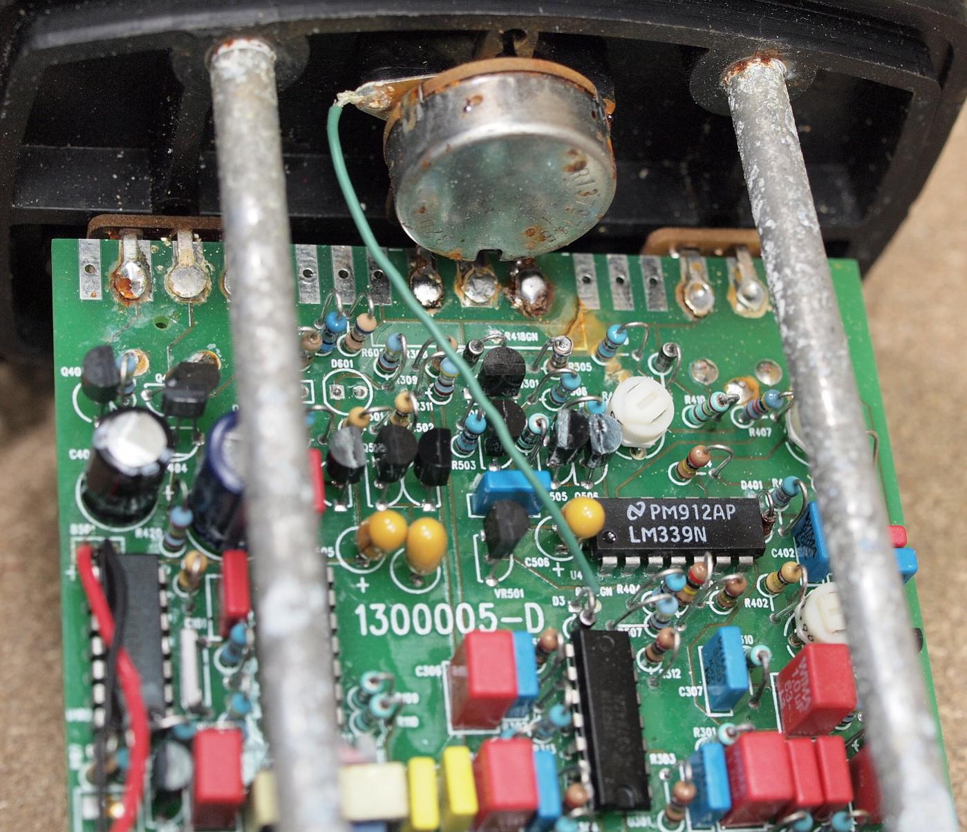

    I need help for a 1280 aquanaut. This one don't emit sound, so i have tried to open it and i pull to much the front panel. Two wire are disconnected, one white and one violet from the board to the led of the front panel.
    But i can't see where they was soldered before. Anyone have an idea ? And so on why there is no sound ? Just before i opened, the led flashing when a metal was under the coil, but with no sound ...
    hi, I did see two variation of PCB in 1280, thru hole and SMD. what your PCB? can you give pics?
      Thanks to answered me, but i can't join (post) picture. I can send one by email. i have seen a number on the board h 43-89.
      Have you one or two pics ?

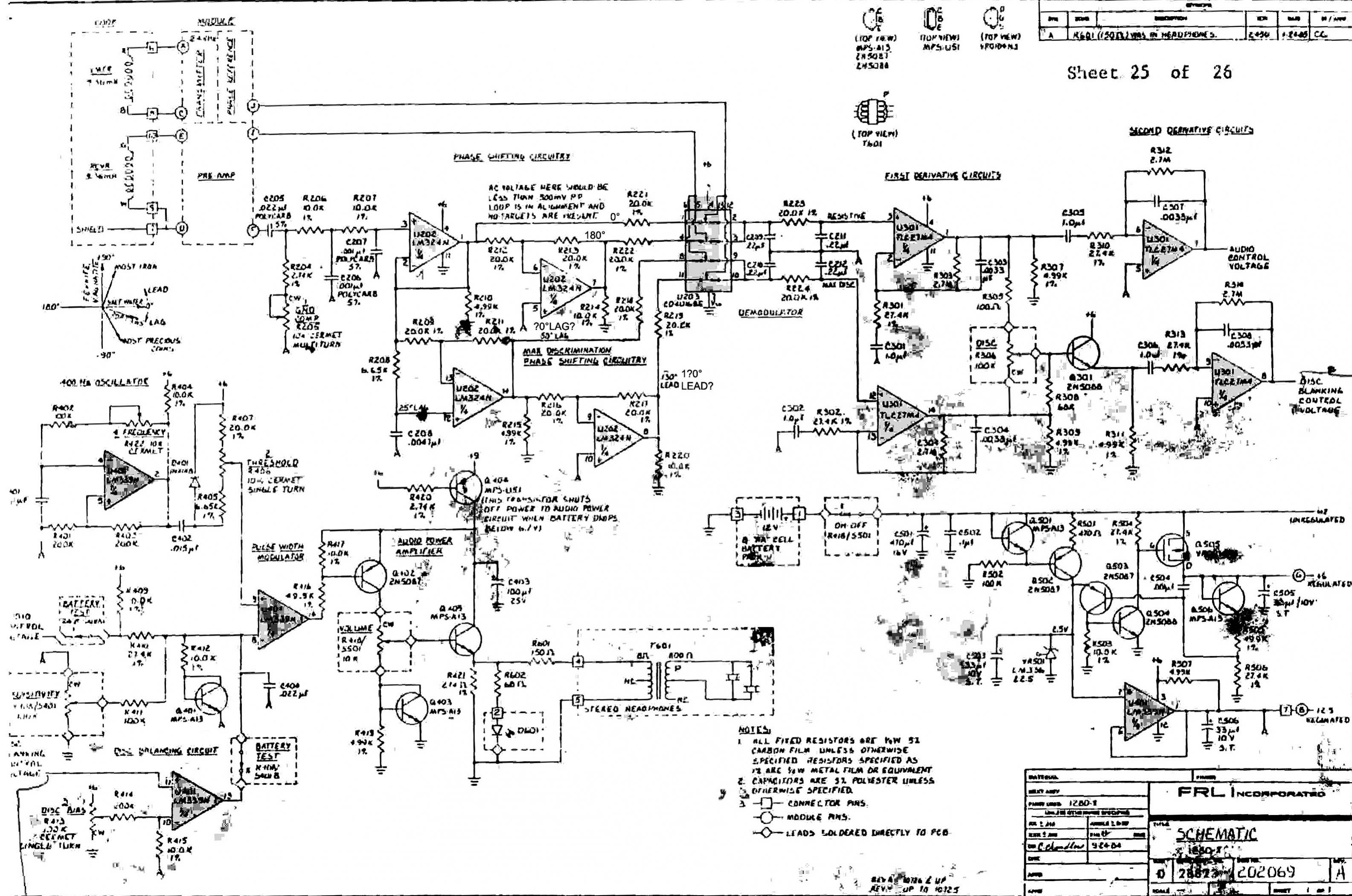

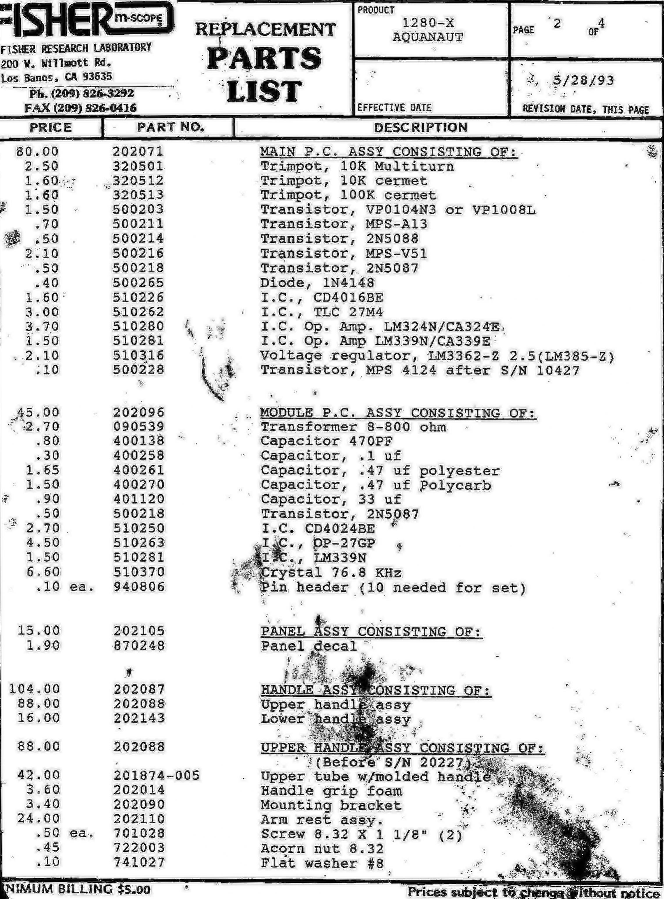

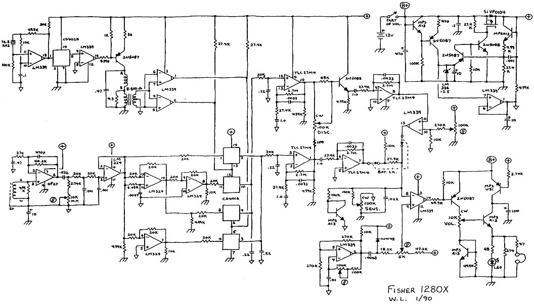

          Thanks guru !

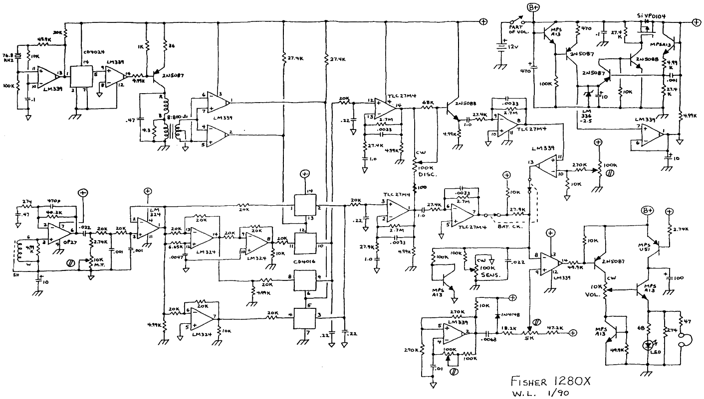

          hum, i suppose the front panel led is connected to the resistor R602 (60 ohm) isn't it ?
ID:	340550Click image for larger version
ID:	340553Click image for larger version
                my email address [email protected]. please in high resolution at sunny day pics, both sides.
                TIA
                  Thank you very much for your help.
                  The front panel led works. The Headset doesn't works. I don't know how to open it...
                  I have tested the the stereo out with a small speaker and it's ok.
                  I think i will change the headset for a wire and 6.35 jack embase.
                    i have only ever seen two of these in the "wild",both had been fitted with headphone sockets.
