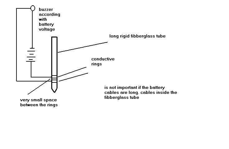

                      Re: How hard would it be to make a detector for mercury in soil?
                      Hi Randy,
                      I'll try the simple answer. Mercury has a conductivity of 1.8, compared to copper at 100 and lead at 8.4. You would need a fairly large glob of it to get a signal on a PI. If the mercury is disseminated as fine droplets in the ground, then you would get no signal, even though the overall ground conductivity may be enhanced a bit. Mercuric oxide, or any mercury salts in the ground would have even less effect.
                      High frequency induction balance detectors, such as the Goldbug 2 can detect materials with far less conductivity than any current PI's, so you may stand a better chance with one of these.
                      I expect there is a simple way of chemically sampling the ground for mercury.
                      Eric.

                          IF THE MERCURY IS LIQUID... HERE THE MOST SIMPLE DETECTOR
