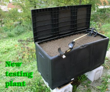

    My first testing plant was someway limited, regarding coil sweeping space over it, which can lead, by given GEB sensitive detectors, to some unwanted instability:
    With new testing plant, I overcome those coil sweeping limitations:

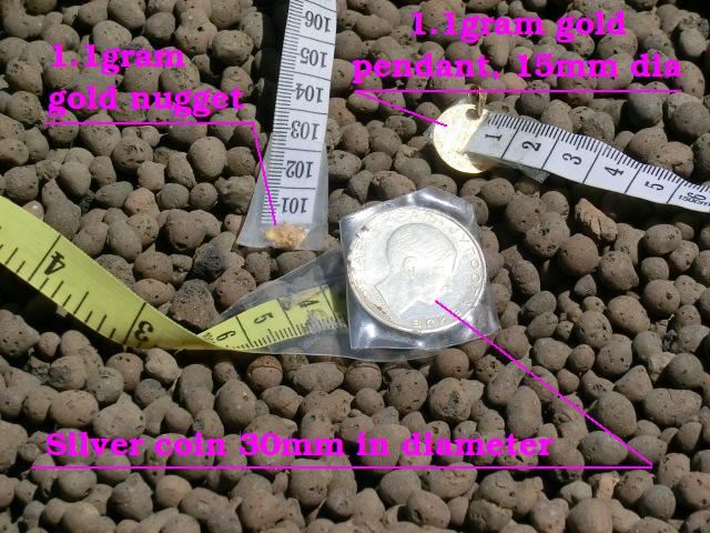

    Testing targets are fixed to the end of tailor meters and can be easily immersed by hand in testing substrate and then slowly pulled out, till clear detecting in both coil sweeping directions:
    My standard testing samples are:
    - 1.1gram genuine gold nugget
    - 1.1gram gold pendant 15mm of diameter
    - silver coin 30mm in diameter
