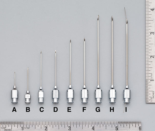

    A call for everyone.
    I would like to have information about detecting from hypodermic needles.
    Are there people who can give me detection results from metal detectors (VLF) from hypodermic needles?
    -Information of the MD.
    -Information of the coil.
    -Information of hypodermic needles.
    -Information of the distance of the detection.
    I would like to ask you to want to do an investigation/pilot.
    With your MD doing a AIRTEST. Preferably with the illustrated hypodermic needles in the picture.
    thanks in advance,
    nupi.
    Drug needles are hard to detect because of the metal they are made of, at least here in Oz.
      304 Stainless ?
        @6666: @greylourie:
        Needles are everywhere hard to detect because of the metal they are made of, stainless steel
        In general, stainless steel is used, 304 & 306. Type 304 alloys are all modications of the 18% chromium, 8% nickel austenitic alloy.
        Type 316 is an austenitic chromium-nickel stainless and heat-resisting steel with superior corrosion resistance. There are also other alloys used. Some needles have a coating.
        Special types of needles, one applies an alloy from about 70% platinum and iridium 30%. Such needles are very strong and hard.
        They are also very sharp grinding, so you barely feel the prick.

            hypodermic needles = Open ended with no clarification...
            They come in all sizes from the small ones used for insulin / abuse of drugs etc and up to a size that you would faint when you saw it coming at you.... approx 4mm dia and that is a big fella Then the issues is where are they going to be and how long in the wild ?
            Also the older style ones used in many 3rd world places (can be cleaned and re used) have a lump of metal on them and on my tests here.. Detection is not a problem..
            So before any one can give you real answers, you need to provide more info...
            As to where the ones your are looking at will be located and at what stage...
            A: In the park / beach / Waterway etc...
            Different detectors and setups for each occasion and while a machine may pick up some on one site they may not at another..
