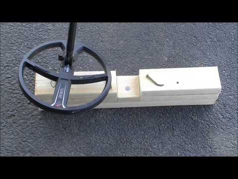

    Here is example how test perform:

        Perlite is something different. This is Liapor (made out of clay):
        http://www.geotech1.com/forums/showthread.php?21590-TEST-Tesoro-EURO-Sabre-II

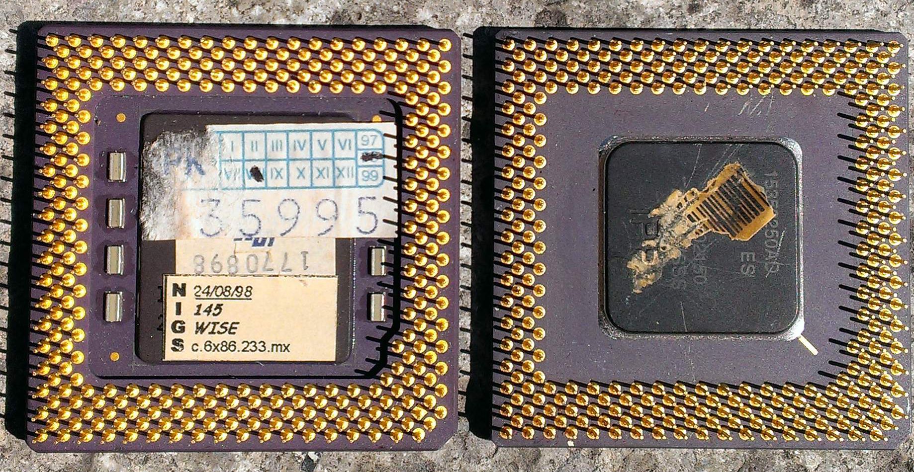

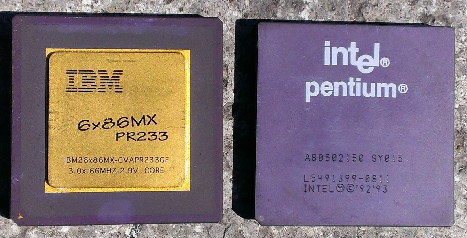

          I am having those two.
          IBM one is gold plated.
              Oooops he did it again!?
              :rotfl

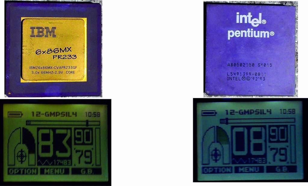

                I just performed skim and simple air test with those two Pentium processors.
                Results were more than surprising for me!?!?!?!?
                Ok... now we have TWO target references
                  This is a fake one.
                    Originally posted by Nupi View Post
                    This is a fake one.
                    I assume it's the genuine one too but not gold plated as IBM.
                    Anyway, considering that it is easy to obtain it worldwide; it also can be used as target reference.
                    As far as we are aware of it's magnetic and conductive features.
                    That's why is good to have metal detector with accurate VDI.
                    Luckily most of modern detectors do have VDI feature.
                    Those two processors used as target references can also show us differences in VDI's at different md models.
                    Ain't those indeed easy obtainable and cute targets
