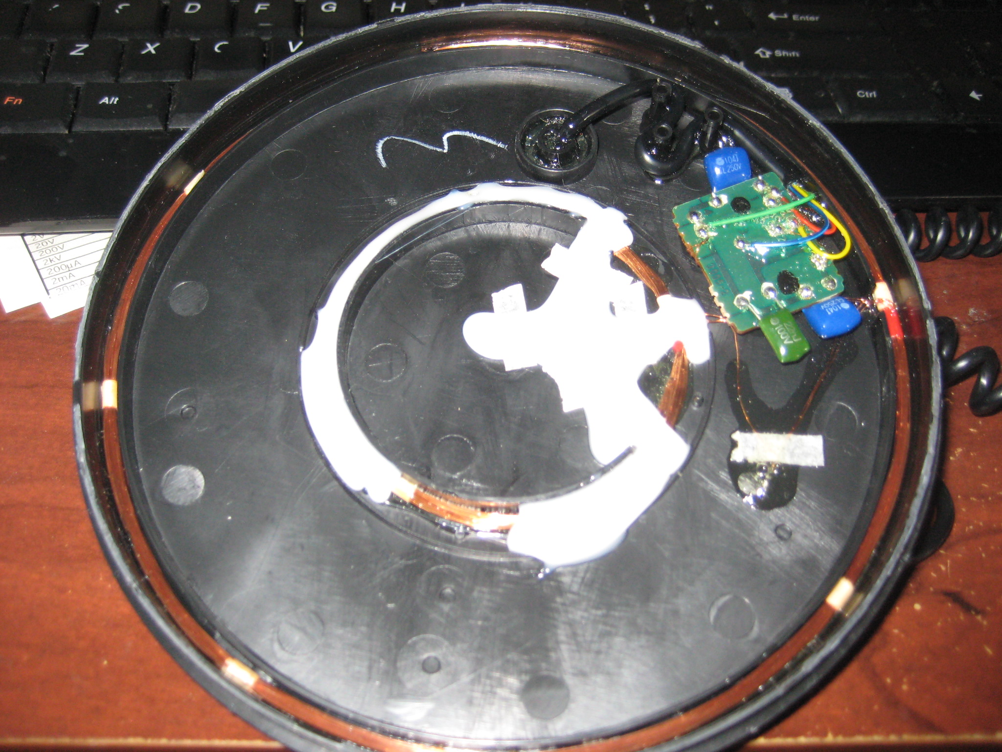

      i have the micronta radioshack 4003 metal detector cable coil brocken i just need informations about coil type and values if its possible or using other big small coils
      its may be stupid but just wanted it alive
        This was a RS coil but the readings were funny. I never really figured out how it was configured.
        It came off a 3005. I gutted it and am winding Tesoro windings on it.
        I had another RS coil but I can't find the picture just now.
        This one seemed to have 1.6mh on TX and RX but maybe centertapped and there was 3 caps
        2 were .1uf and one was .22? Not sure maybe you can see in the picture...
