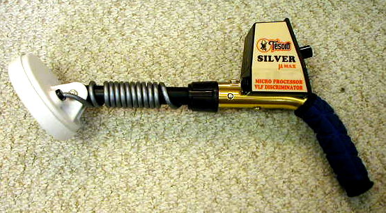

    Would it be feasible to make a pinpointer with discrimination/ID?
    When I take my XLT to grass parks it finds targets in the first few feet. Maybe it is just my beginner level of experience with this detector but it drives me nuts to dig pennies or pulltabs 80% of the time. After finding a target I take my minelab pinpointer and localize the target. Problem is that it can then still be 3" or more deep. Would it be feasible to make a pinpointer that has id function so i wouldn't dig the lesser value targets?

          The idea is your XLT tells you what's down there before you even get the pinpointer out
          so the PP only needs to help you find that nugget. Most PP's are some kind of all metal
          or PI type detector. It would be tricky making a VLF coil small enough to pinpoint with
          and still discriminate. The Mini above is as close as you can get...

              bounty hunter 4 in my plan. small, compact, effective. smooth fast disc. but in SMD that is not so acceptable for majority of geotechers.
                Yes, the White's TRX pinpointer was designed to add target ID. It has space for a wireless module and the intent was to wirelessly connect to the detector and show live results to the screen and live audio to wireless headphones. However, I doubt it will ever happen.
