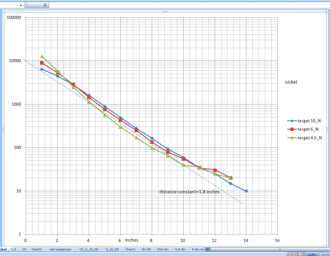

            I've plotted some signal strength vs distance curves in the past. The data plots similar to time constant curves, The amplitude drops 63 percent every (X) distance. A 5 inch coil I plotted dropped 63 percent every 1.2 inches. A 9.5 inch coil every 1.7 inches. Including a plot with a nickel for the target with the coil shaped round and rectangular. The amplitude should drop the coil distance constant every target time constant. A nickel with a 10 usec time constant would loose 1.8 inches for every 10 usec increase in delay for the plotted curves. The curves aren't quite straight but I think it should give an idea what to expect. Some target time constant curves aren't straight, probably have to use time constant to match the delay time. Maybe makes sense maybe not, its what I'm thinking.
