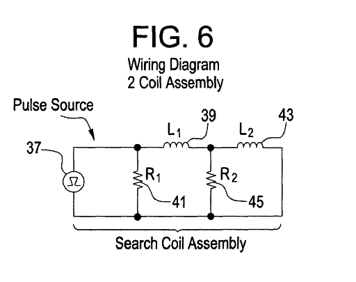

    im using 24 awg 18 strand wire and ive cut it too short length...is it ok to re join the wire with a solder joint...will it detect the solder joint...also is graphite shielding better than scotch 24 screening tape ???
    Umm what kind of coil are you making? I have "stretched" my coil wires by soldering
    on a bit more but they have been for VLF only. On a PI you generally don't want solder
    in the coil especially if you went to the trouble of using Litz wire. Could it work with the
    shorter wire? What indctance did you want and do you have now?
      i was making a coil but the inductance was only 140 uH as i cut the wire too short so i decided to scrap the coil shell and make another dual field coil using the same wire but because dual field coil was smaller than the coil i scraped the inductance was higher...but then the problem was making the small inner coil as i didnt have enough wire in one continuous length...so i need to solder two pieces tog ether to match the same amount of turns for both coils !!!
        Well if in doubt work with what you have. Just try to use the minimum solder possible.
        If you look at commercial coils they use pcb boards, relays, caps and resistors in them.
        If might not be the perfect coil but will most likely work just fine!
          ok thanks

            Also a dual field would require some damping resistors in the coil shell so a splice
            in the wire wouldn't be a big deal.
              ive already made a dual field coil some time ago....using a whites 12" coil cover housing.....great for pinpointing !!!! i use scotch 24 shielding but i was thinking of using graphite paint this time but not sure which is best to use !!!! no splice needed as you wind both coils separate.
                The original Dual coil used a resistor after the first coil so would need to be in the housing
                unless your running 4 wires back and making the connections in the PCB box.

                  i put the resistor in the housing but maybe better using four core cable so resistor in control box so can be changed easy or for experimenting...i could use less turns on the smaller coil and not solder but i thought large and small coil had to have the same ratio of turns...maybe i will ask about it on the forum.
                    Someone once wrote that a damping resistor on each winding is best so
                    a dual adds a damping resistor 1/2 way through the coil. It still acts like a
                    single coil but is better damped and has more magnetic density in the center
                    (of a large coil). So an 18" with 6" center coil might act like a 12" by the
                    small coil filling in the field...
                    The damping resistor is fixed once the resonant freq is determined so
                    seems it would be better inside the housing (but hidden by ferrite?)..

                        I'm not sure how to accuratly tune the inner coil damping resistor.
                        You can use a PI machine with coil to broadcast to a new coil that
                        is not connected to a MD to see the resonant frequency.
                        PI coils are somewhat like an FM antenna. Any old piece of wire will work
                        though a proper antenna uses 1/4 wave and a ground plane etc.
                        So even with a splice and nonoptimized damping as long as your finding
                        good stuff it doesn't matter...
