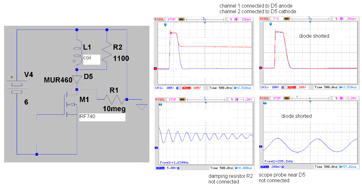

            Could you please show a simple schematic of what you suggested? Thanks!
              Some real scope pictures of coil turn off. With no diode the circuit resonance drops from 1.64 Mhz to 395 Khz. Would need a lower value damping resistor, longer delay before first sample. Depending on the targets maybe not a problem.
                That is a very instructional picture. Thanks!
                I now appears that the only real negative for n-channel MOSFETs is what kt315 mentioned about the ability to ground the shield. Am I correct?
                  Thank you for sharing this it is a great demonstration and very informative.

                      I referred to a latest delta pulse implementation, but green stripped the unnecessary parts and provided some perfect scope diagrams. You may also see that there is no extra voltage in a flyback, but obviously the coil becomes faster.
                      Fun part is that most amateur builds may benefit from this simple add-on, and it is less expensive than peanuts.
                            you forgot inner capacitance of a o-scope probe influence. connect it AT THE COIL DIRECTLY and you will get something another.
                                The scope probes are connected to the coil and IRF740 drain for the decay pictures, but not the resonance pictures. The decay curve with the diode shorted looks like it takes an extra 250 nsec to decay. With the change in R damping that's required to prevent oscillation the delay period before the first sample might have to increase by 3 times. With 100 volts/division it's hard to see when the coil has damped close to zero volts. It's more than the 1.5 usec from the trace.
