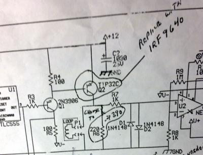

    Can I replace IRF740 with IRF610 for surf pi detector ?
    I don't know how much volts and amps is needed for detector to work.
    Thank you.

            Surf PI uses a P-Channel Mosfet, N-Channel Mosfets won't work.
            If you want to play with N-Channel Mosfets, you would be better of building a HH or Minipulse.
              Oh ya we are using 9640 for surf;
                Oops, yep, brain wasn't fully engaged on that one. You need a PMOS.
